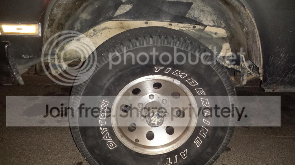

Converted to 6 lug :(

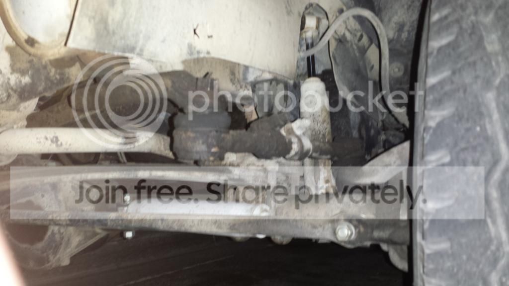

Whole front steering system needs to be rebuilt.
Rag joint needs to be replaced.
My guess is the Blazer was getting a 3/4 ton swap, and your Suburban was the donor vehicle.
What don't you like about the trim? Looks clean enough.

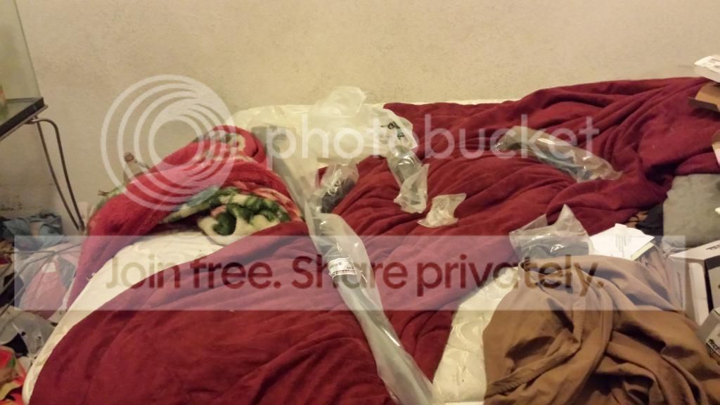

Got most of the parts to rebuild the steering: Center Link, drag link, inner and outer tie rods, adjusting sleeves. Just waiting for steering box,pitman arm, rag joint, and steering arm. Got everything? Also do our trucks have a idler arm? Couldn't find one when I looked under the truck.

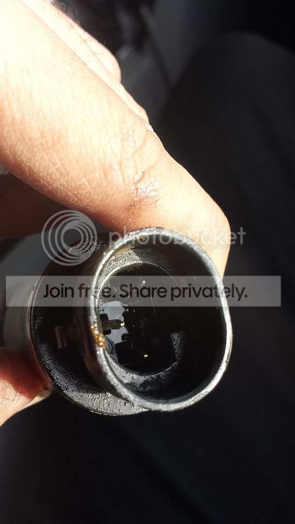

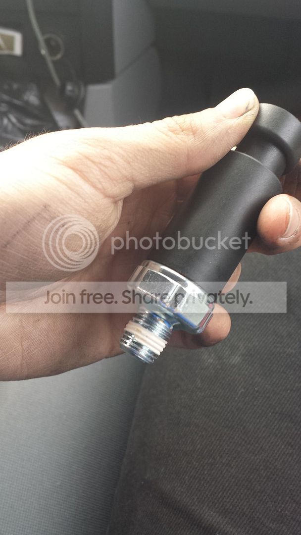

I found the problem. It's the oil pressure switch. I unplugged it and there's a crap ton of oil in the oil pressure switch connector and in the oil switch itself. I unplugged it and the fuel pump turned on, started the truck, and it starts up then dies. My dumb ass tried plugging it back in without cleaning it and there was **** ton of smoke. I hope I didn't fry the connector. I might just buy another connector and try splicing it in.

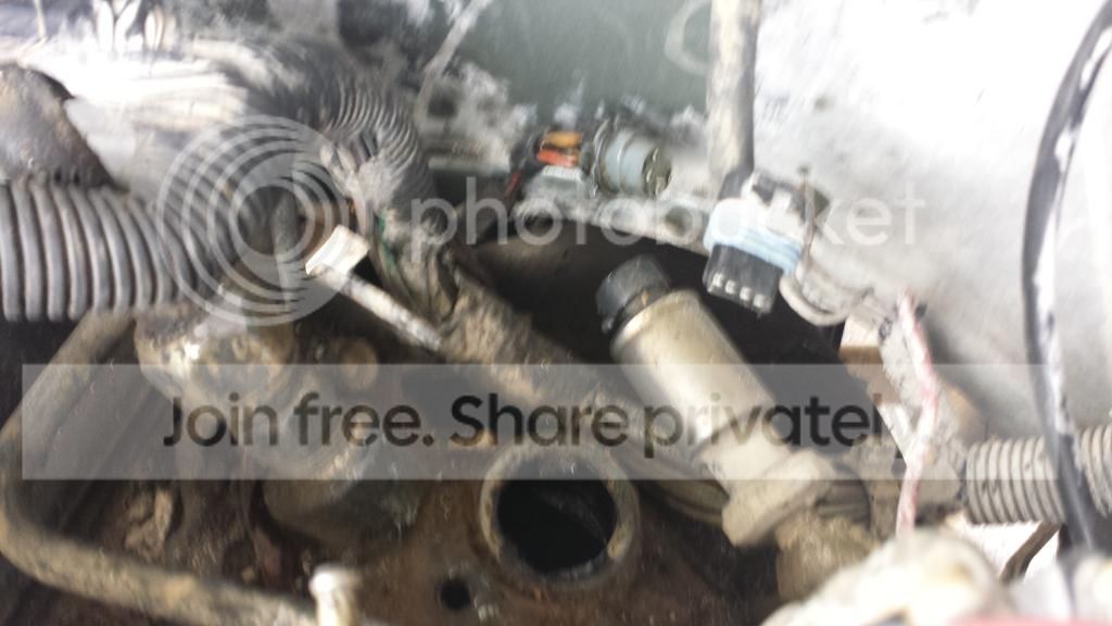

Finally got to the oil pressure switch. Removed the spark plugs, distributor cap/distributor.
Old oil pressure switch, notice all the oil and debris in the socket?
Here's the new one.
Started the truck, oil pressure stays steady now. But now it idles rough and stalls if I don't give it gas. Drove it and it hesitates and doesn't go above 10mph until it's in 2nd gear. Before the pressure switch went out on Thursday night it was idling and running fine l. I thought it was the injectors and rebuilt the tbi in the parking lot. It could be a few things: fuel pressure regulator, clogged fuel filter, Idle air control valve, or TPS. I'm leaning towards a clogged fuel filter cause it looks like it hasn't been changed in years.
You also pulled the distributor, could be timing issue.
Before I even pulled it to change the oil switch. I started it with the switch unplugged and it was doing the same thing. I can drive it but it hesitates to get up and go after 5 seconds it has power again.
