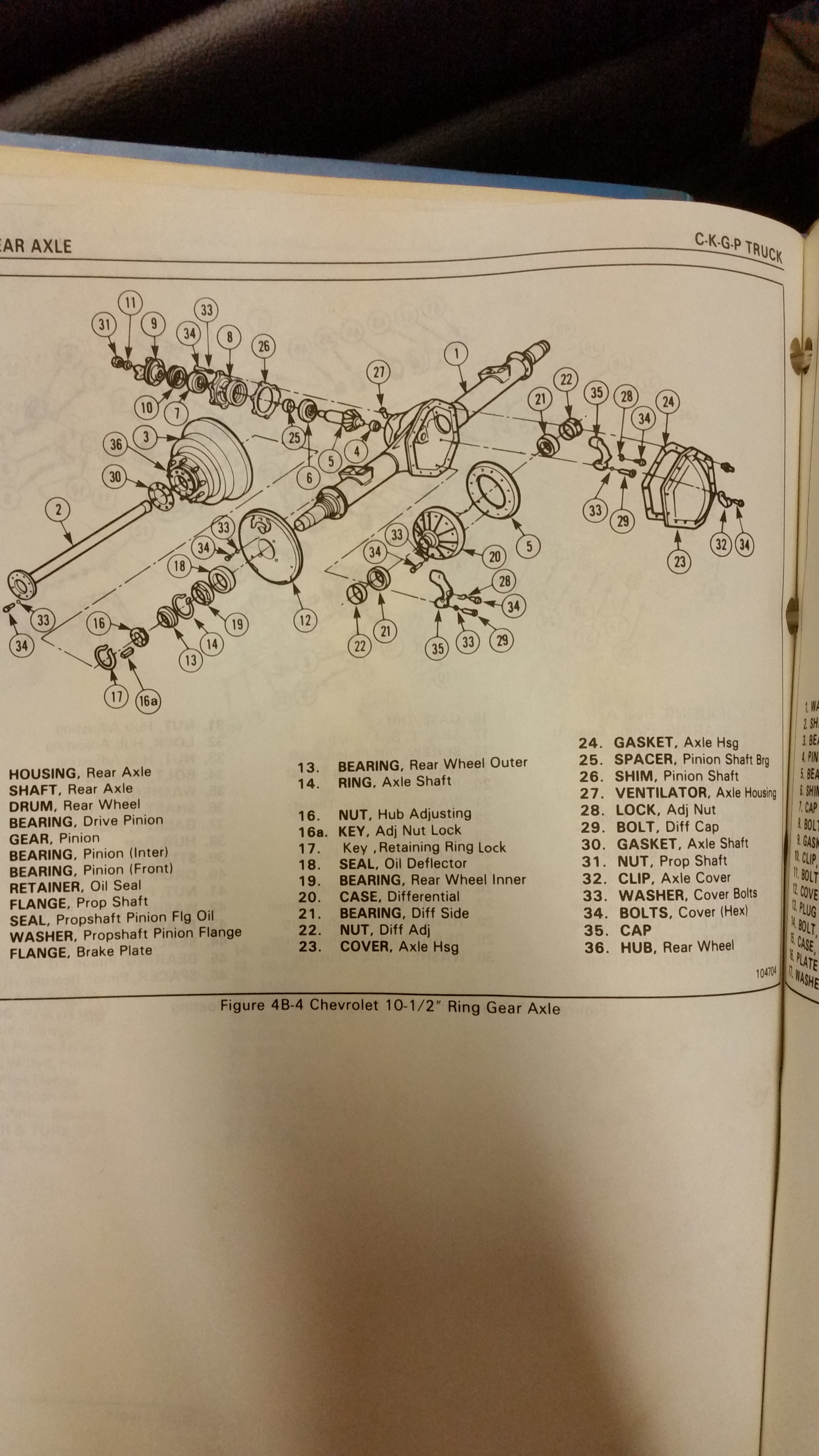

I have a 1985 LIGHT DUTY TRUCK C-K-G-P SERIES SERVICE MANUAL .
I have had it for years but today I took a closer look at the rear axle section.
full
There is:
Chevrolet 8-1/2" and 9-1/2" Ring Gear

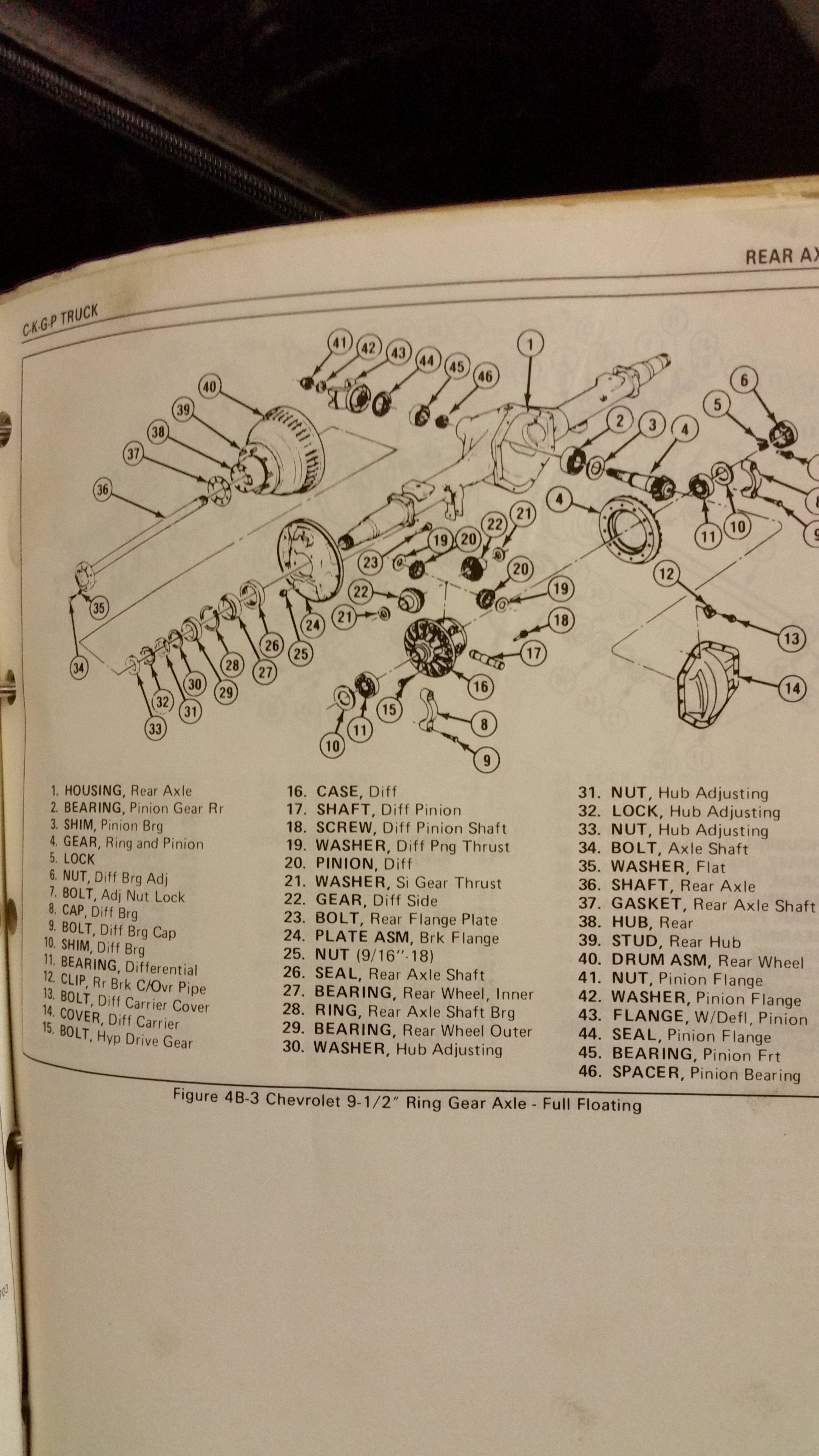

Chevrolet 9-1/2" Ring Gear - Full Floating ?????
Chevrolet 10-1/2 Ring Gear
Dana 10-1/2" Ring Gear
Dana 9-3/4" Ring Gear
Rockwell 12" Ring Gear
There are exploded view pictures of all above.
full
full
full

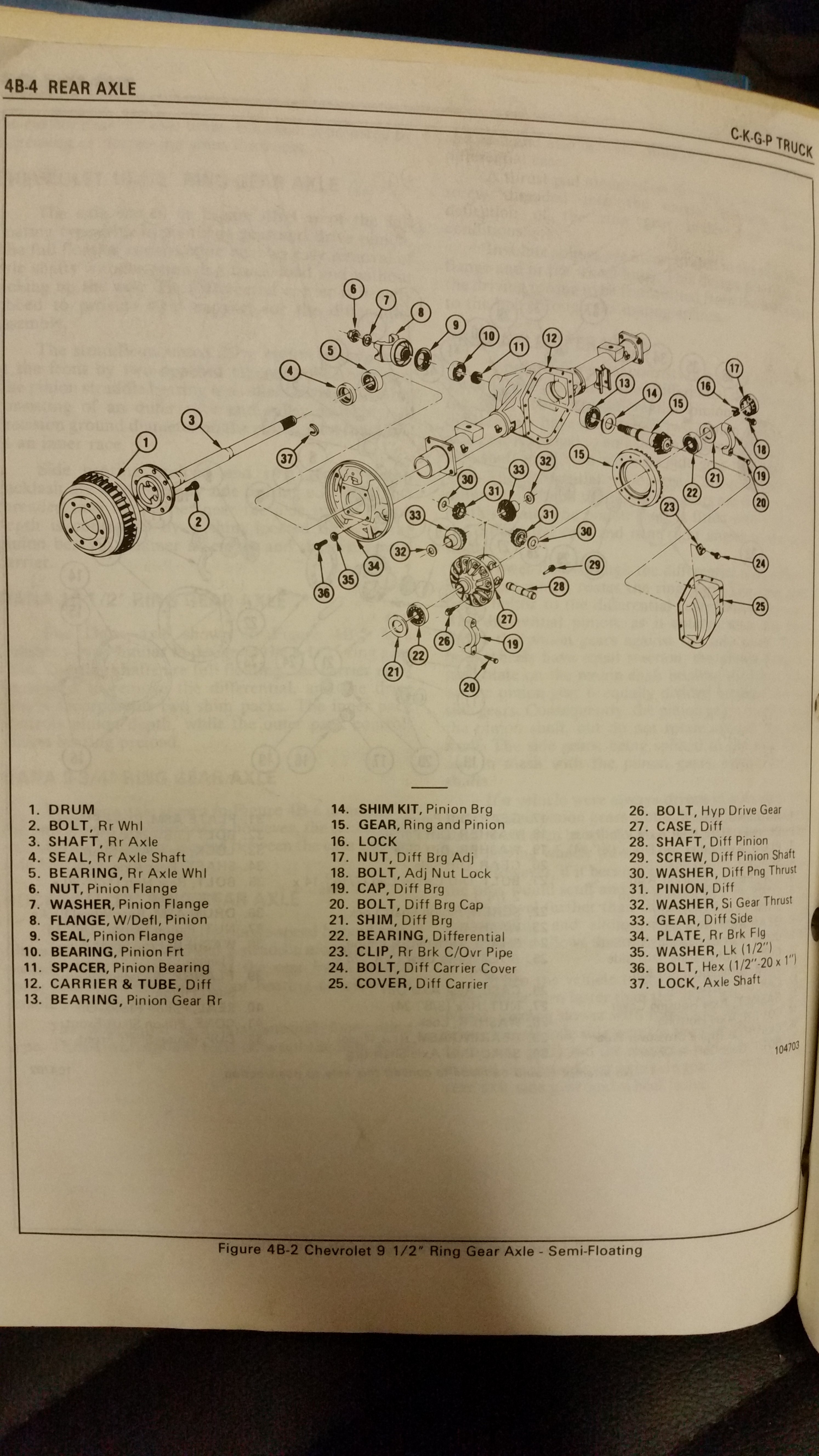

The picture of the 9-1/2" Full Floater shows a differential identical to the 9-1/2" Semi Floater,
but the hubs are fully floating.
Have you ever seen an axle like this?

I think miss print . that's a dana 70 rear from pickups with drw and pickup box with the ext fenders to cover the tires .
I've never seen a 9.5" full floater. The other funny part is all three diagrams show the same 14 bolt cover...the big full float version. The SF 14 cover is a big oval cover like a 10 bolt cover but with more bolt holes.
?... or maybe an import axle seeing your in Finland.
I'd bet it's a non U.S. axle. When I worked in Toyota parts we would occaisionally see odd stuff that we couldn't get from other countries (mostly South America calls).
