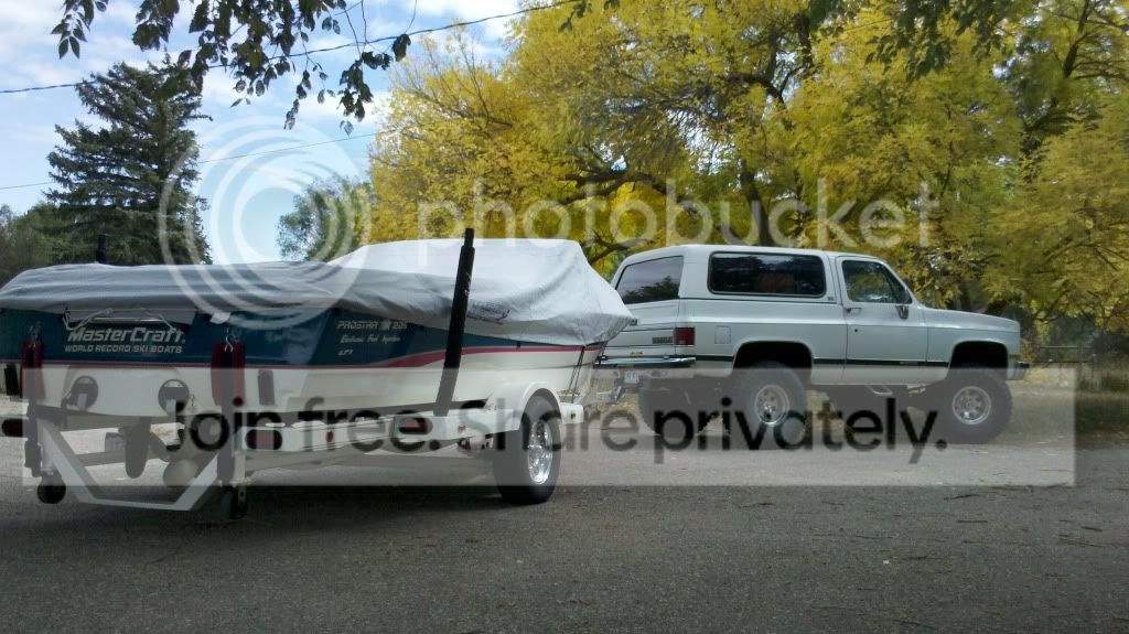

Okay, got this really nice K-5. It has a 4" lift with 305/70/16's. They appear small, but I don't want to change the gearing. Just put some new bilsteins all the way around. It drives okay around town, but on the highway it has a really bad roll back and forth with bumps that are not 90 degrees to my path. I think it's dangerous actually. I tow my 21' boat and the springs don't sag at all. Not a lot of tongue weight.
So, with small tires, big lift, what are my options? I'm considering respringing the back and or the front also. The problem appears to be coming from the back, not the front. Also considering a little taller tire for looks only (I know it raises it even more). I'm also considering lowering it one inch with all new springs. I like the height but don't mind going down a little.
My question is this. Do you think this rocking and rolling is normal regardless of the springs, because of the height and small tires or will it be fixed with new springs?
I only drive this thing back and forth to the Colorado River with light off roading. Less than 5k per year on the miles. Functionally it's the perfect vehichle. I really want it to drive good. If I can't solve the issue, I would have to get something like a Tahoe or Suburban, which I really don't want to.:D
BTW, the back springs are probably stock, as there are blocks back there. The front was re sprung with the lift prior to my purchase.

boat and trailer under 3k. tongue weight about 100#s. like I said, the issue is driving without the boat at highway speeds.

that's interesting info on the trailer. wouldn't that tongue weight vary with the placement of the axles, dual or single? Or should they be placed where they need to to get the tongue at 10%. There's 505#'s hanging 18" off the back, so the tongue is probably a little light. It actually tows okay.

Also sounds like too little tongue weight. I'd say that big ass outboard might actually be lifting the back of the blazer up some during the "bouncing".

A few things to try: increase tire pressure and mess with the hitch height. It looks to be pretty parallel right now. Try dropping the ball an inch or so and see how it behaves. That can make a difference if you have too much or too little of tongue weight.
