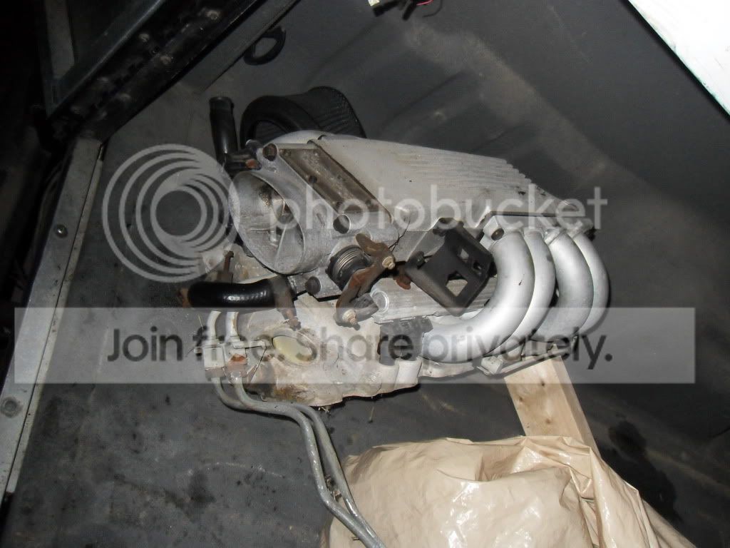

Then a buddy of mine was restoring (haha, really?) his blazer and bought a parts blazer for the extra parts (duh) and mainly the transmission. I went to go look at it and it was a CLEAN truck. Very little rust, pretty straight forward (the PO rolled it on its side but fixed the damage (properly), It just needs some quarter panel work and some roof work and that's it. So....what did I do, buy it for an amazing deal (200 bones + a cheapo muzzle-loader). He gave me the 305 block that came out of it, a set of std 350 heads, a 307 (almost complete) motor, and two TPI setups (Old and new style).

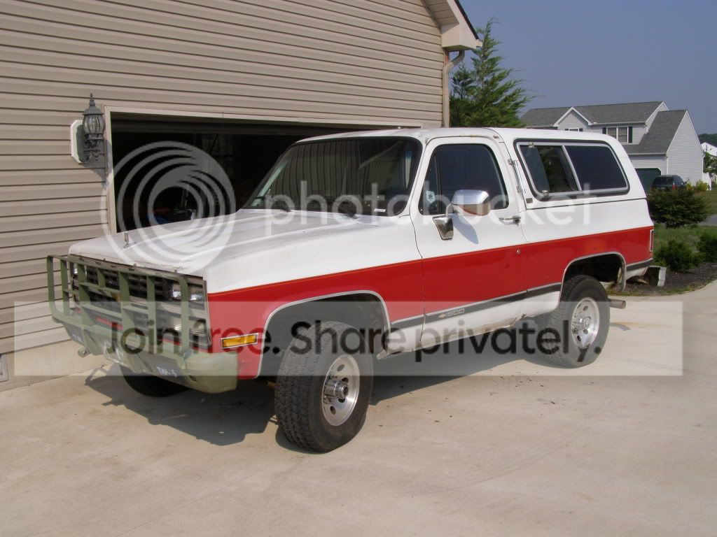

The 90 Blazer:
Here it is currently.lol
It started off as a EMS truck in NYC and had a pretty hard life, the PO took care of the mechanical work but the rest (of course out of his control) turned to RUST.
The newly acquired blazer is a 1986 with 136k on the clock.
VERY little rust, compared to the 90.

Now I do have a few questions, I havent been in the Blazer field for a few years and my mind is getting fuzzy. I am wondering how I can swap this TPI over. I have ALL of the wiring harness that has to do with the TPI system, the system that takes the new style heads. I know the bulkhead connector is the same (correct me if im wrong). Will I run into tranny issues, cluster issues, starting issues? Help me out!

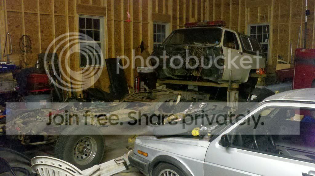

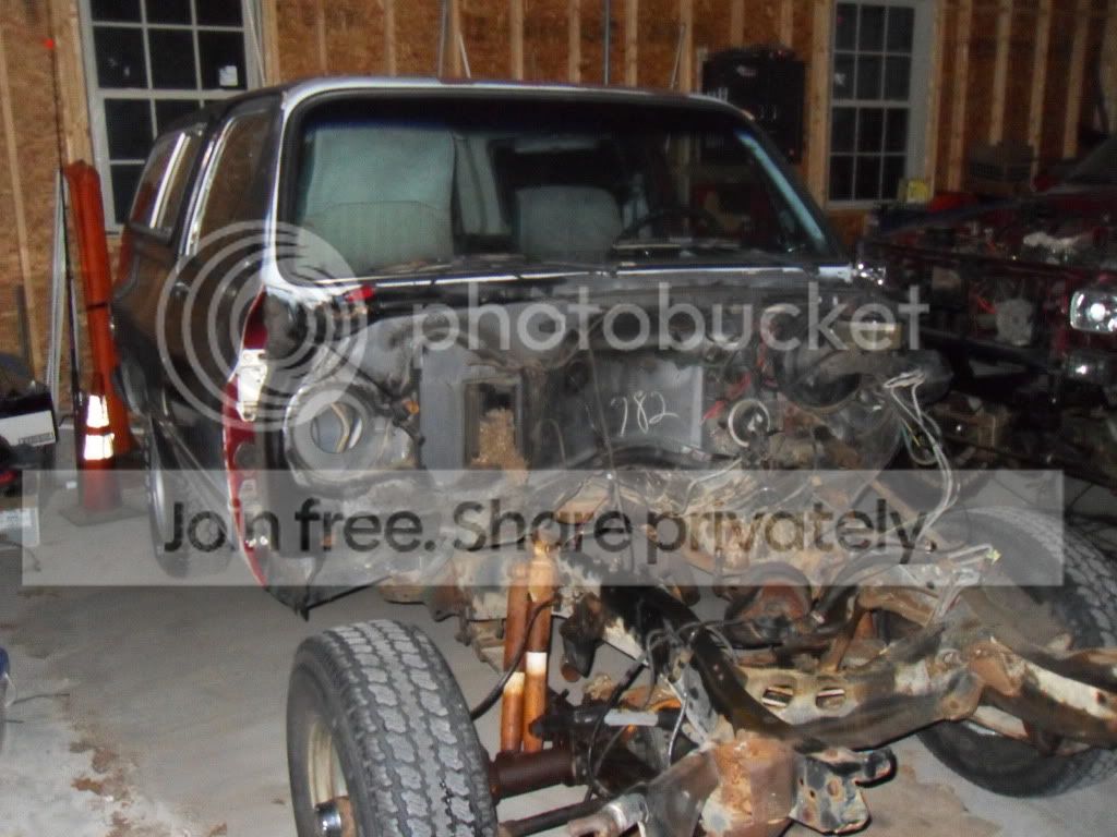

Here is the 90 back in april getting ready to leave, as you can see not much left

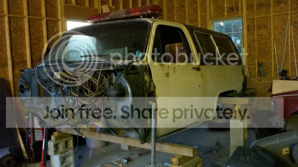

and here it is with no axles, no windsheild and the body hasnt been cut up yet...
That was 5-6 months ago...

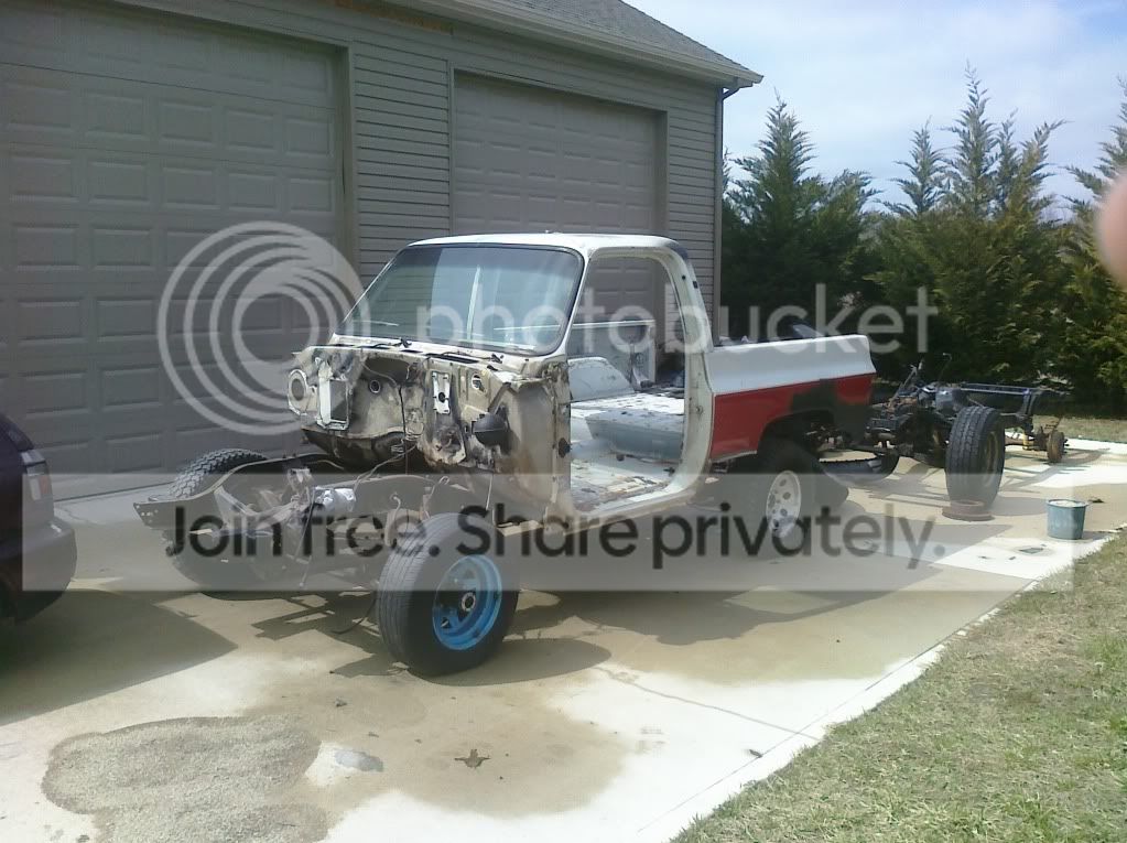

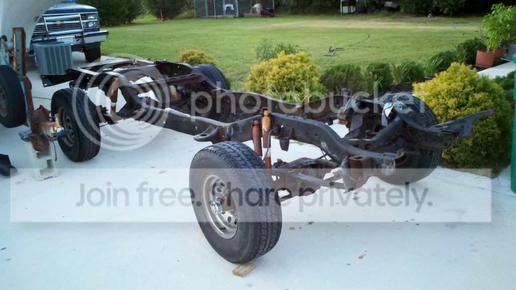

removed all of the brake lines, fuel lines.....everything. All that is left is the axles, then she goes for sand blasting.
btw there is the burban the axles are coming off of.

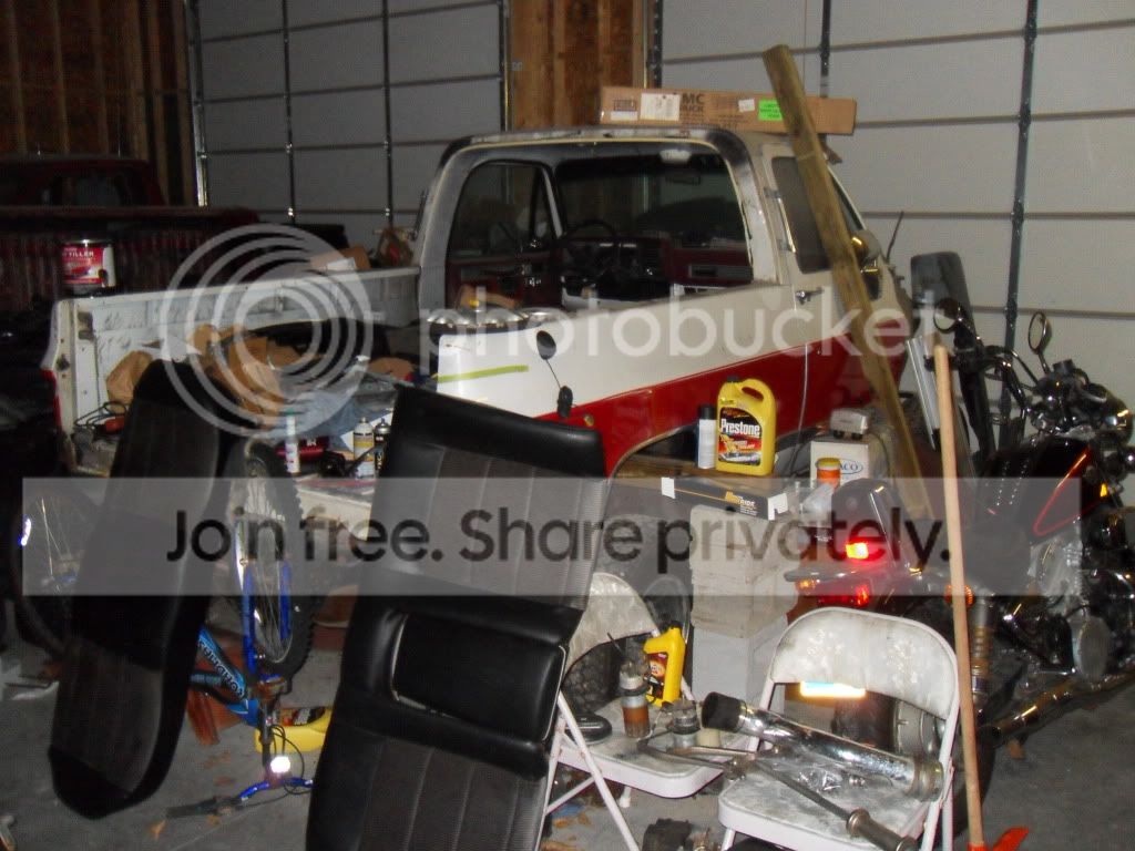

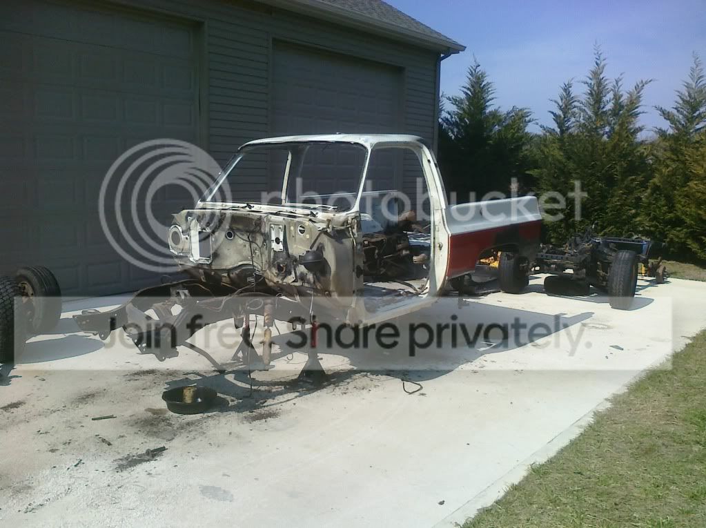

and this is how the cab sits now
So my plan now is to rebuild both axles, install new suspension/steering components, and add a locker the rear. Now the gears im thinking of are 4.56s, im thinking that is going to be OK (running 35s and the 4l60 (700r4) from the 90). So far I have a list of at least 3500$ JUST on the frame/axle stuff (tell me im crazy).

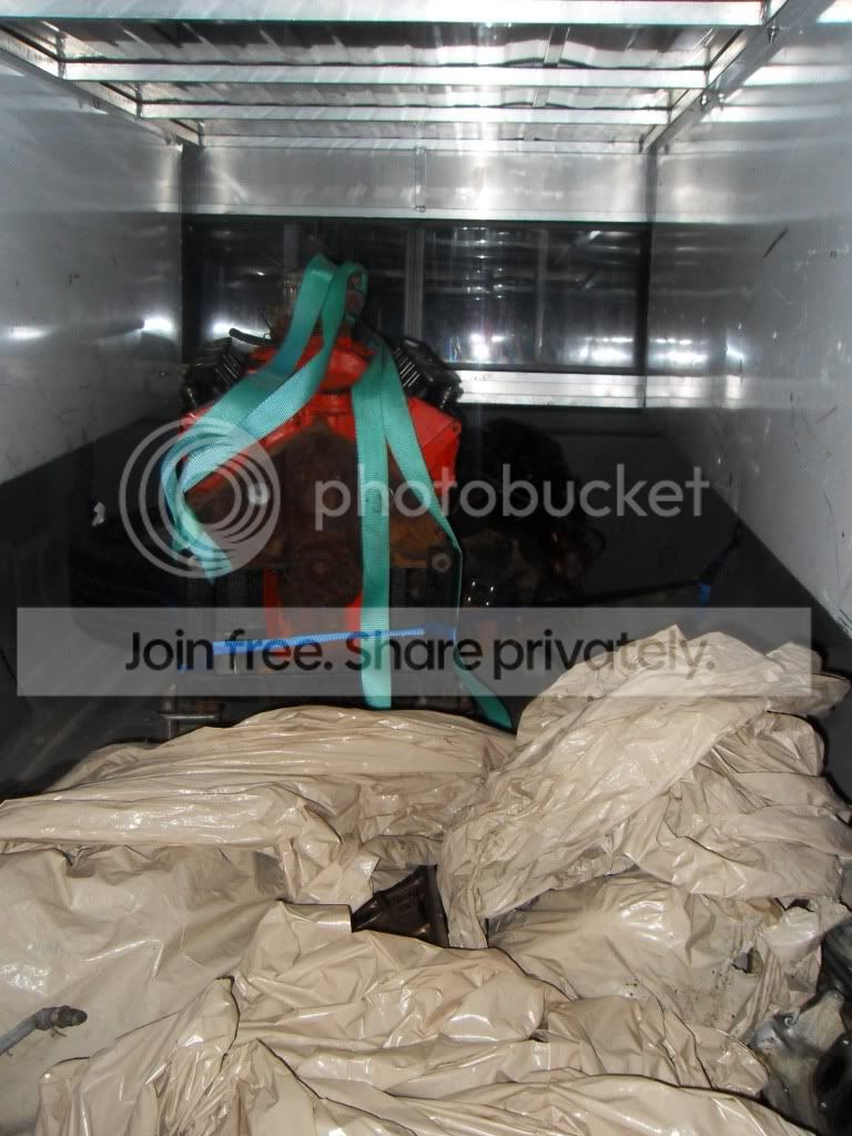

BUT the other day I hit a huge wall. Remember that 350 i was going to use out of the 90? Yea....its sitting outside awaiting it ride to he!!. The person who "rebuilt" this motor was either blind or was 12. When I pulled the oil pan, there was quite a bit of water mixed in the oil. So I started to wonder....I pulled the heads and I found this:
So there was a nice "groove" in the cyl wall. And these have been bored .030" over already, so now there is no chance this block will last if i bring it out to .060", especially if I knew its been through hell.
So there has been a change of plan. Looking for a vortec motor, bottom end and heads. Supposedly that is were the power's at. Now its not on the priority list, so now i can spend time on the frame aspect and not so much the motor yet.
