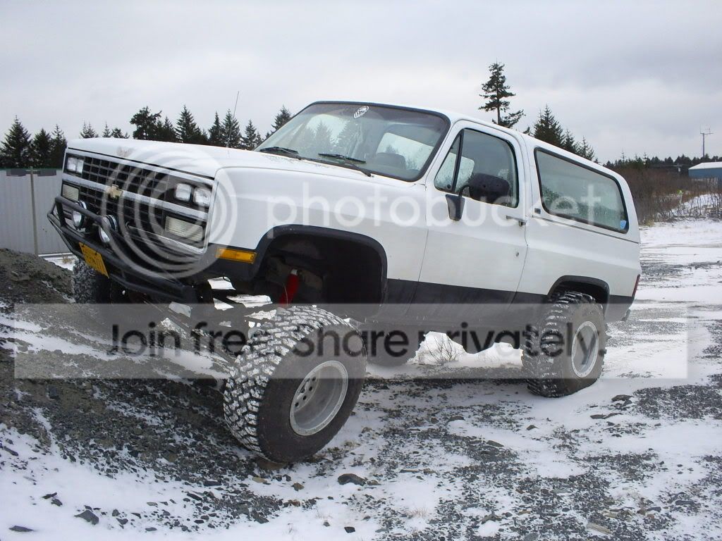

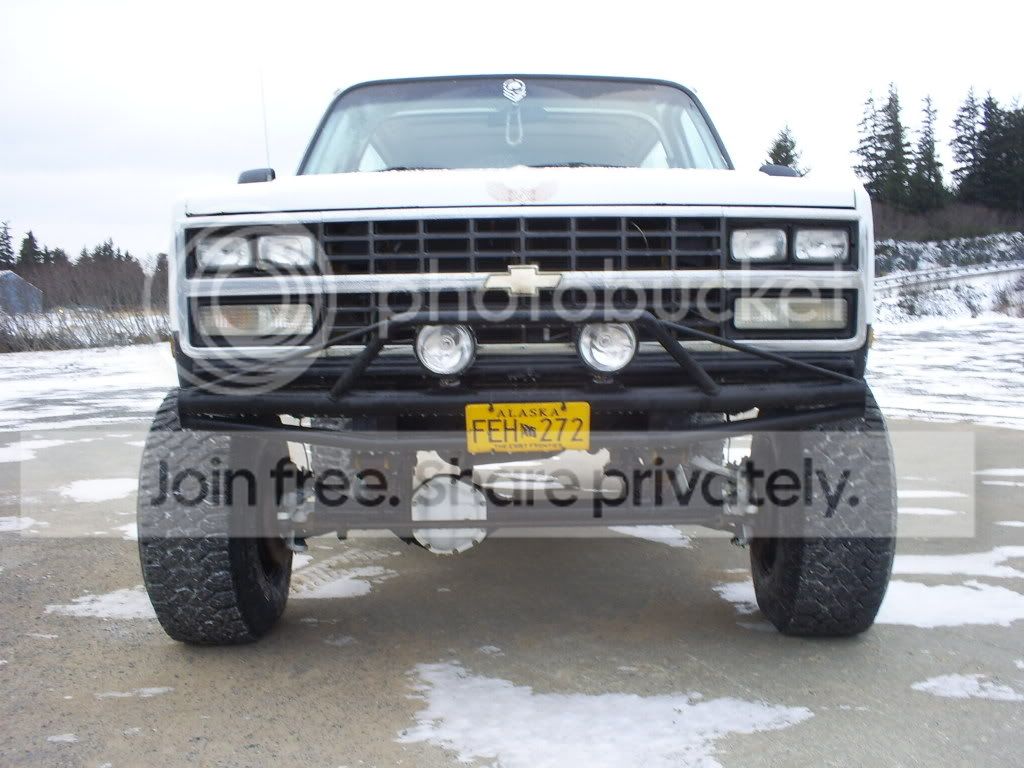

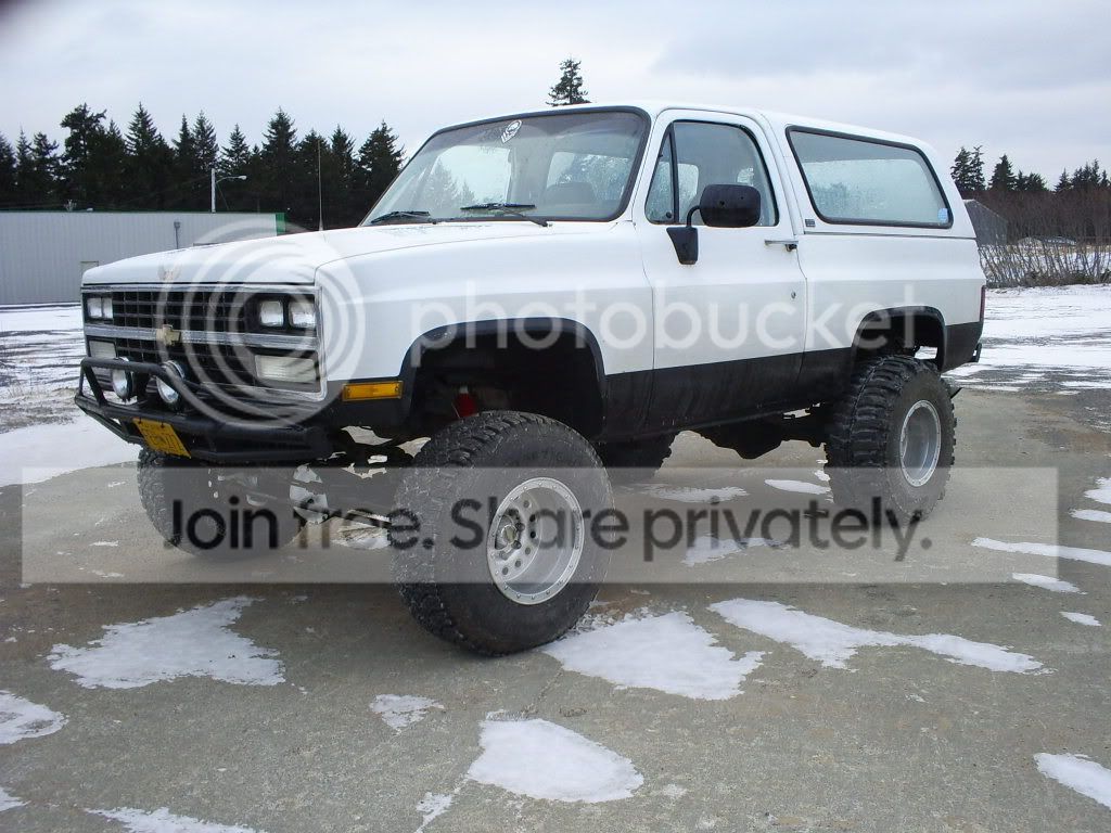

'91 K5 mostly stock TBI 350 (some bolt ons) Flowmaster 3inch exhaust K&N filter some trick TBI upgrades from turbocity.com 700R4 trans six inch springs all the way around 14 BFF rear DANA 44 front with boxed nuckles and shaved diff raised steering arm on axle and drop pitman arm on steering box 4.88 gears and Detroits in both sway bar quik disconnects Stainless braided brake lines (ofcoarse) Rancho 9000 9way adjustable shocks 16.5X12 Weld Stone Crusher wheels 35X14.5X16.5 Boggers (I do have a full set) 35inch TXR fronts gotta run em for drivability in the winter (makes a hell of a difference) custom made pre-runner bumpers front and rear front has daylighters and rear has shackles like a military truck. Rockers and wheel wells have been profesionally sprayed with Road Armor bedliner (a must around here). I have a long travel front drive shaft, double cardenal rear shaft and all the parts for my rear disc conversion sittin in the garage. Let me know what you think of her I sure do love it!! Ya thats ice sickles on the front bumper the water was freezing as soon as I was sprayin the truck off! It was about 15 degrees in these pics!

Ya no prob! On a previous truck I actually snapped the top ear off the axle just inside of the ball joint so i figured on the new axle I would try an beef that area up a little by boxing in the ears to the axle tube. Didnt really know if it would work or if it was even a good idea but I went ahead on er. Well long story short that truck saw more air time than a skateboard at the X-games and never had any issues with bending or breaking those damn ears anymore. This axle I did the same thing but a little more aggresive. As far as shaving the diff I cut all the excess material off the diff top and bottom. I cut a full five eighths of an inch off bellow the diff cover alone! Then I even took the time to clean all the rough casting off of it as well the whole diff ribs and all are as smooth as a babies back side. You can really see the boxing on the axle and even the shaved bottom of the diff in the front on picture. As for the affor mentioned company I know a couple of people that have purchased TBI parts from them and they all have been impressed, money well spent!
