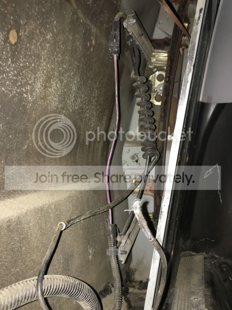

The tailgate window in my Suburban hasn't worked since I bought it. I finally decided to check it out today. I've read a bunch of threads on the safety switch and other problems, but I can't find any info on my issue. Purple wire coming up from the frame and connects to a black wire coiled around a piece of hose or something and then goes where? Any help is greatly appreciated.
I have an 89, so it's similar, but I don't remember seeing wiring like this. It all went to the key switch, safety switch, and motor. Maybe it is (or was) equipped with a defroster on the rear glass. I think some came with it. Mine had no random hoses or tubes either. I'll look at my wiring diagrams tomorrow in case it says something about that wire.
Thanks for the info. I researched a little more after your suggestion and it appears to be for rear window defroster. I'll probably make the switch to a manual window
