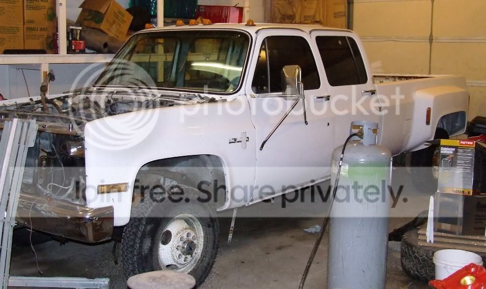

Whole dang thing. Getting the truck for a song. Runs good. There is problems with the title. Original lein holder went bankrupt. As did the second and third. I know I could probably work it out to get the title but I really don't want to as I have been trying now for a couple months.
So 6.5 and a 4l80 will make its way into my crew cab. It's a 93 so mechanical injection pump and standalone controlled trans. I will have the whole truck.
Should be a decent project. Shouldn't be too hard. Hopefully have it all up here in a month

Big block turbo 400 but nothing was in the truck when I got it
My truck
Donor

It will be a bit before I get to it. But that's the plan. Just gonna cut the stock stuff down so the turbo fits.
