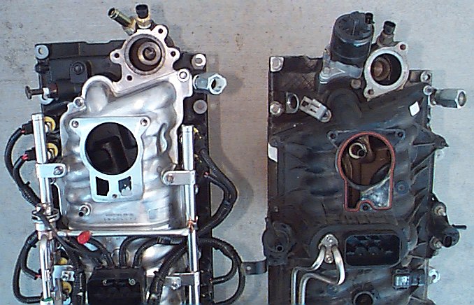

didn't even think of that......good one. are the injectors under the valve covers? or in the intake? :doah:
They should be in the intake, probly under some fancy cover that says Vortec. Been a while since i looked at one.

and with the 97 you get to pull the intake to get to the injectors, pull the little vortec cover etc etc... but did you make sure it was spark to each hole first?
Yeah, just did some looking, and it appears you have to pull the upper intake off to get at the injectors, so I'd be checking fuel pressure and ignition before going after the injectors.
Once you do pull the upper intake off, check the injector driver function with the noid light, then if that checks out, pull the injectors and have them tested / cleaned somewhere.
