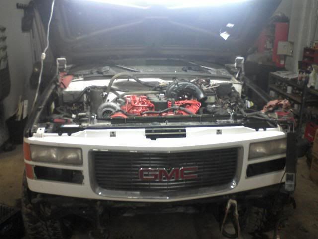

for sure this is what you want to see in a chevy. I've done it. its not that much work, if you're going to be swapping an engine anyways. I yarded the 454 for the cummins, and converted from stick to auto. so there was some added work on that end. go that route. :thumb::thumb:
