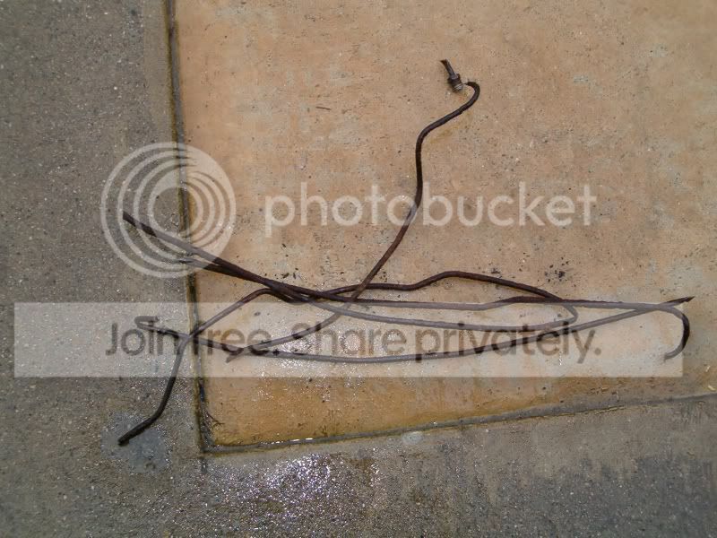

got the new motor on the t/c today, hooked up the driveshaft, and went for a test spin....hit the 2wd button and it went in....cool, but then this happened:
blew the front (by the t/c) to rear brakeline...dam I hate salt!
