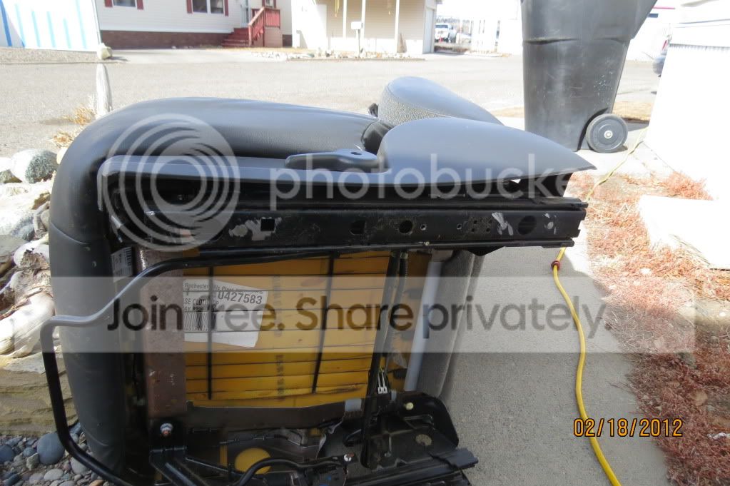

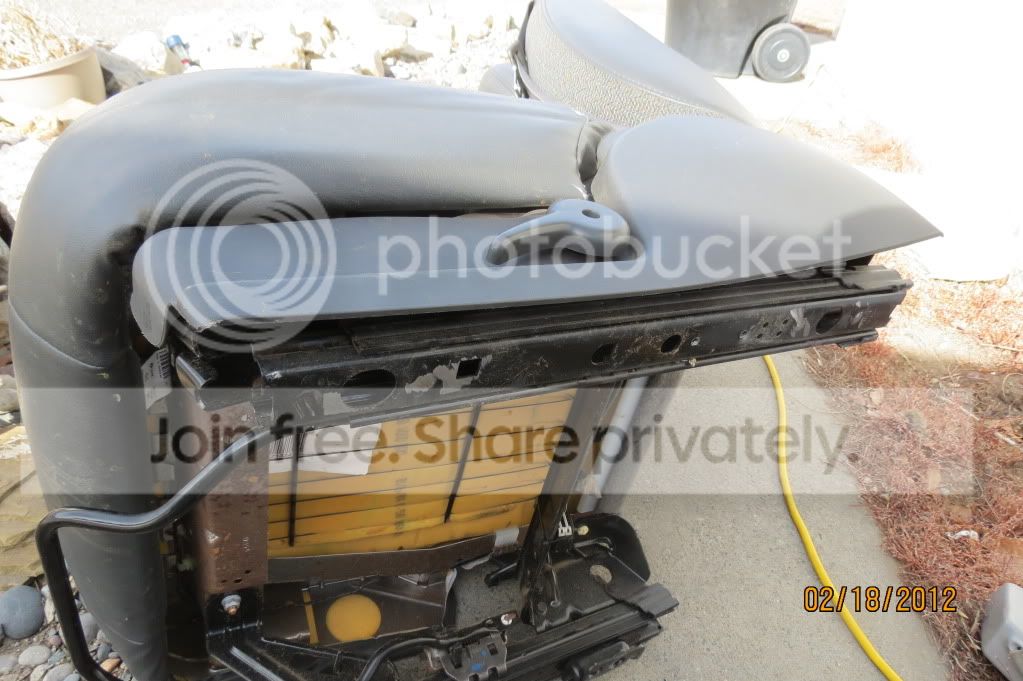

Ok, on to the pics!

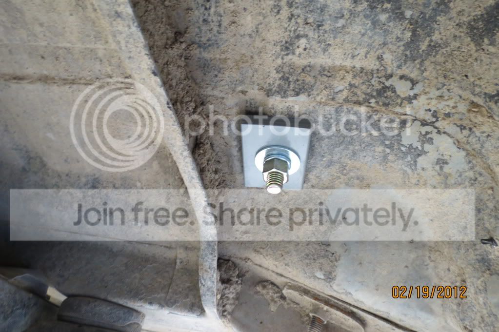

Some shots of the bottom. Grade 8 hardware.
3/8 steel should hold up.

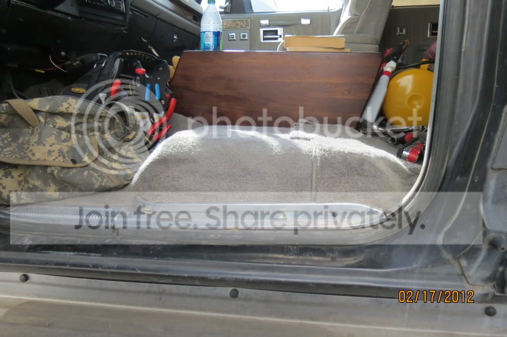

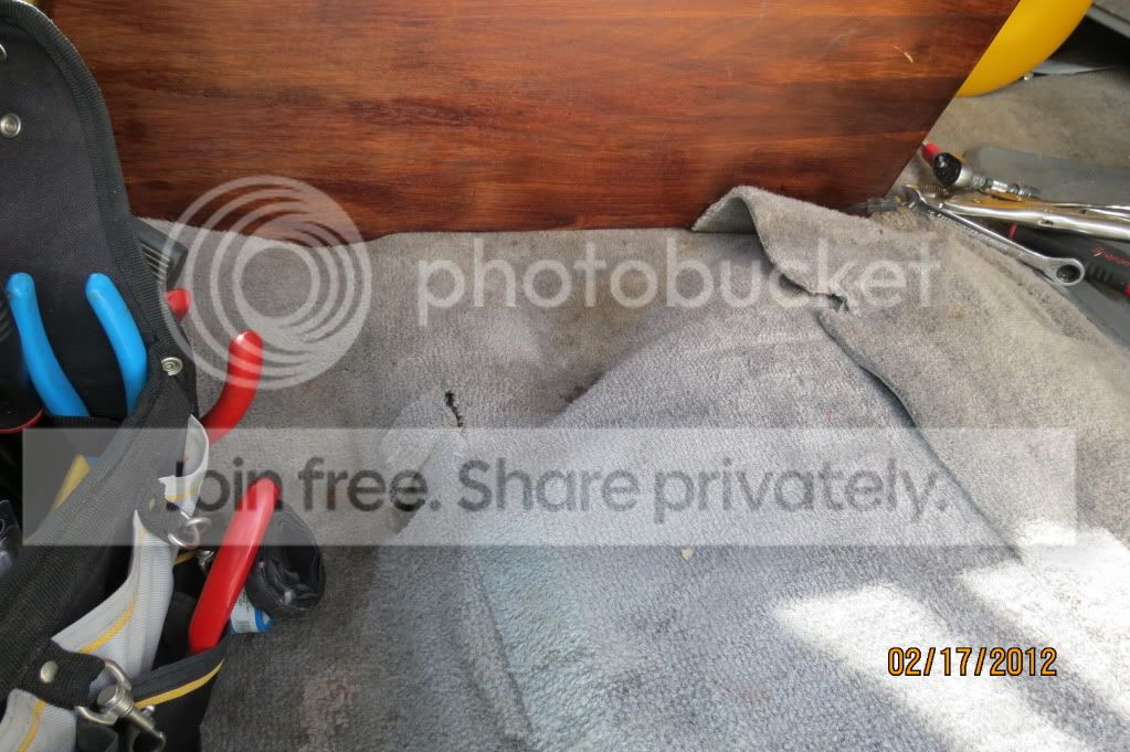

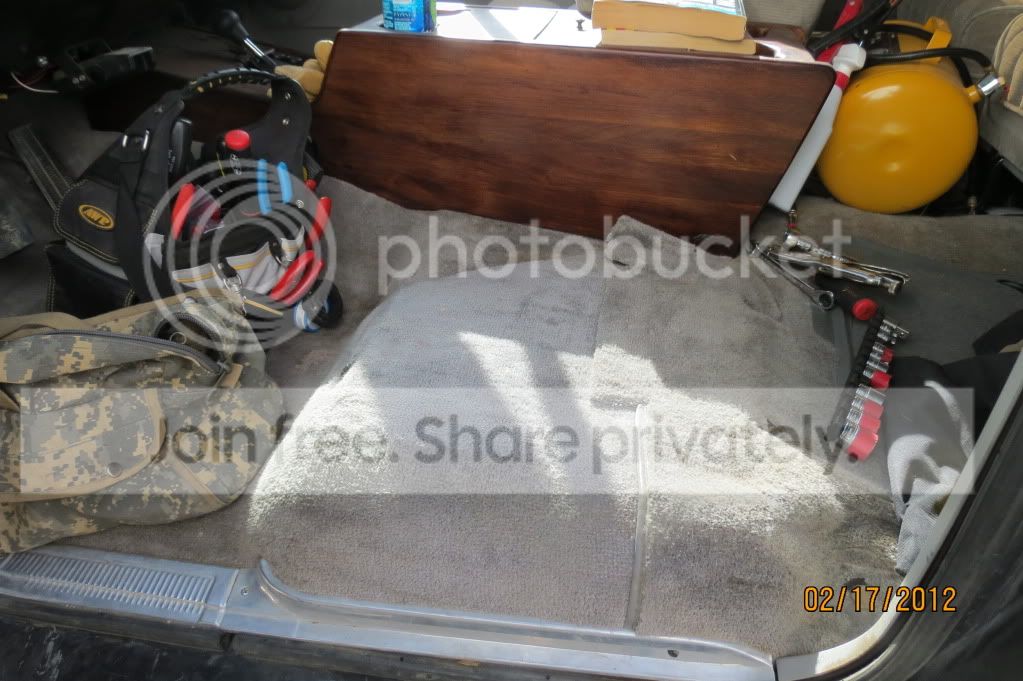

Here are some more shots of the floor and how uneven it was. Initially I was worried that the seats would sit to high but it turned out great for me. My head is about 6 inches from the ceiling and you have to tilt the steering wheel up when you get in or out but it is very comfortable driving this thing now.

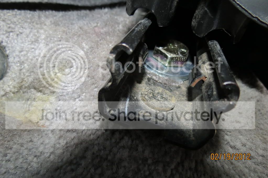

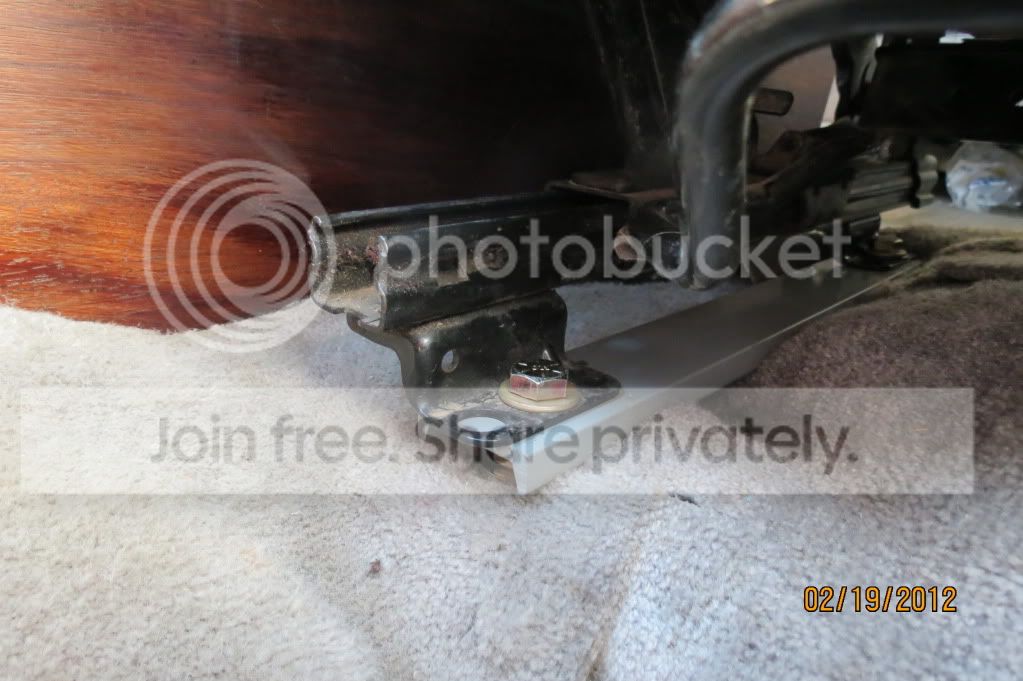

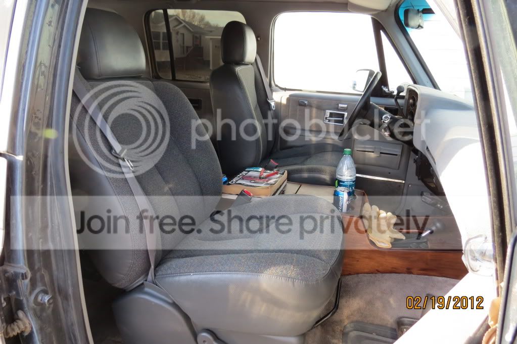

I did modify a some.... I cut the outer brackets off (closest to the doors) and added spacers, washers, and some c-channel on the inner seat supports, here are some pics.
Closest to the drivers door, I just used about 3/4 inch spacer in the rear.
Next to the console, about 3/4 inch spacer in front and a good 2 inches in the rear. Sorry no pics of the rear right now.
Put the bolt back in the hole. Or one just like it but shorter so it doesn't stick out the bottom.
I like it. Looks like something I could do with mine, I'm 5'8" so I think I would have room
Sent from my HTC Sensation 4G using Tapatalk
Looks great.Any ideas on what to do with the hole left over from seatbelt bolt?
Big baller! Even got the palm tree in the background! That looks nice, you should post more pics.
As for the seat belt hole, you could just get a shorter bolt and washer but I was thinking about a grab handle for mine for getting in and out of the back seat. Yours looks good!
