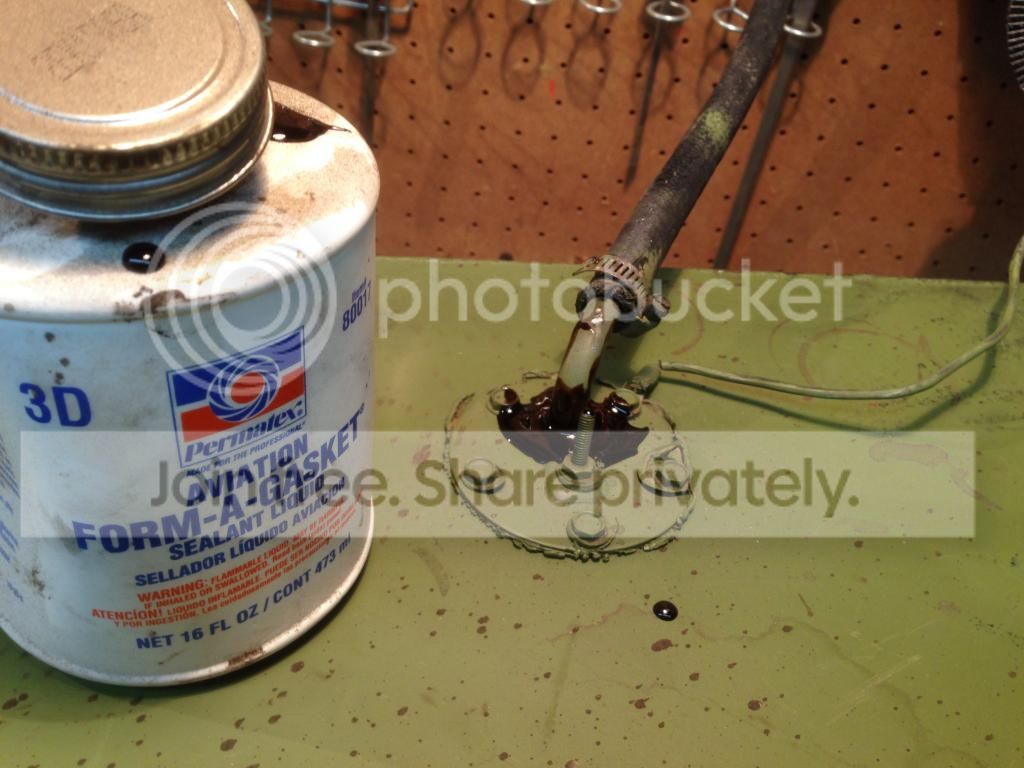

Are you pressure testing this? We used to dial em up to approx 4 psi and brush soapy water along every seam on the tank. Foreman used to 'charge' us a buck a pinhole. I only ever had one tank that didn't cost me at least a buck or two.
Yep, sure am. I picked up the stuff at Ace after work today. So you think 4 psi, huh? We were thinking more like 20 with the soapy water? That might blow it up tho.
My main goal is to have less than 12 pinholes. Eric said the last time he did one, he had 13.

Yeah, go slow on the pressure, 4 psi is a ton as it is. Even at 4 psi you'll visibly notice the tank grow. We just used Dawn dish soap and water in a spray container, or with a brush. You're about to learn how critical all the stop/start areas really are. :doah:

Yeah, 20# is hella too much...I can attest, so can my aluminum tank repair guy!

On the plus side, if you do go with that much pressure you'll probably beat your goal of less than 12 pin holes. Sure, you'll have that one REALLY big one, but it's all about the numbers, right? :P

Now I'm all freaked out. There was a lot of starting and stopping on the thin sheet metal. Not enough to let it grow cold, just enough of a stop to where I didn't blow through.....and yes, there was some of that too. Lol

Thanks Dave. I really didn't know what a good test number would be. I just went with some guys advise with a lot more edjumication, than me. :confused: :popcorn:

I did hook everything up the other night, but the temp fix I did with the Permatex didn't dry and hold. It just blew out the pick up tube. Maybe I can get a couple of minutes to take that off, throw some silicone on it and test it. :thumb:

6 bucks, Rene. :D
Actually it's $7' but one was an old weld I found a pinhole on an outside seam.
Three corners and three ( one top, two bottom) where the dish piece was originally tacked to hold it in the center. There were more than a couple of tacks in those areas due to beating and breaking them loose. Everyone was on a start and stop or over some fairly big tacks. I knew I should have ground those down first...:doah:
Overall, I'm pretty happy. They should be some some easy repairs when I get back.

Test again at 20psi!!!!!!! :haha:
-G
I did, by mistake.... :doah:
I test ALOT of boat tanks.. it was a 250gal dizzle tank... usually it's a cl*ster**** of adapting to get into various tanks..
the valve stuck open... :eek1:
got to 25 before I could shut it down... tank was 3/4 full too.. usually I just go to 3, maybe 4...
it actually held fine, no real swelling, etc... :dunno: :whistle: :haha:
One time after I crested a hill at the dunes the peak dented my right side tank in, huge dent. I stuffed a rag around the hole and my air nozzle and started trying more pressure until I heard a big pop noise. The dent was gone! You could still see a small crease where it was but it was gone. I don't remember what pressure it was but I started small and worked my way up. Plus I was sealing it with a rag and my hand so it couldn't build up too much pressure.
