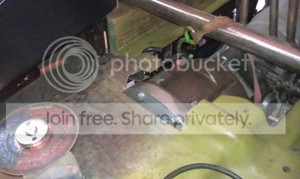

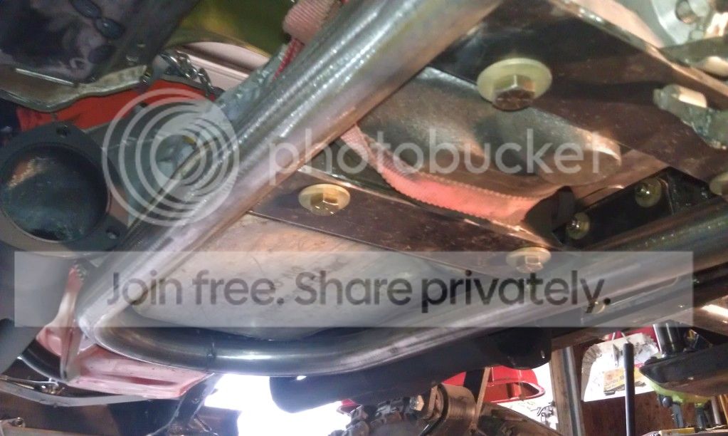

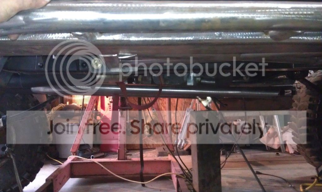

Friday I missed hitting the metal shop to pick up some more tube by about 3 minutes. So, I only had one piece that I could bend up to get the brain flowing. I wanted to somehow incorporate the doubler mount into some kind of skid plate that covers from the front of the trans to the back of the 205. At first I made my bend a little to big and had to cut it down. It still looks like I need to trim it down another inch so I can clear the exhaust.

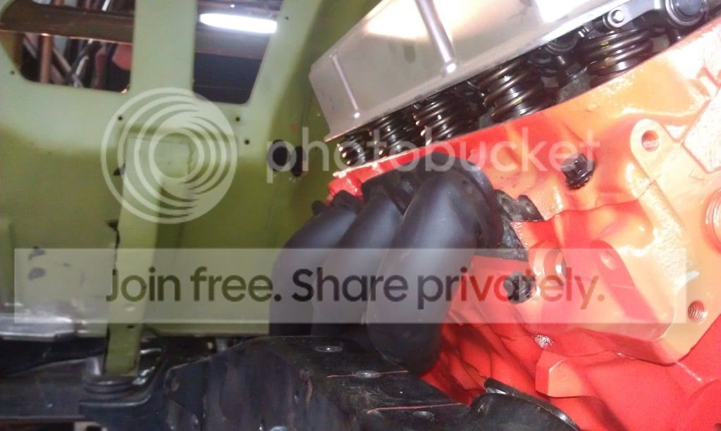

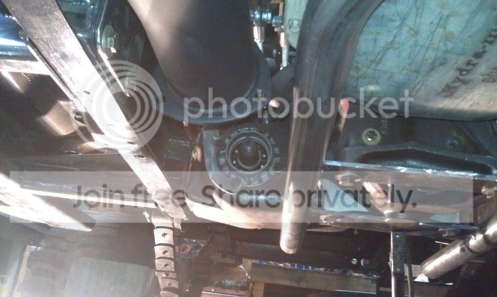

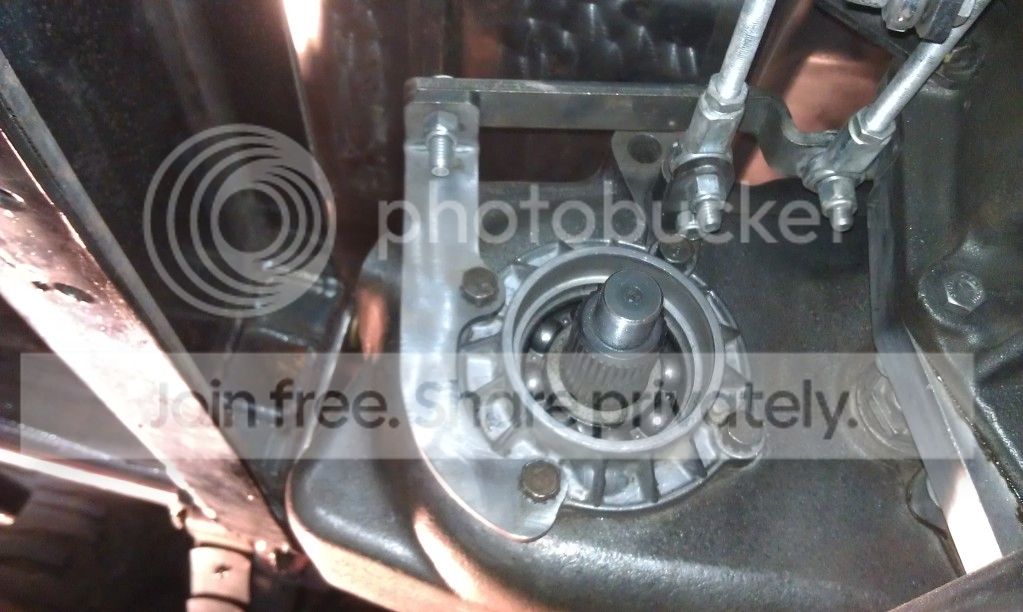

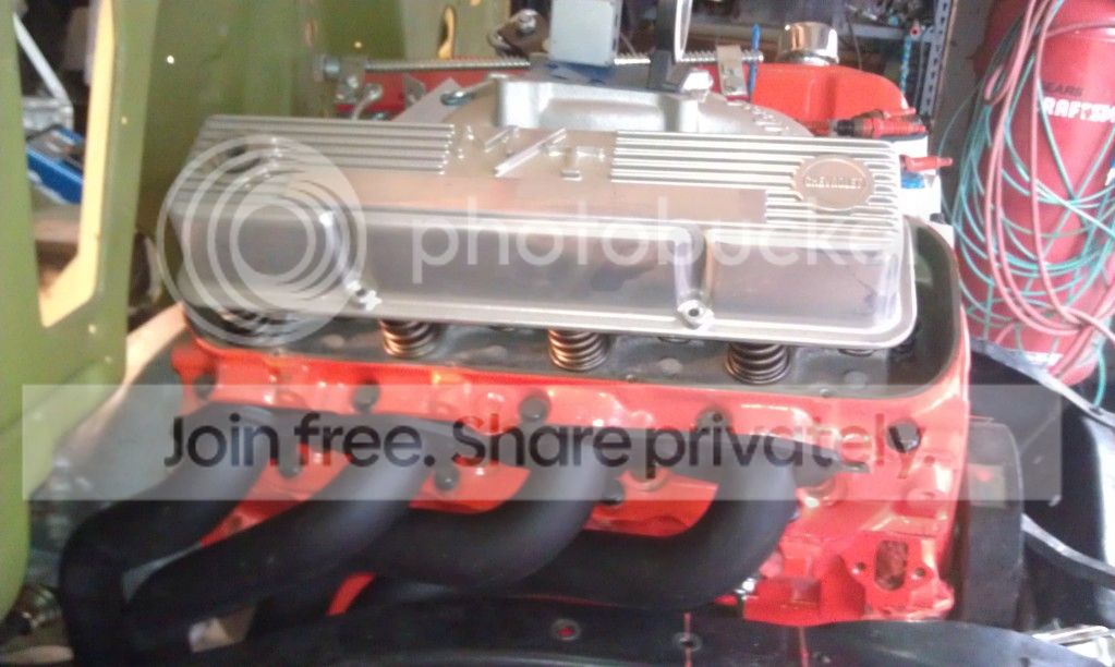

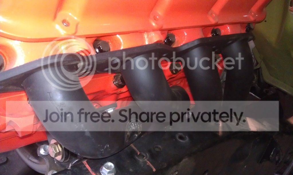

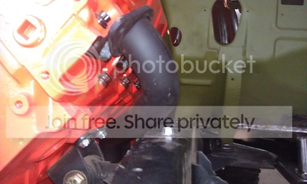

I finally attempted on installing my Hooker headers to see where and how this is all going to play out under the rig. Well, I ran into several problems with the headers. I guess 1st off, is I don't have enough room in the frame area for the two front tubes (1 and 2 cylinders). I would massage the frame in this area, but it's hitting the engine crossmember too. The second problem I ran into is these seem to hang really low under the floor. They actually hang below the frame some. I need to get these closer to the floor, just to be able to mount the doubler. Third thing that I noticed, is that on the passenger side I'm going to run into problems with the front driveshaft. I put a string going from the Yoke up to the output on the 205 and I'm really going to have some problems here. I also cut the floor a little to gain back my 4.5* for the rear driveline. This looks like it's going to be a problem too. I don't know how I'm going to get my exhaust by there.
Lot's of little problems came up this weekend that I have to work through. I guess this is what you get by installing every custom part that was not existing on the 43 year old chev.

Cut in the floor
Drivers side
Passenger side. I put on an old SB valve cover to see how much difference there would be. I really like the looks of these old MT's. I bought them back in the day when I thought this was going the 383 route. Might be looking for some BB ones now.

The belly

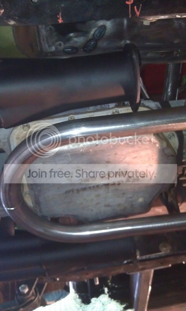

Bent up my last stick to see if this is what I like.

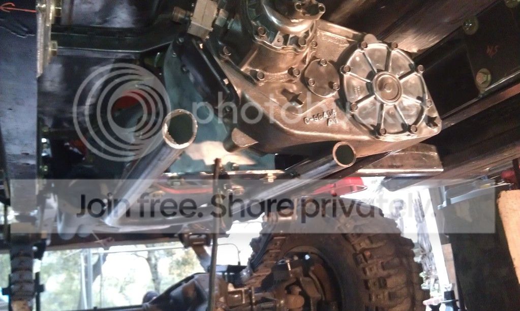

Over the Trans

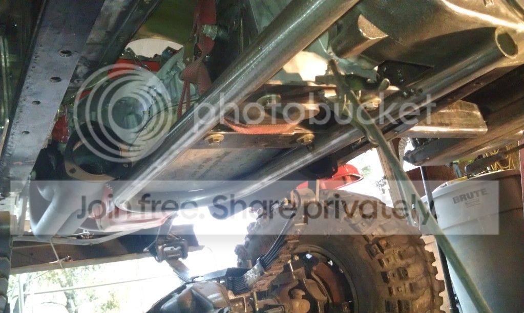

Colliding forces
Un-even ends
Not much room to run stuff by
Yeah that clocked up tcase posts a major problem for the dual exhaust. But those long tube headers are so good for torque. The headers are going to be offset if they are good because they they try to keep them equal length, I have the hookers and really like them. But I don't have my tcase clocked up.
No offense man, but I'm glad I'm not in your shoes at the moment:doah: I know you'll get it, but that just looks like enough little things that need adjusted to turn into one big PITA:haha: I'm sure some more time laying underneath with cause that light bulb to at least flicker. I like the start of the skid plate, that'll look sweet as hell once you finalize it.
You're seeing some of the header issues I noticed on mine. The frame is just too narrow at the front to fit full collectors in. I remember somebody on here (don't know who ATM, maybe IGOR????) who had Kert burn him some taller motor mount plates to get the engine a little higher to help clear the headers in the frame. Either way, I think you're probably going to have to notch that a little. As for the pipes, mine were (and still are until later) bent up in an S shape to go over the T-case after the headers. I know about the better flow of long tubes, but this is going to cause me to run some nice medium length or shorty's when I do the new motor. They'll hold a little closer to the back of the block and should be a pretty straight shot to clear the case, or I could have a x over pipe to run both down the drivers side for space.

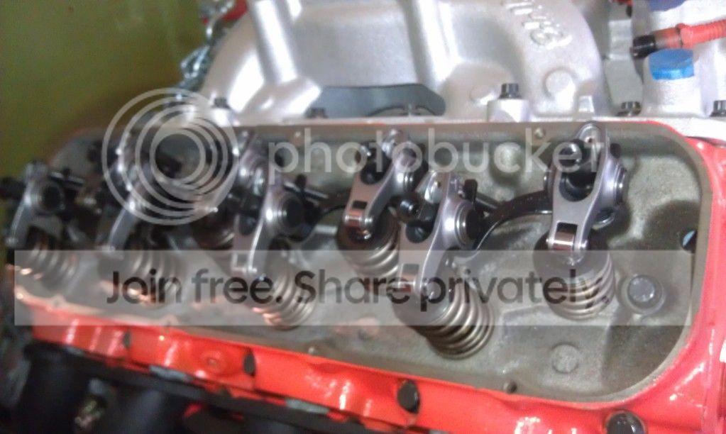

Looking good either way. Those roller rockers are SEXXAY!!!:pimp:
Yep, Heath, I'd like to get this to work without getting into cutting up the headers. But, just like everything else, the 5" cut-off blade always solves clearance issues..:deal:

It was actually AJ that ran into the problem with his headers.
http://coloradok5.com/forums/showthread.php?t=225250&page=21
Post #202.
