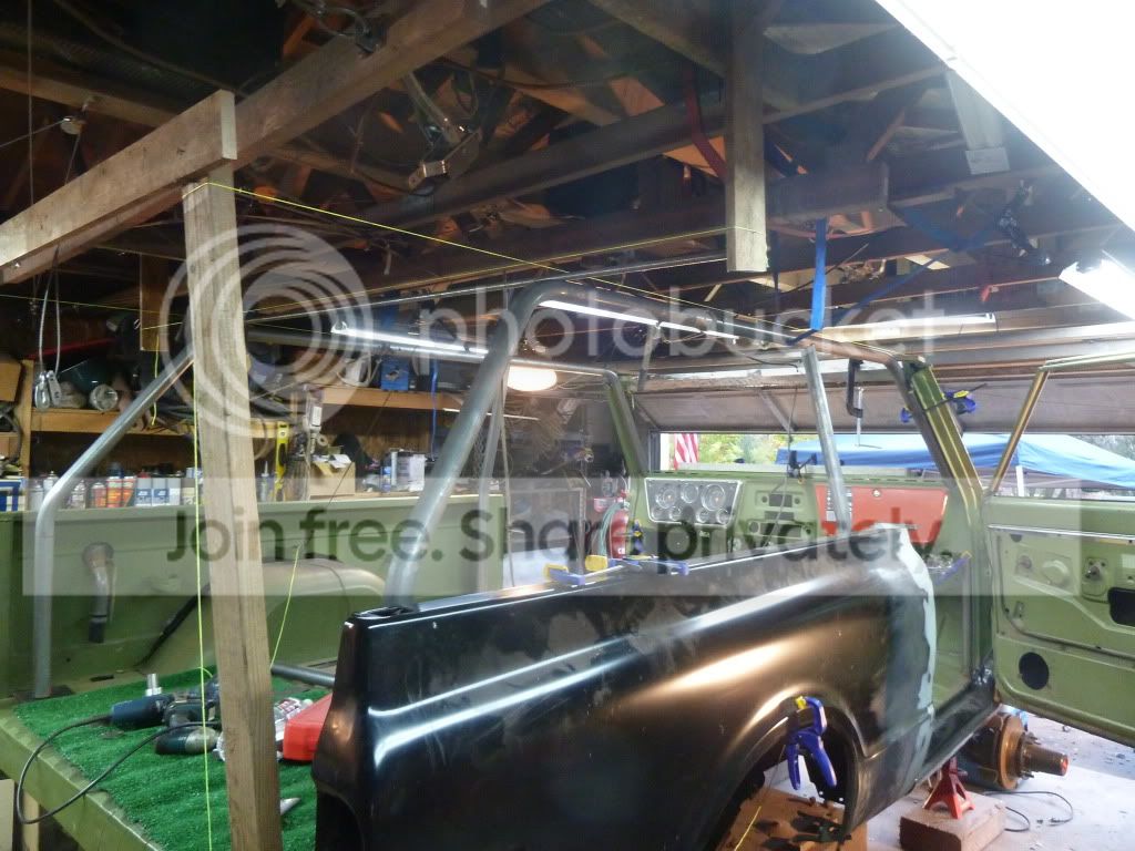

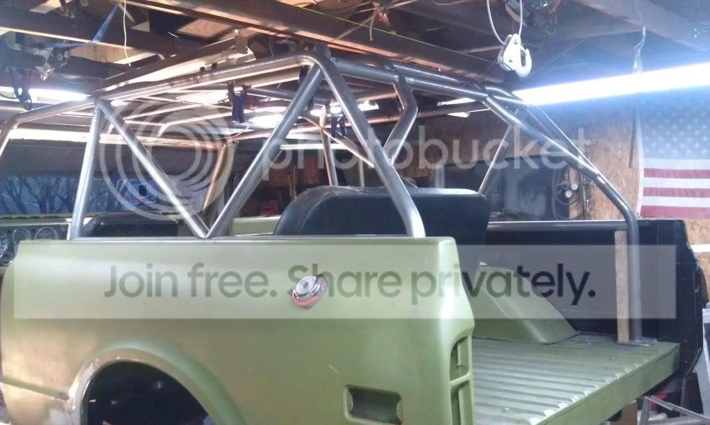

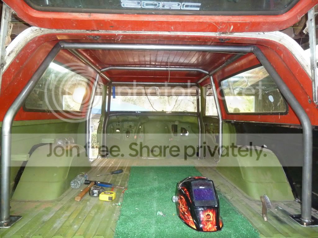

Several cages for 1st Gens seem to have this trait in common, why are the rear bars located so far away from the end of the bed? Is this to allow for the contour of the rear hatch? What am I missing?
I guess the main reason for keeping them a little forward is the tail pan. If you ever want to mount the cage to the frame with some tube, it would be almost impossible if it's coming through the tail pan.
It is back pretty much as far as it can be to tie into the frame on mine and still be removable out the back. :pimp:
Looks like they were trying to have a large square base plate but keep the tube in the center of it.
It is tucked into the corner fairly well.
Had the same thing with the rear cage in the Wife's truck last weekend.
IIRC I made 4x4 plates for just about everything except the footwell plates. And yes, everything was welded to the center of the plates. It should give me a little more room for when I take the Ryoken class of fiberglass side panel fabrication. :D

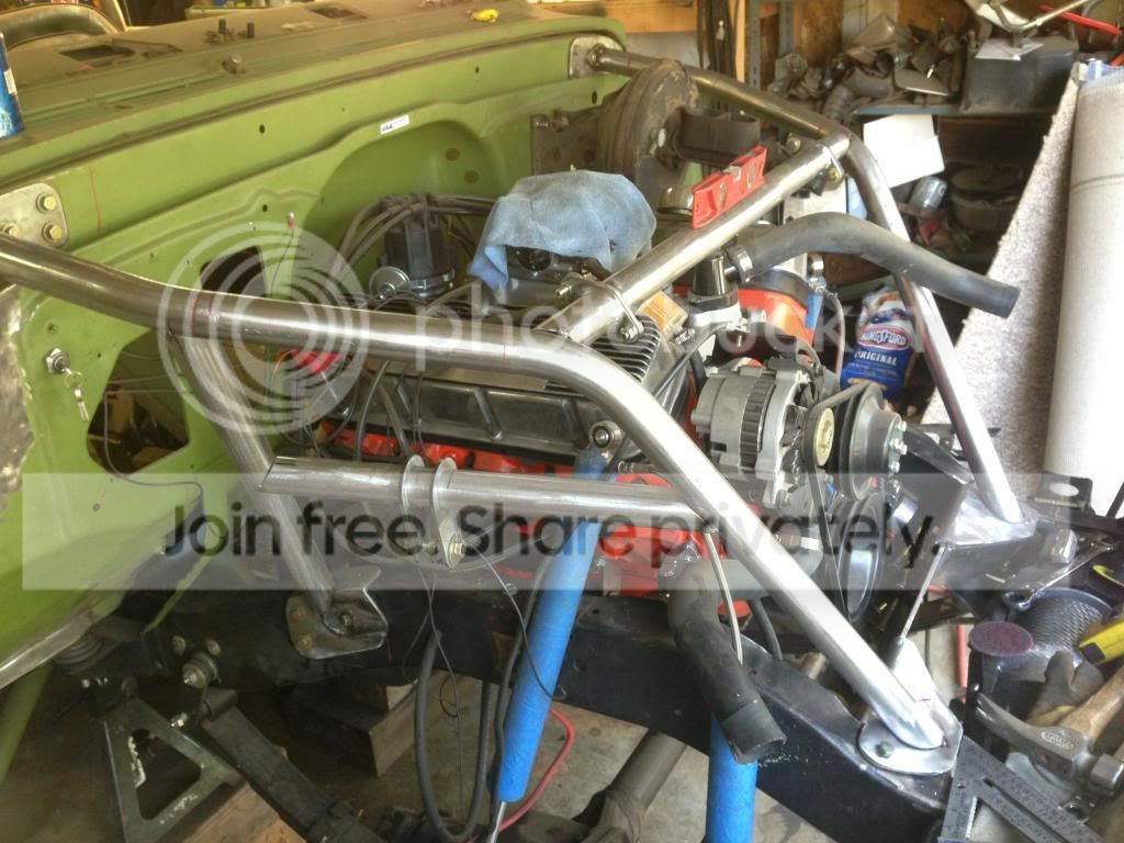

Thanks ES. Not much progress lately. Cut down the engine cage tubes so the sit nice and even on their landing pads is about it. Couple more weeks and I'll be back at it. :waytogo:

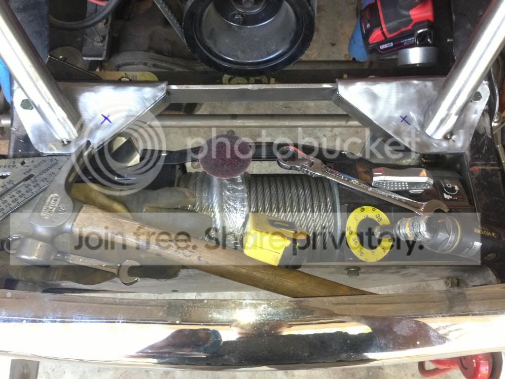

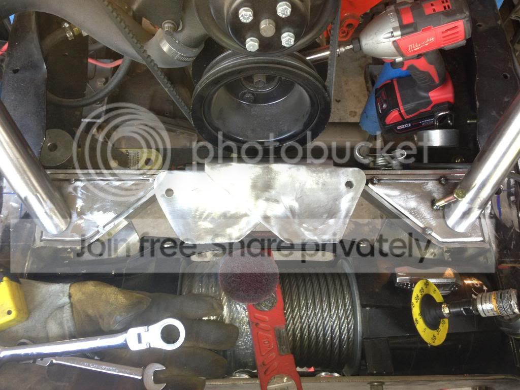

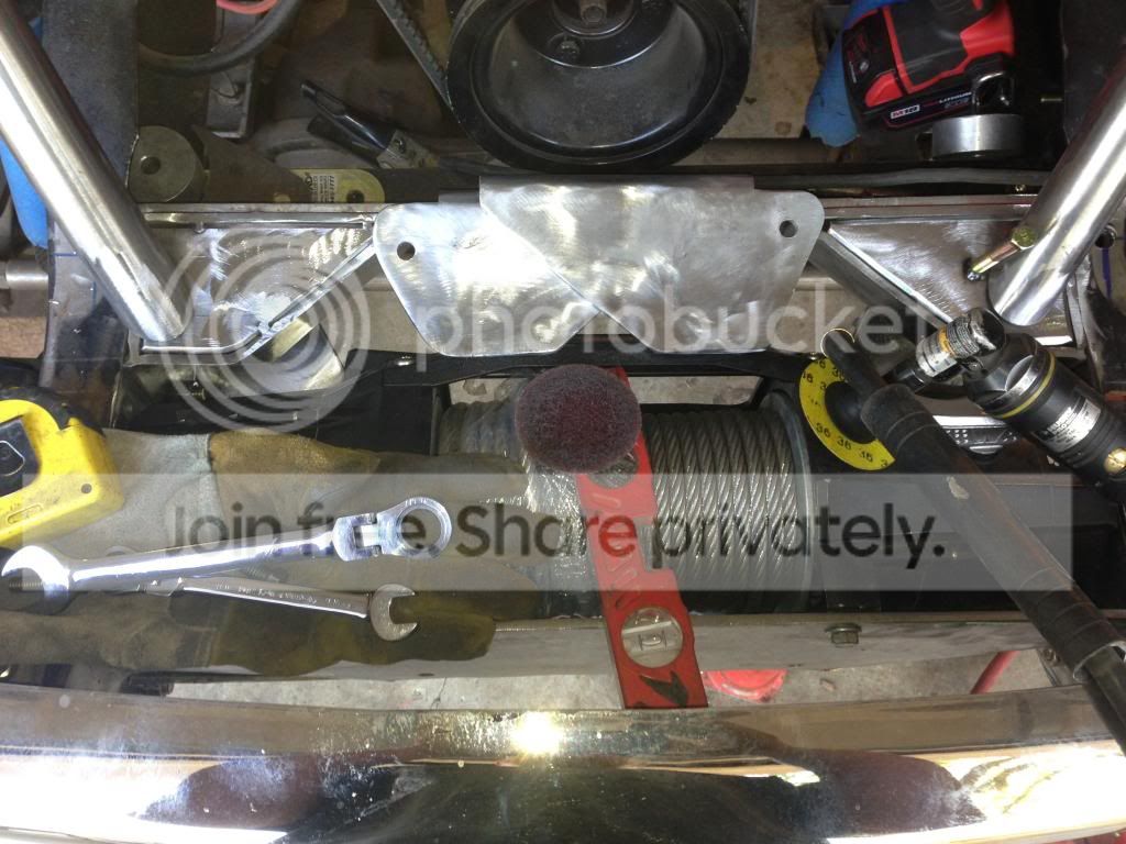

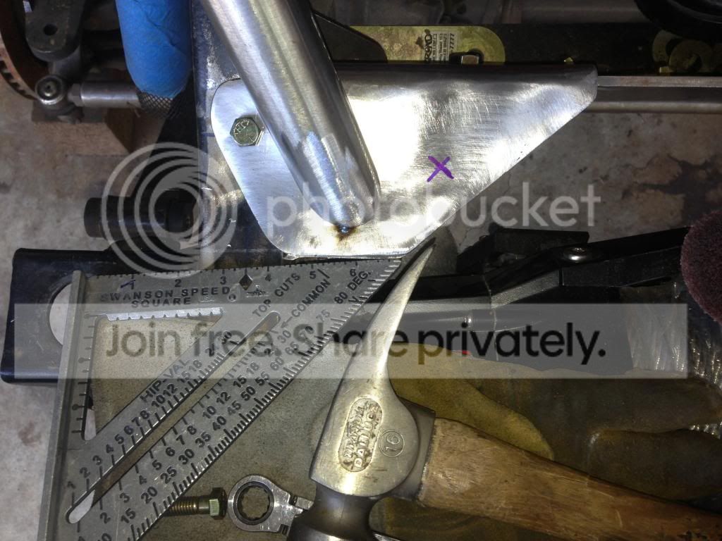

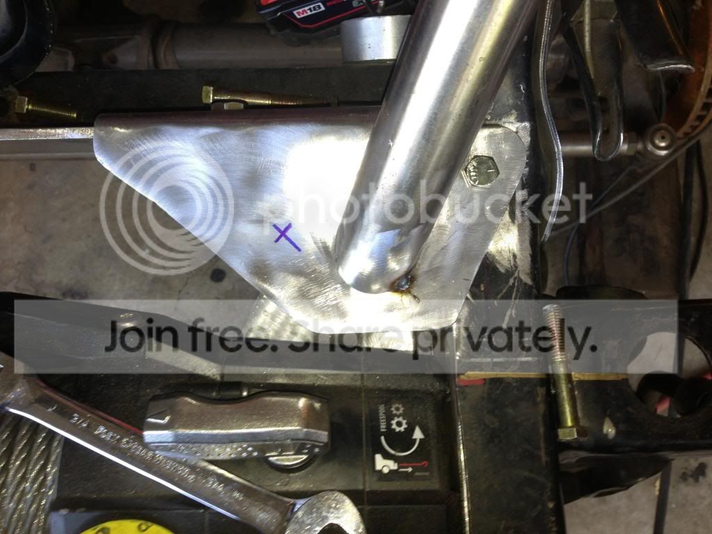

Found a couple hours this last weekend. Ended up getting the tops of the gusset boxes closer. When I take everything back apart I'll fine tune the edges and such. These things just took so long due to being curved along with the frame.
The blue "X" is where I'm going to drill through and install a welded nut on the inside of the box. Three bolts should hold the top plate all together. One in the frame where a hole was existing, one through the top and one through the back.
I did like how the engine cage tubes came down pretty much even on the top of the boxes. :pimp:

There will be a couple more tubes on the cage. I want to land some directly over the shock mount making a "v" in that area. One behind everything heading back towards the firewall and "maybe" one running over the top edge of the firewall from side to side with a couple of small tube gussets on that one.
I don't want to add too much, but just enough, type of thing. My guess is I'll cut up a bunch and only use what I like. :whistle: :dunno:
