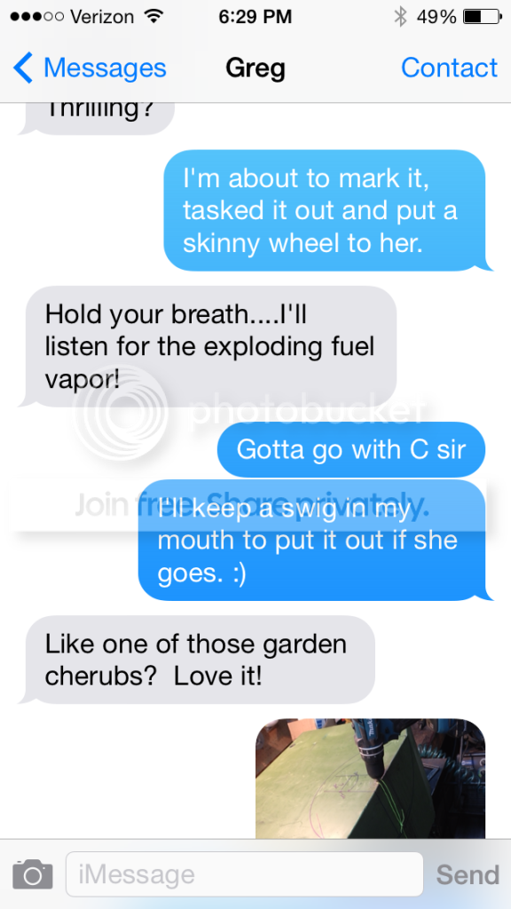

I'll admit, I was pretty freaked out about the tank. That was until I came up with a sensible plan. I wasn't sure if it would work, so I ran it past Greg..
I went for it after he approved it with Love. :pimp:
All in all, no explosion, and I got to swallow that swig of beer. :D :waytogo:

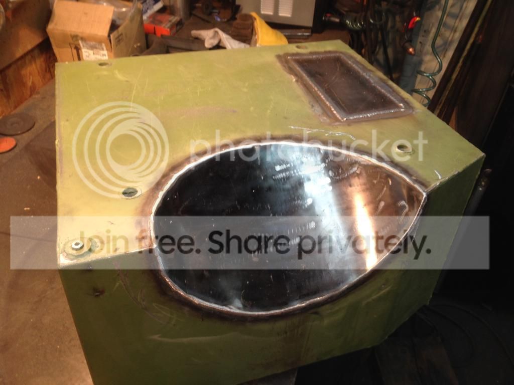

Some needed progress yesterday. Lately, it's just been too damn hot to work out in the shop. Pretty burnt out on the 97+ days.
But, I did do a little somthin', somthin', yesterday. :waytogo: Finished all the mods and repairs I had to do to the $20 tank from the JY.
I ran out of time last night on my quick pressure test, but I think that I'm all good with no leaks. I did find one out of the pick-up and did a little sealing on that until I buy a new one. The form a gasket that I dumped on it, just wouldn't dry in time I was ready to shut down. Hopefully this week I'll have a second to do it right and see if she holds. :dunno:
Pics
All tacked in. What a pain in the arse to get it to this point.
I left a small lip to weld to. The last thing that I wanted to do on this weld was directly hit the corner. I would have been chasing blow outs across the tank.
And it smoothed out just a little. 96% of the weld is still there. I also fixed the original hole that was in this tank.
The front all done.
Nice work man. Annoying how little $hit can eat up so much time like that. Hopefully the temps drop soon and you guys get some rain, I know you need it!
Are you pressure testing this? We used to dial em up to approx 4 psi and brush soapy water along every seam on the tank. Foreman used to 'charge' us a buck a pinhole. I only ever had one tank that didn't cost me at least a buck or two.
