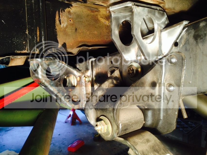

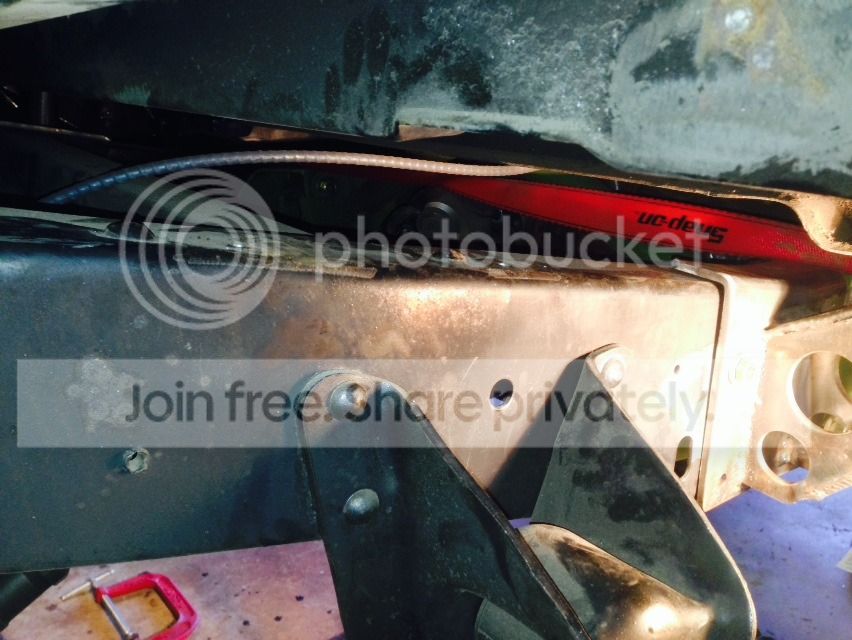

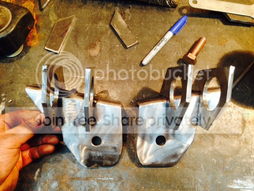

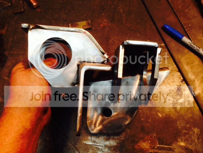

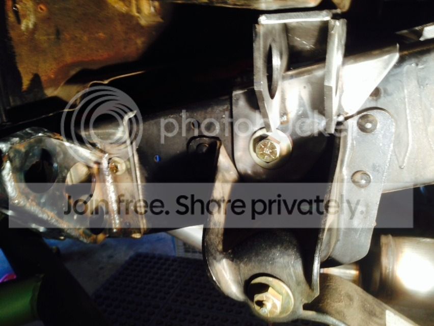

So a little catch up on the pics. Nothing really fun, as I'm still working on the body mounts. But, I am getting closer to the last ones. I still need to finish up these (#3) mount. They are still a little uneven on the top where the shim is going to go, for my liking. I'll take them apart one last time, grind down the high side, install the top again and make the front with some more speeeeed holes.
I really can't wait to make it to the c pillar as I think that will end up being some kind of tube mount going from the frame up to the cage plate with the mount (moved from original) somewhere in the middle. Then I can finally get back to my back Bumper, Bumper. lol
These ended up being a real pain due to the frame incline over the rear axle and the placement of the rear, front shackle hanger.
Here you can see the angle is off by a bit, but the angle of the pic makes it look like a mile.

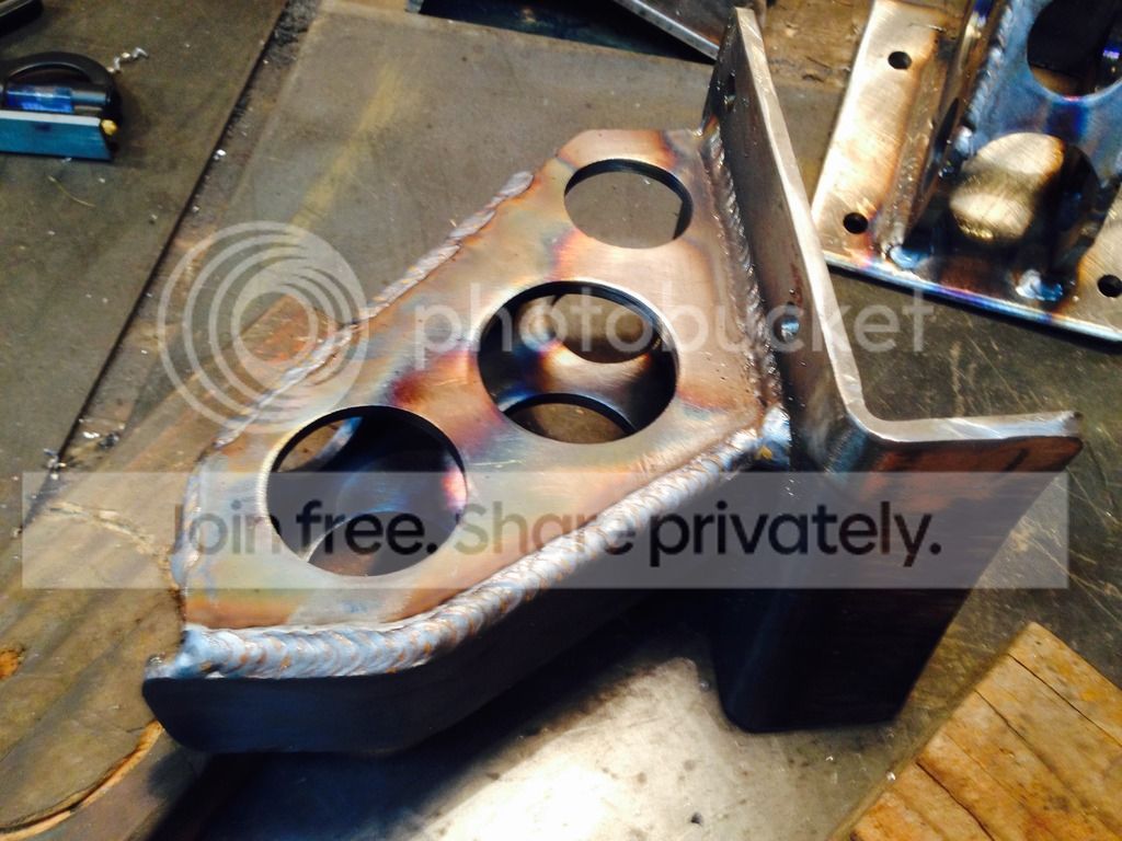

And I guess, I only have one pic, but I did get the first 4 all welded up in my prep for MPS...

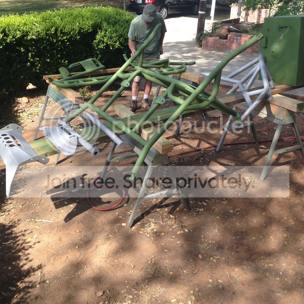

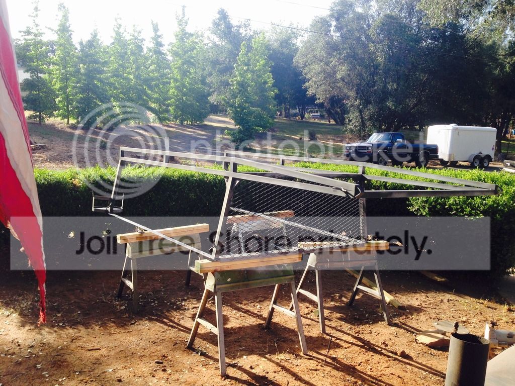

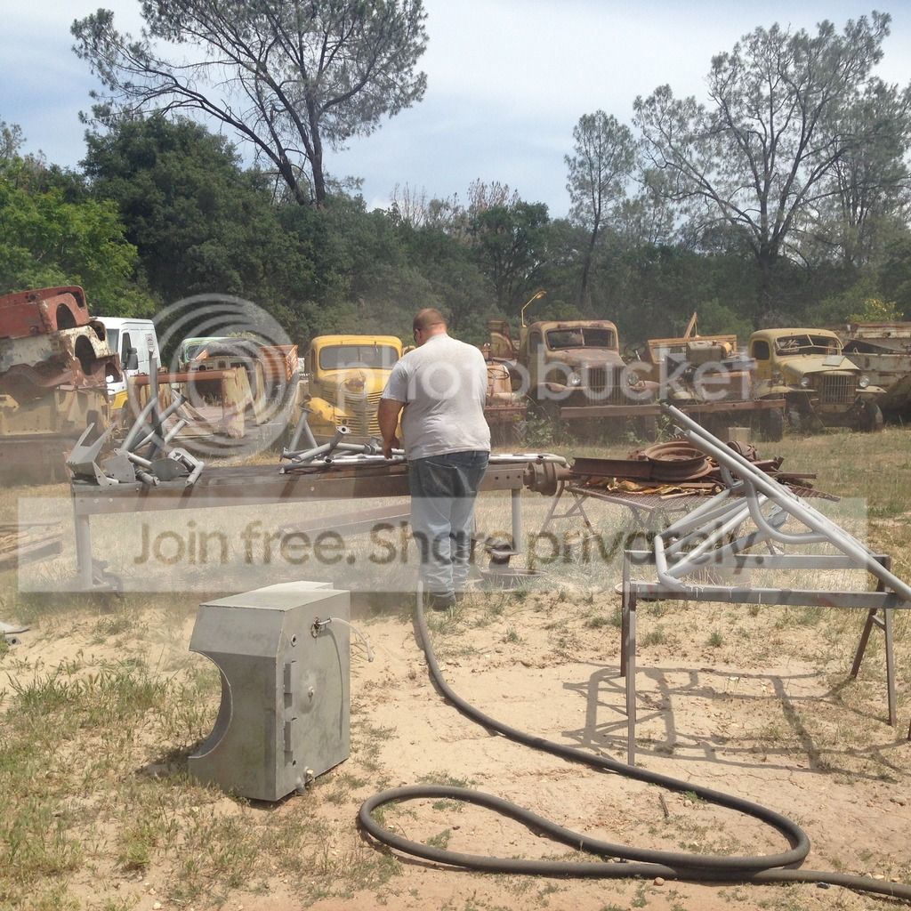

Last week my neighbor was cleaning out his property and had an old lumber rack that would fit the Dodge. I bought some heavy cut media, brought it home and got out the little sand blaster. After figuring out that just blasting the the lumber rack that had some deep rust in the scratches, would have taken me a week and a ton of media, not to mention the required Neers, I made a call to a friend.
This is my bud who, way back on page one of this thread, blasted the frame on the Blazer. I haven't been over there in some time since his dad past, so I was pretty excited to hit the back yard again. Although, he has sold off probably 50 vehicles since his dad past, it was still pretty cool to head over there to use his big blaster.
This week prior he stopped by to see what I needed done. Well, the more I thought about it, the more I needed done. :whistle: :haha:
Thursday morning I loaded up the flat bed with the rack and a ton of crap that needed blasting. Engine cage, rear seat mounts, winch mount, bumpers and whatnot. I headed off to work to finish a drywall job that I knew was a half day gig. I ended up at his place around 1:00, where I had found out that he had already started.

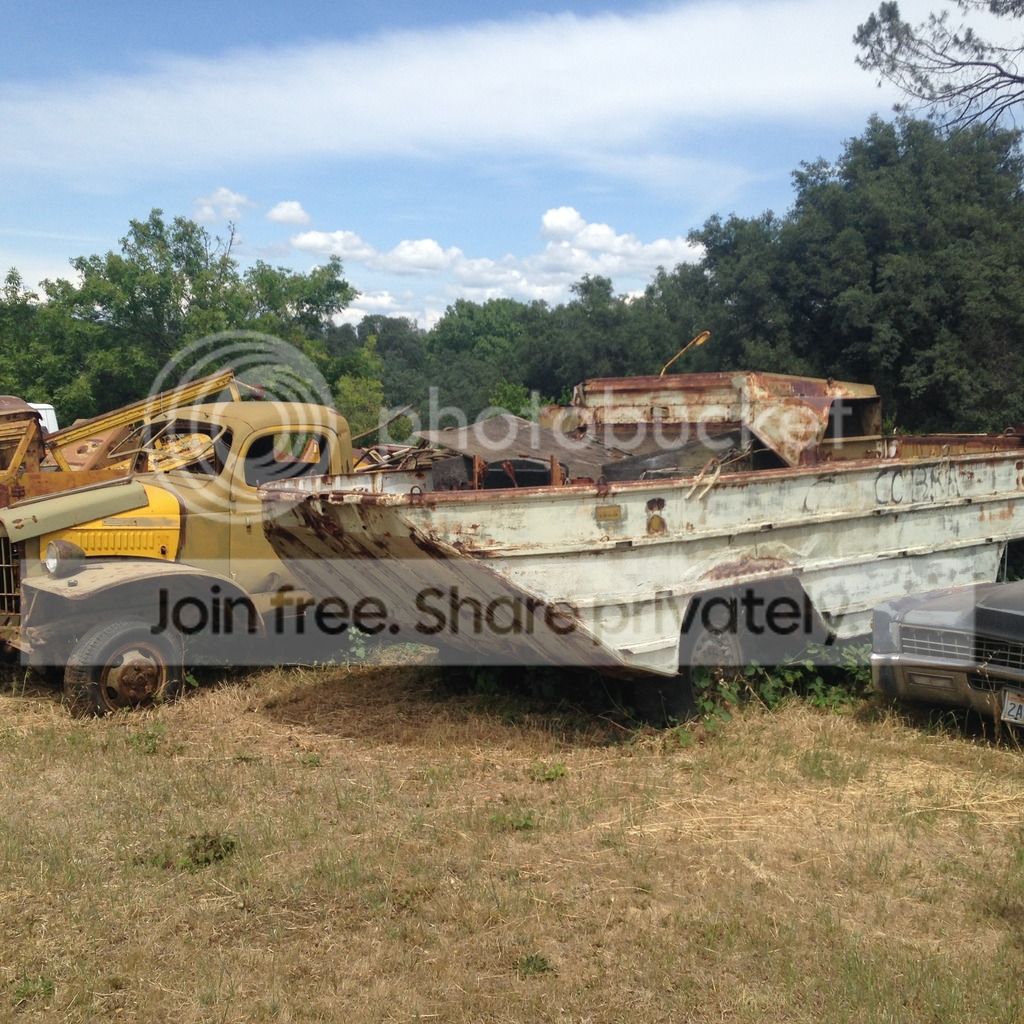

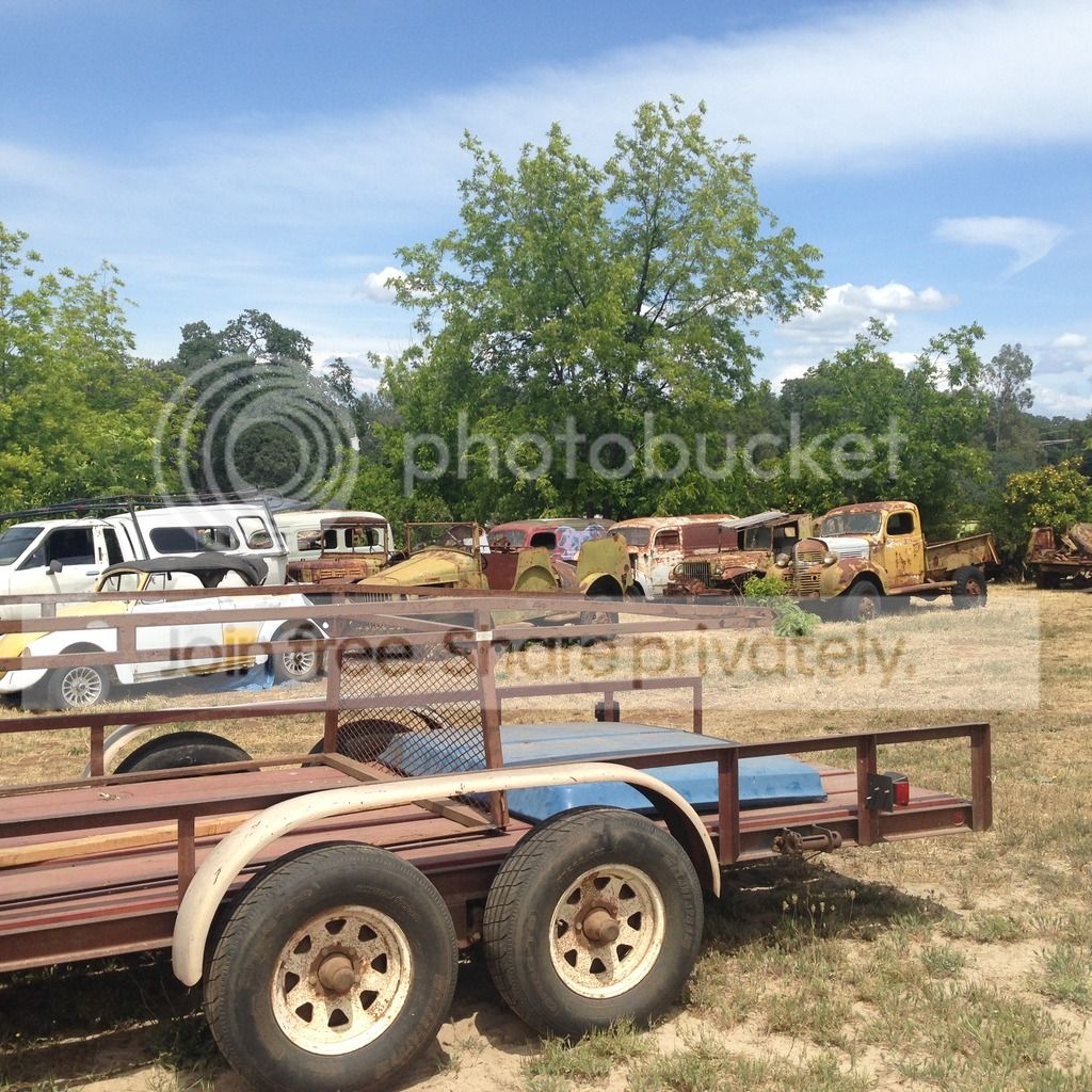

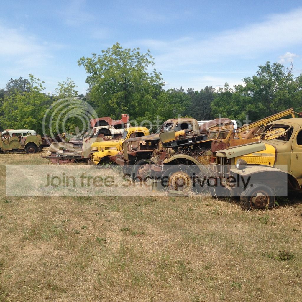

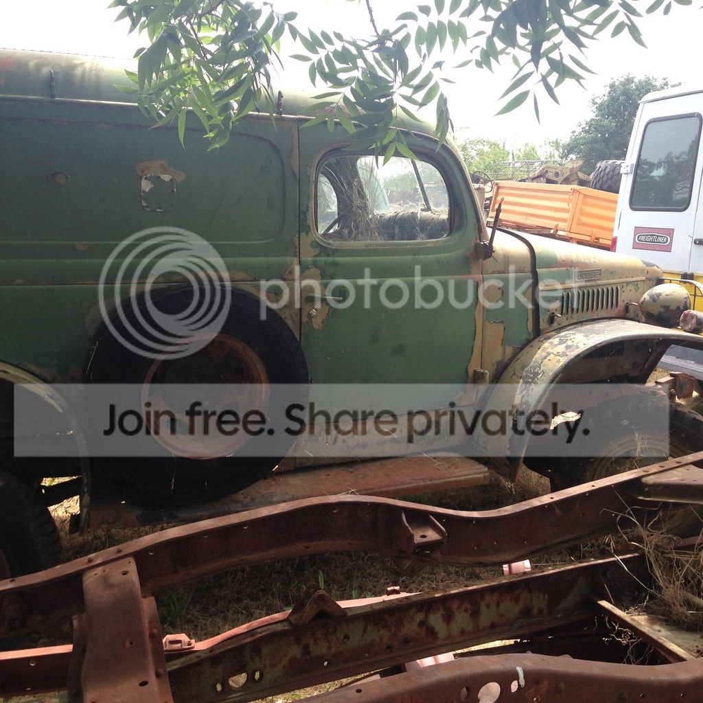

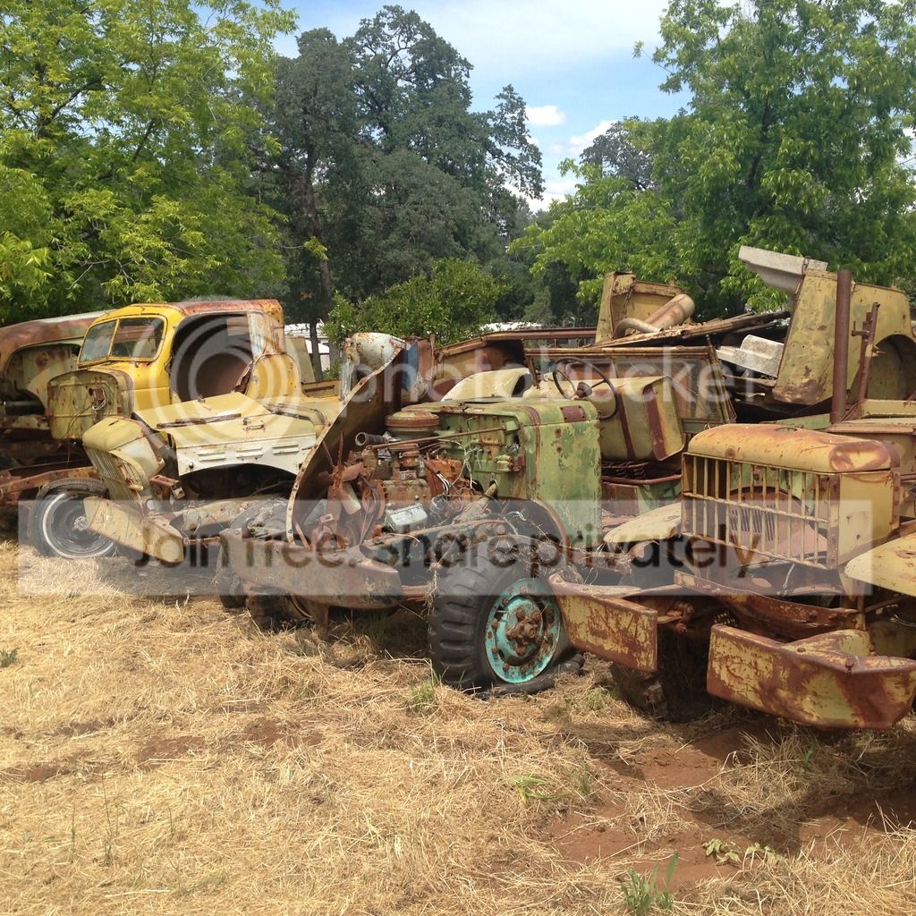

Anyways, how bout a pic fest of some old iron....:thumb:

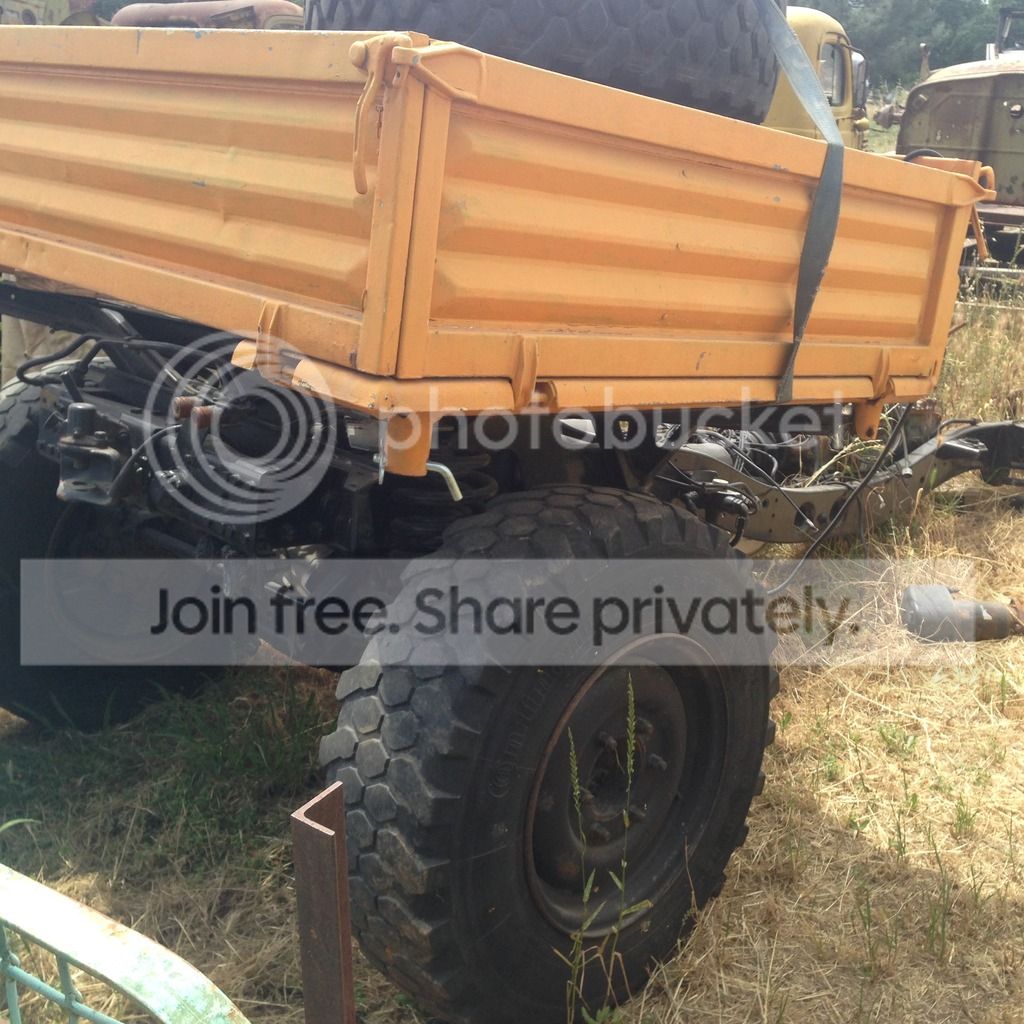

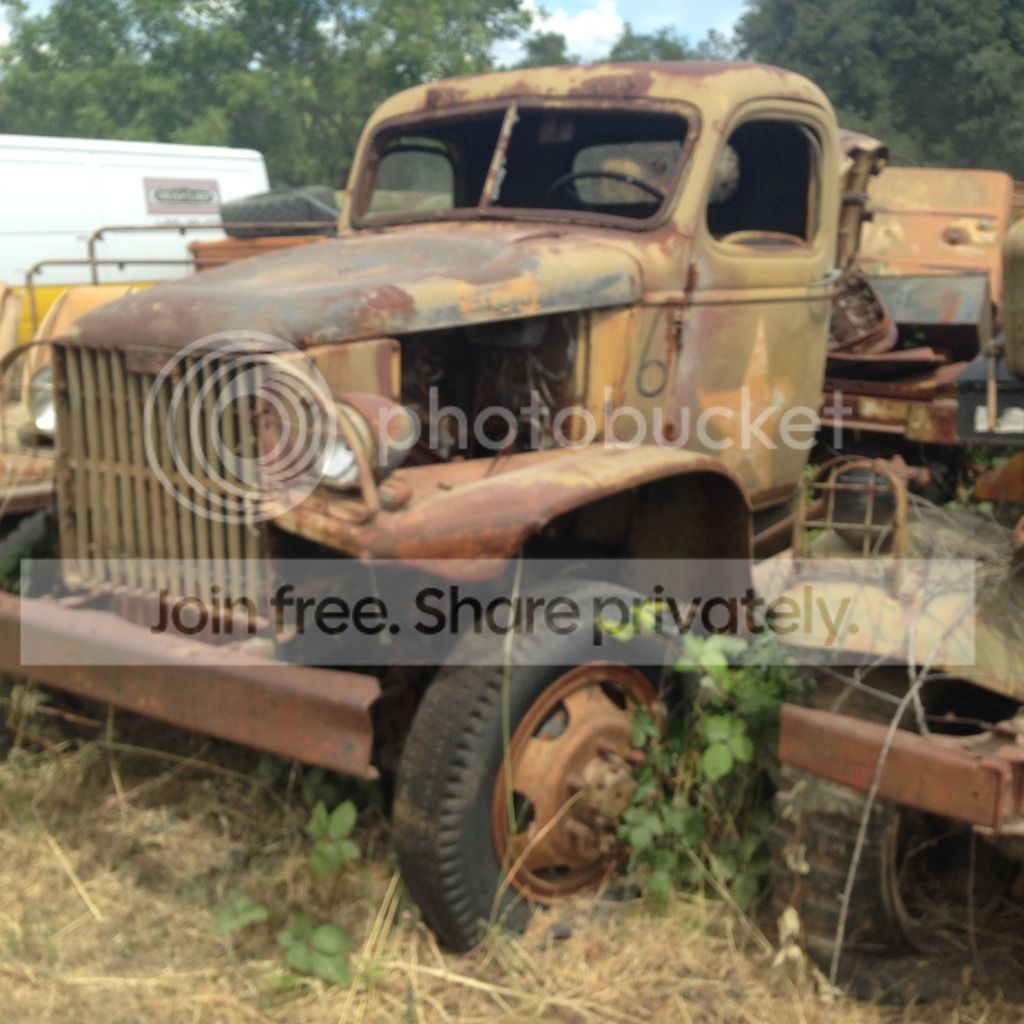

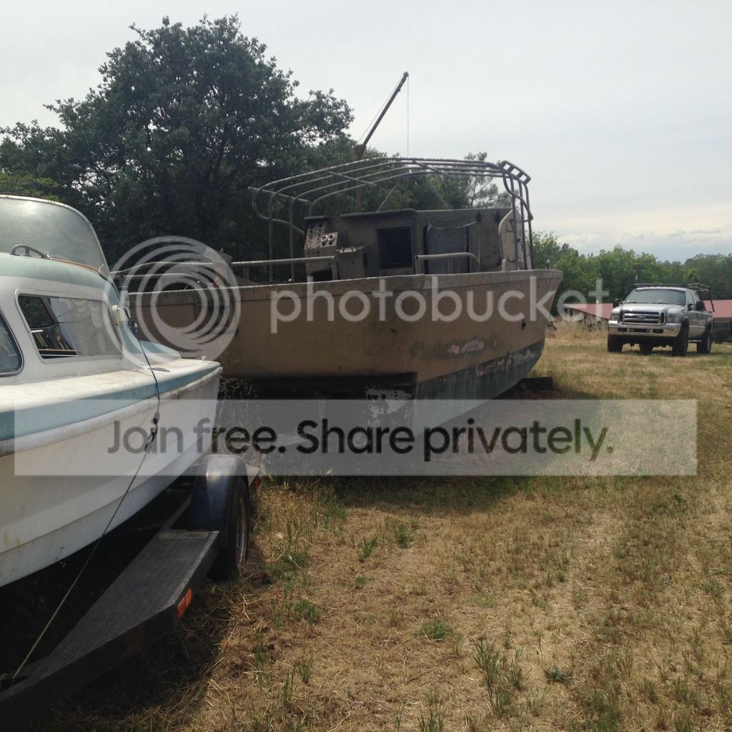

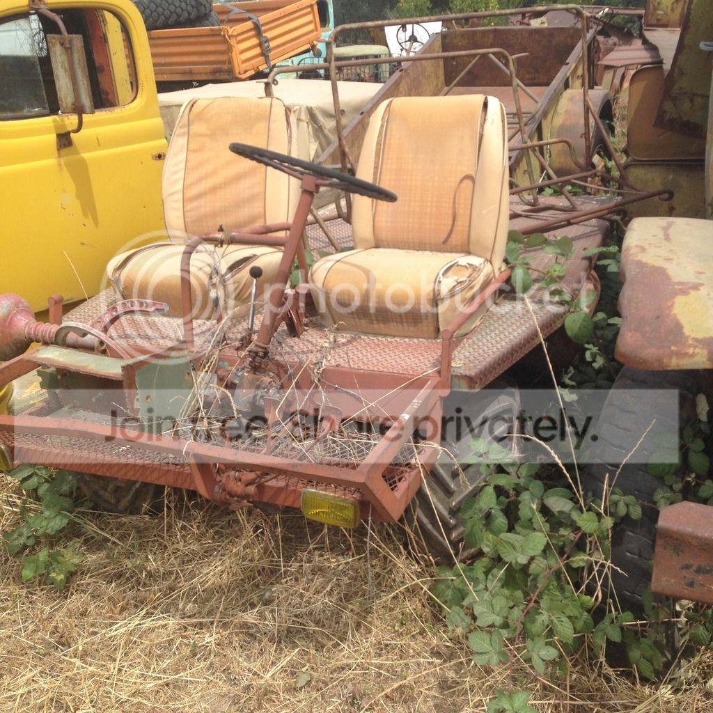

This is what I seen walking up to the blasting area.

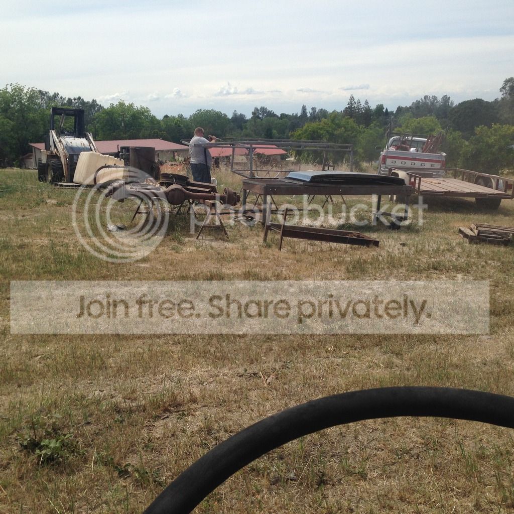

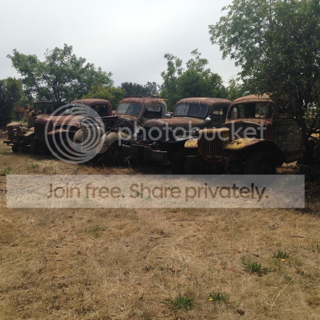

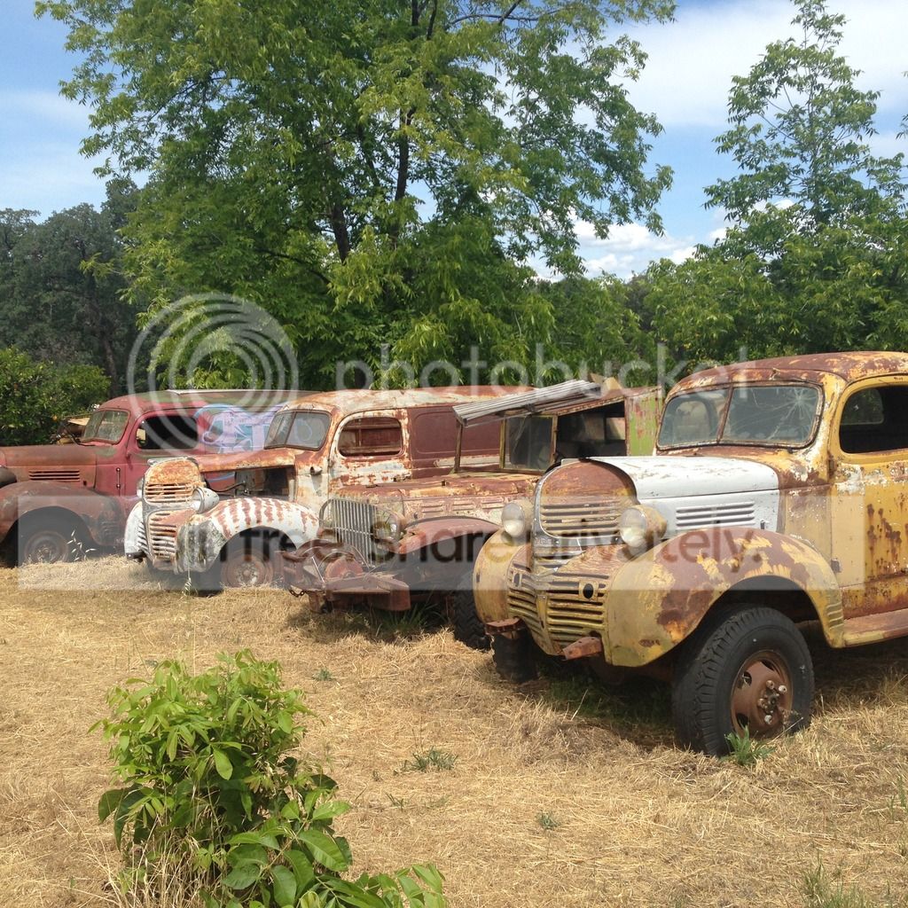

While he was blasting, Gordon and I did a little walking around and I took some pics for you guys.
To be continued. :D

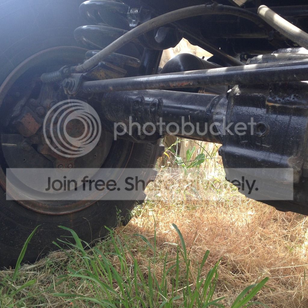

I guess the front axle and cab are in the crates next to this frame..
My favorite..

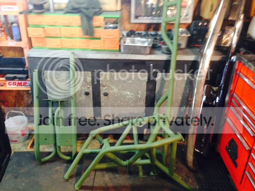

And got everything home last night.

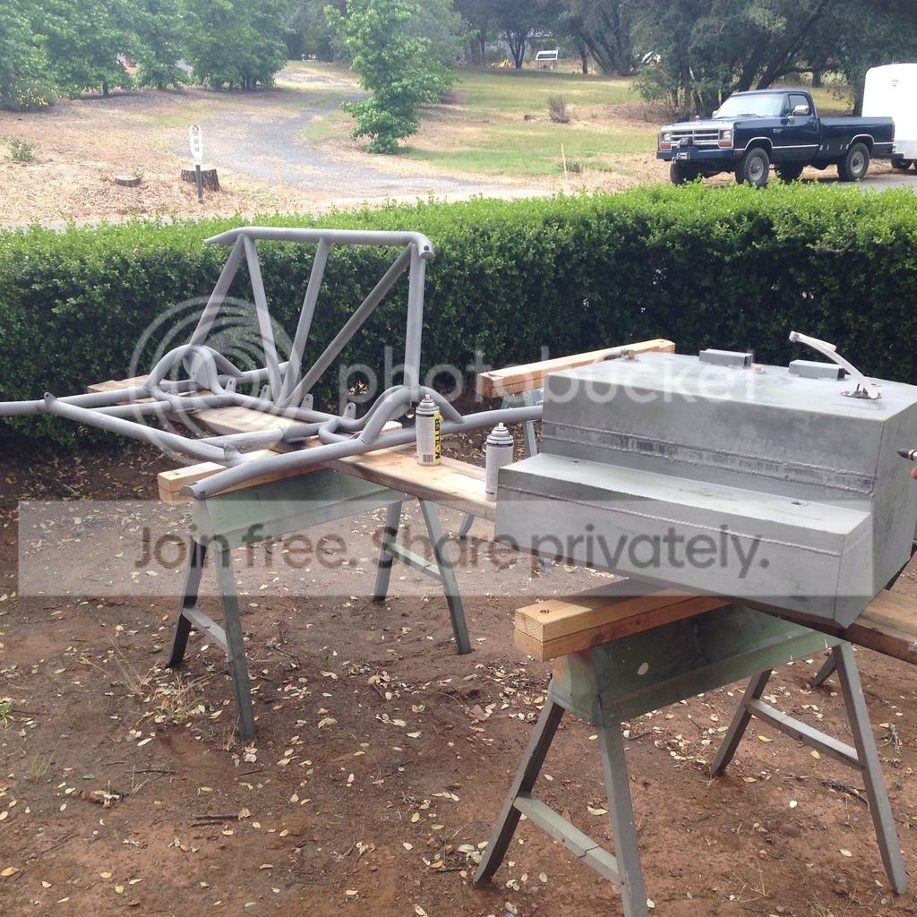

And started to turn the world green..
Leaving just an ugly rack painted in every spare can of crap primer I had left in the garage last night. No green was going to be wasted on this baby. :haha:

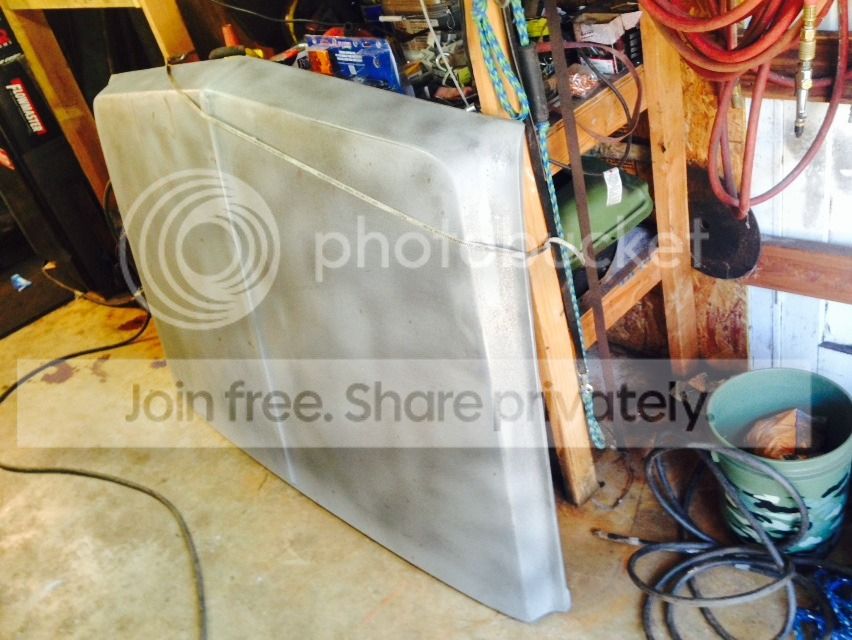

And the hood that needs to be DA'ed first before prime.
