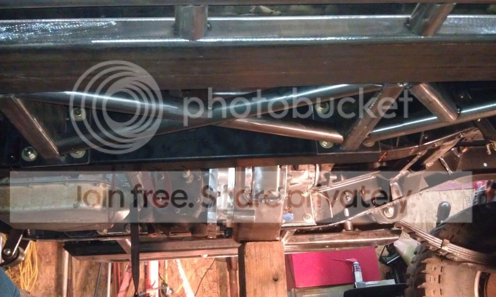

Well, a little progress this weekend.

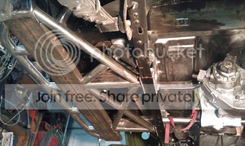

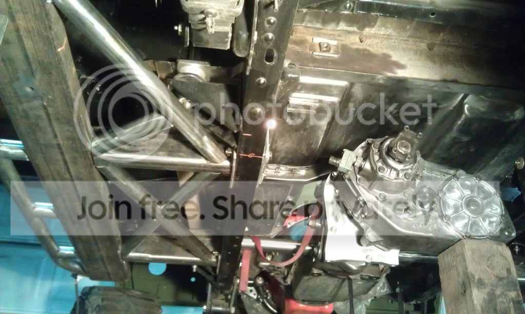

I started up by welding in those four plates to my inner frame c-plate and got those mounted up. Those will be in there until they come out again and the center plate will be welded in. That won't happen till I really figure out how I'm going to mount the doubler.

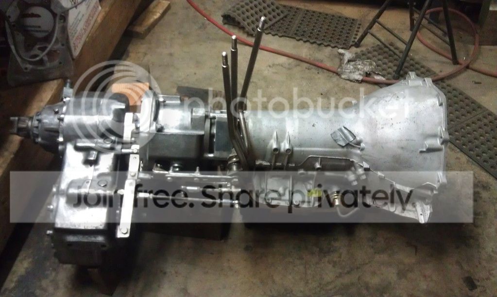

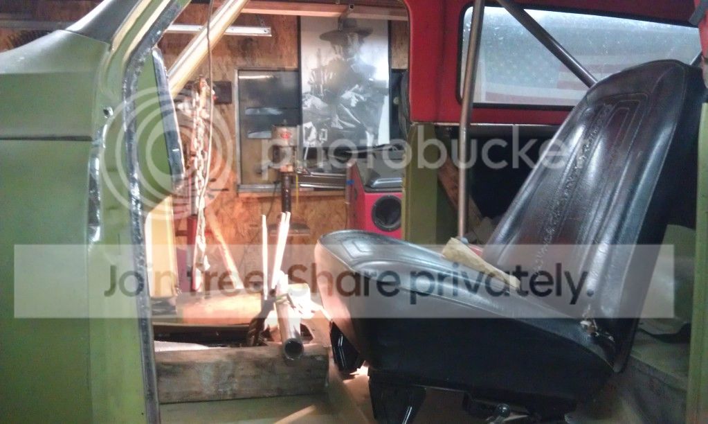

Cleaned up and finally married the doubler to the Th400. It slipped together really nice.

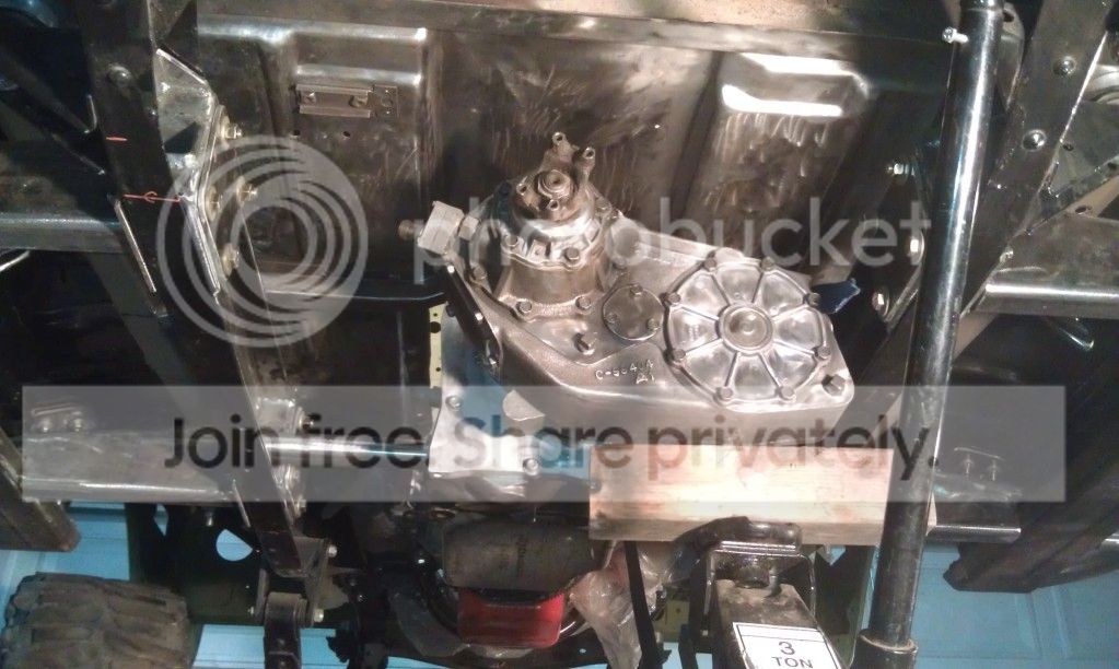

As I had guessed, the doubler only went up so far before I hit the bottom of the tub. Some cutting and fab work will be needed on the floor area to get it up into place. The way it sits now, is about 4-5" lower than the frame. I did some quick non-scientific measuring and it looks like my driveshaft is about 32" long and 23.5 degrees. This will go up as I cut the floor and raise the drivetrain though. I didn't want to really move forward without a lot more research on angles and lengths yet.

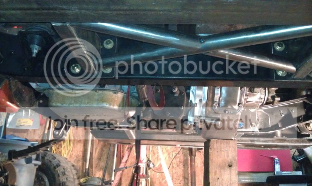

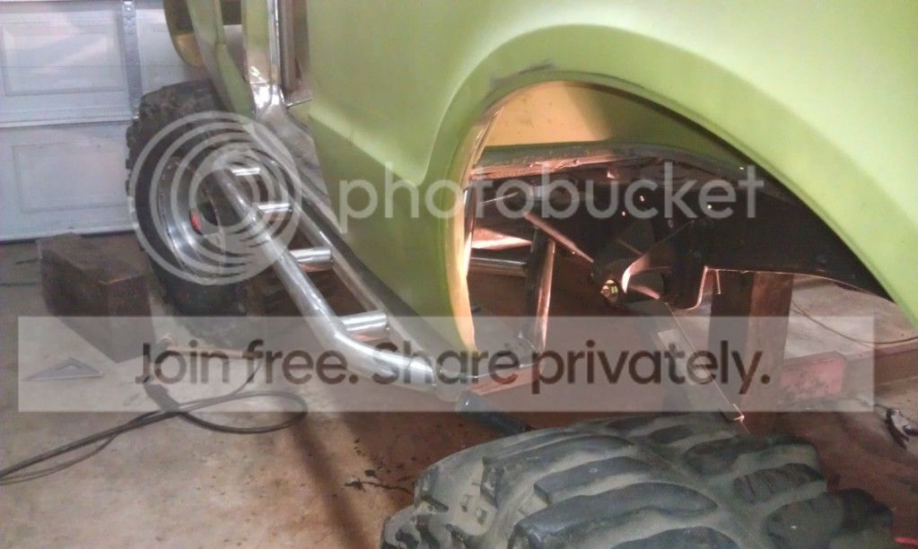

So, still wanting to move forward with out really working on the doubler mount, I moved on to some of the slider bracing. I re-did the main "X" in between the slider braces and moved on to the back. I have been looking at this for weeks, wanting to get this piece in. It was all looking really good while I was under the truck. As soon as I got out, I think I puked a little bit in my mouth when I seen it. It does not go with anything on the truck. I need to take it out and start over. If nothing works, I may just go without it. I don't think that anything is going to shift anymore, with all that I have going on down there.
The outside look..
The other side without it. I think it looks a lot better than that strait piece.

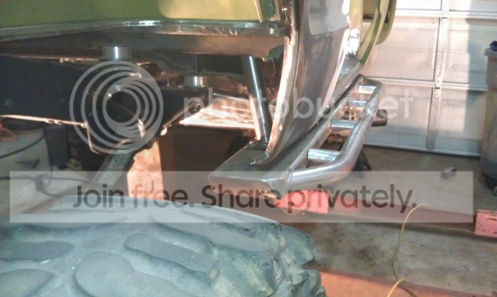

hehe....triple sticks and Clint... bad a$$..:woot:
I'm not sure what you are talking about with that comment. :dunno: just the brace on the end of the slider?
The outside look..
It's the tube at the end of the slider. I really don't like the looks of it from the outside. Maybe if it had the same radius bend on the end like the outside "step" maybe. I think that it just looks out of place for some reason???
oh, I see. it's a straight line, when you have nice curves everywhere else. gotcha.
picky, picky. lol!
I'm no expert, but it seems to me that if you put a bend in it, it kinda defeats the purpose there. with a 2x6 right there to take the beating, I'd guess you could just go without it if it bothers you that much. (although I wouldn't take my word for it. )
I think if you paint it black you won't see it much, I'd leave it there. I think teh whole thing looks real good. Nice work again!
You guys maybe right on that bar. I did another 1/2 mile worth of circles around the rig last night and it may work out...I think that I'll add the other three corners and see how it all looks after. It's only tube and time after all...:o

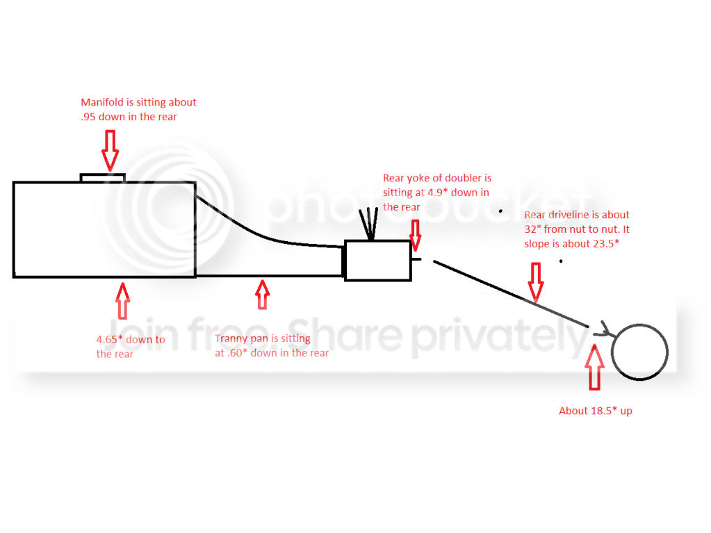

So, now I'm in a pickle. I have the doubler in and really did a lot of measuring last night to see where I'm going to come out. The hopes were to cut the floor and get this thing up a little closer to the bottom of the frame rails. I guess that I'm not too worried about having a flat bottom as much as I need some more room between the valve covers and firewall. The way that it sits now, they are touching. Looks like I didn't take out nearly enough last time.
Here is what we are looking at. Sorry for the paint work, not very good at that .
I called Jess last night and gave him the run down on all of my measurments. Told him that I've been studying Bill Vista's page and was kinda confused on it. The first thing he said was "shake that stuff out of your head".
Anyways we ran through the numbers:
4.9* coming out of the doubler
-23.5* slope on my driveline
18.6* is my number for my driveline angle.
The max that he wants me at is 20*. Anything more, and I'll get about 1000 miles out of the u-joints.
So this puts me in a bind and I guess I have a couple of options. Just not sure one what one.
1) Do the dirty deed as Greg did and make a huge opening in the firewall for the BB. I'm not against this, just a crazy amount of work.
2) Push the engine forward 2". I've seen a few guys do this and it would solve a bunch of problems and help with the driveline angle too. Also, I know that COG comes into play somewhere in here. Don't know how much though?
3) Raise the engine and transfer to give me a flatter bottom. This would require firewall and floor work. I would need to raise the engine a crazy amount to really gain anything in the transfer case area and still have some good angles. Jess's quote of the day on flat bottoms, "Slap some 42's on her and learn how to drive". :haha:
4) Just throwing this out there. Install zero rates on the rear. This would give me more length on the driveline, but I think that it would almost equal out on the angle once I add the inch..:dunno: I would like to add these to the front and rear. I've had them sitting collecting dust for a year now. I think it would help with my tire to fender clearance and give me a little more then the ~104" that it's sitting at now.
One more question. Has the bellhousing on any transmission always not been truly square with the engine? I have never noticed it before, until last night. How can the engine be sitting at 4.65* down in the back and the tranny pan be at .60* down. I guess it makes sense, just never thought about it.
The bellhousing is perpendicular to the crank centerline, however, since the engine is tilted down 4 deg from the factory, the trans pan is usually made to sit level, so it is angled accordingly. Which is also why the carb mount on the intake is angled as well. The bellhousing and tranny pan surface are not perpendicular, no. Basically if you tilted the back up 1 degree the carb and trans pan would be level because that is factory. But it won't hurt anything where you have it.
Keep in mind it looks like you can tilt your rear pinion up a few degrees, this might help you out a degree on the pinion angle while still allowing the standard 2 degree lower pinion/dshaft angle for leaf springs.
Thanks Heath. It makes sense on the pan, just never thought about it until I was getting my measurements.
Makes sense on the rear too. I looks like I have a 5* difference between the two. If I move it up three degrees it should be at the 2* static position, correct?
Is there a rule of thumb, on how high you could put your pinion before anything bad would happen to it. I know when I was talkin' to Jess, he told me that any more than 18* could be bad. Not really sure what could happen though?
If you have your pinion up too high it could starve the pinion bearings of oil, it's usually not an issue with the 14BFF because the fill plug is in the housing in front of the tube, so as you raise it you raise your fill level too. However, too high and it can start to foam the fluid. Some people say to put a quart of trans fluid in there to prevent foaming, not sure if that actually works. I just fill it to the fill plug level and call it good, assuming it's not crazy high angle or something.
And youu got it, move it up a few degrees until the pinion is 2 degrees lower than the dshaft at ride height. This will also reduce your dshaft angle at the tcase proportional to the length ratio of the pinion length/dshaft length. (This is assuming you are using a CV type joint at the tcase).
Thanks for the help, Heath. :waytogo:
I'll try to move that up tonight, but I still don't think that it's going to help me with the BB/ firewall clearance. I think that I need close to 5* to gain maybe 1/2" of clearance.
Mike,
I feel your pain on all of this.....
You are going through a lot of the same struggles I did initially, and will probably come to a lot of the same conclusions. In a short wheelbase truck like ours, it's really hard to install a doubler and still keep the driveline angles looking good.
Compromises:
Belly clearance - What is your current height to the bottom of the framerail? 24"? 26"? If you pull some lift out of the truck you can improve the rear angle.... you'll rub more, but that's what the rocksliders were designed to do.
Drivetrain angle - You can tilt the whole combo more steeply to improve the rear angle, but you'll cost yourself even more BOA clearance at the xfer case.
Rotate the 14BFF pinion - You risk starving the pinion of oil, but a lot of guys just overfill the pumpkin and call it good.
Replace the Doubler with an Atlas - It's a really expensive way to gain a few extra degrees... but if you want to "buy your way out" it's an option.
High Pinion rear axle - Maybe a Ford 9" :wink1: Getting the pinion up higher is just as good as lowering the suspension down, but again it's a huge and costly change.
High Pinion with Portals - You'll get great operating angles, and the only thing you'll have to change is ........EVERYTHING ELSE! :D
Take a few (hundred) more laps around the truck and I'm sure you'll figure it out. My prediction is that it won't be any one item that you change, but it will be a series of relatively minor adjustments that will help pull several degrees of angularity out of that rear driveshaft.
-G
