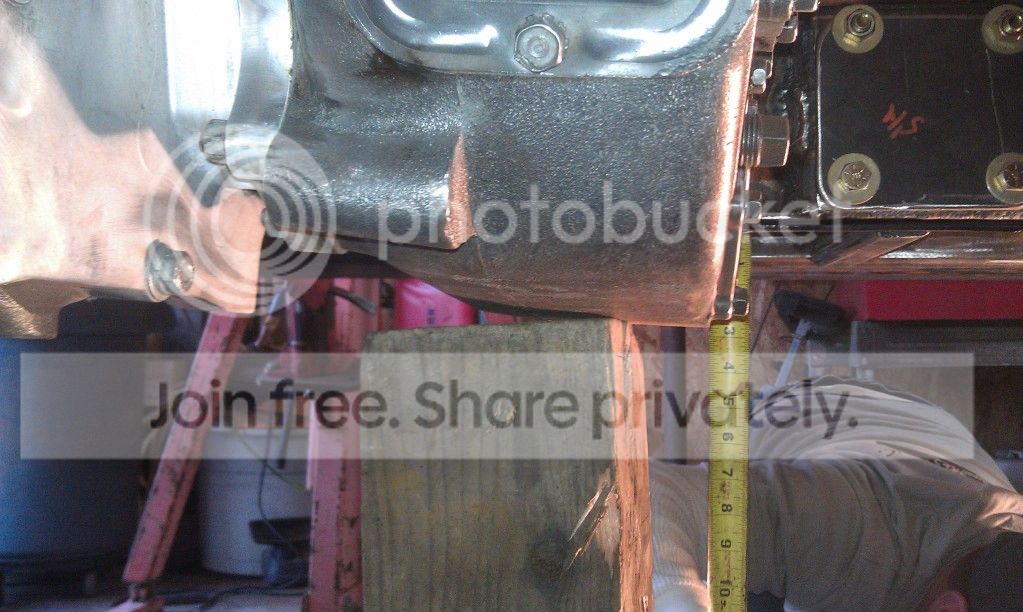

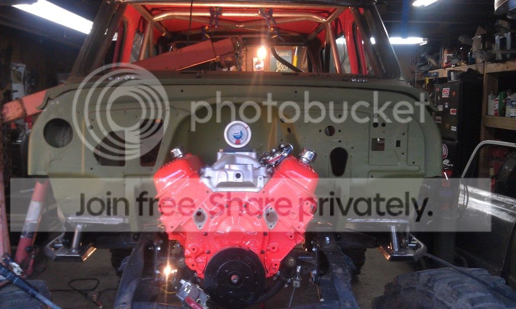

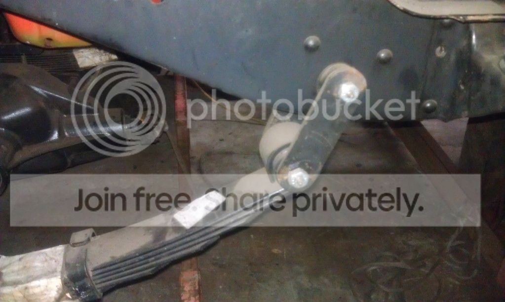

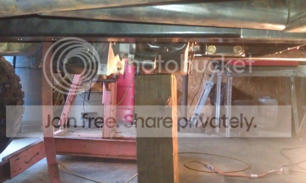

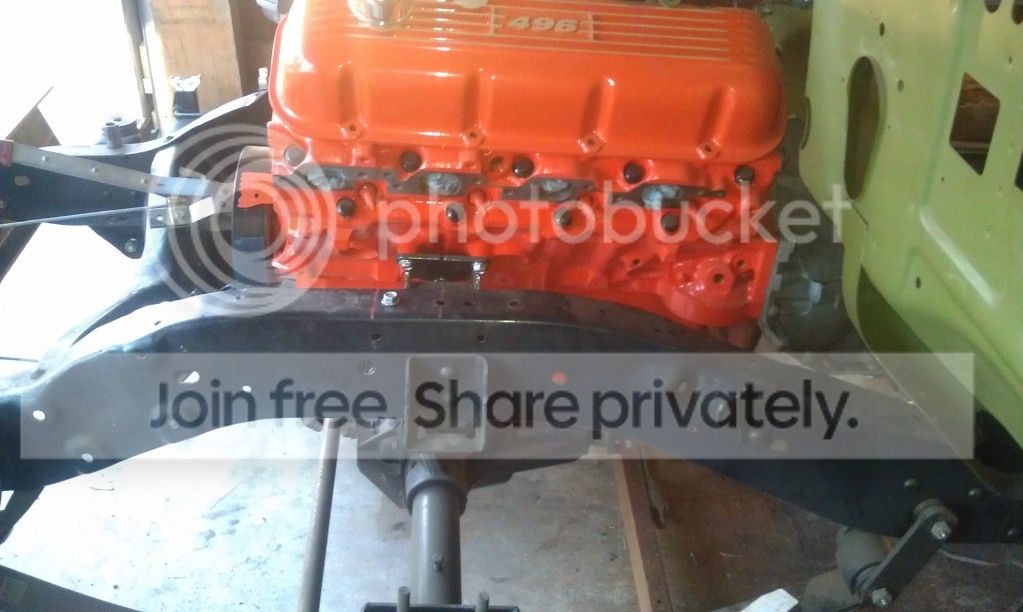

A couple of pics from last night.
Firewall clearance
Over the axle
Belly
Shackle, Granted there is a couple of pounds off at the moment. The hoist has some and I took off the front clip, but it really doesn't move much. :whistle:
OK..... I'm calm now. As you were grasshopper. :)

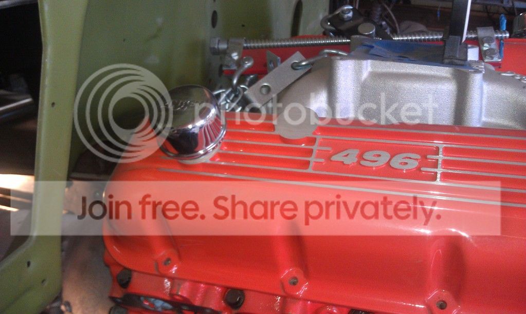

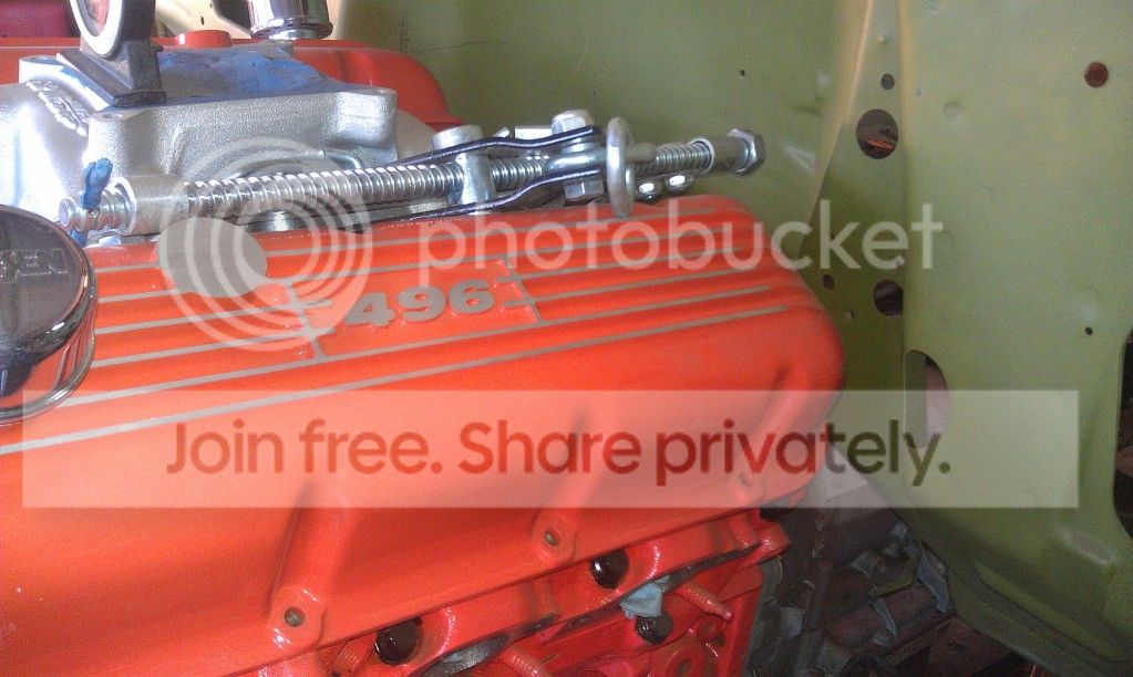

BTW -> That is a seriously beefy throttle linkage you've got there!
-G
Cool, I was reading this on my phone before I left the house this morning and I thought I had really screwed up. Then I realized where I went wrong.
I might as well use that as the throttle linkage. I ordered it from Summit last year and it literally fell apart in my hand. There is a drill bit held on by tape acting as the handle now. I love buying crap...
Sweet, forged stroker crank and roller cam with infinite mileage!
Does that thing have to pass emissions being a 69 vehicle or how does that work for you there? What are you doing for induction?
We are good to go with anything older than 75 here. Full verts FTMFW :D
As far as the induction. I'm going with the K.I.S.S. rule here. I'm not that smart on all of the EFI, TBI, MPFI type stuff. So, the plan is to get a quad from either SMI or Jet. Maybe down the road when I work out all of the other kinks and am truly bored and done enough research I'll try that conquest too.
Until then, it will be a fire breathing, carbed, 496... :woot:

Well if that's the case you could probably unleash some major ponies in that thing by just changing the cam. All the awesome parts in that engine are bottlenecked by that little EFI cam. Since it's a roller you wouldn't need new lifters, and depending on the springs those might be fine too (I'm not talking huge cam), but something a little more aggressive might add approaching 100 hp while still having a nice torque curve. You'd just have to make sure the springs are good, which most hydraulic roller springs are pretty close because the seat pressure and total pressure can't be too high or it will collapse the plunger.
Oh, and by the way, that looks like a Holley flange on that intake, the EZ-EFI would bolt right on! It works great on stroked big blocks, really!
