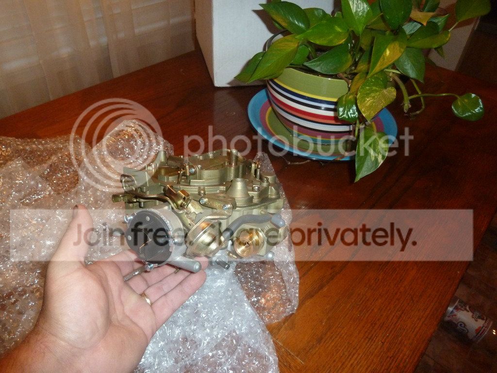

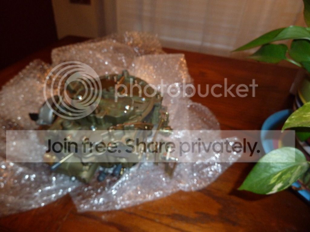

The carb is an SMI 800 cfm stage 2..
http://www.smicarburetor.com/products/sfID1/14/sfID2/9/sfID3/106/productID/858

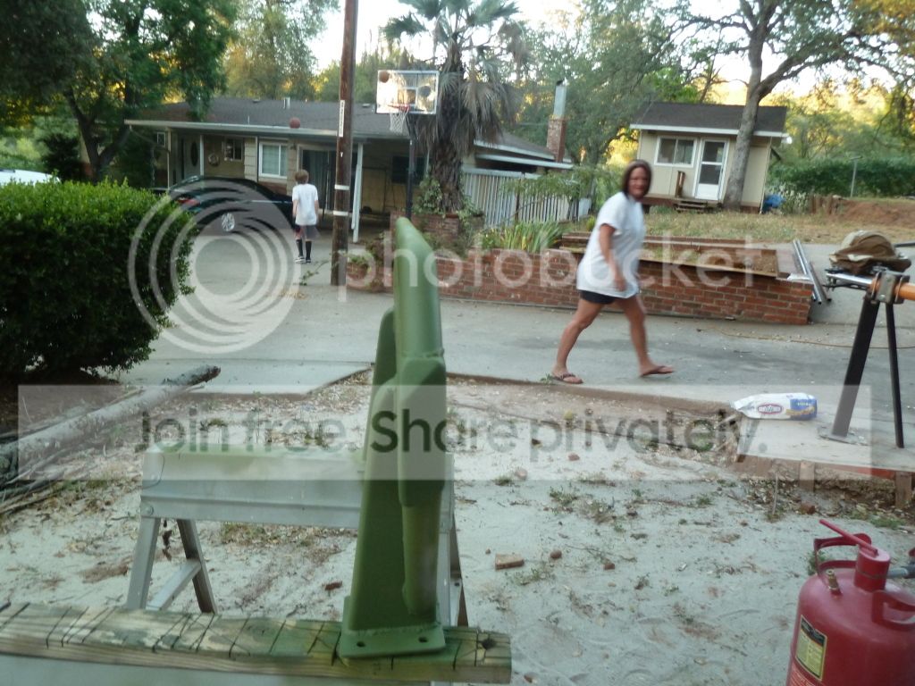

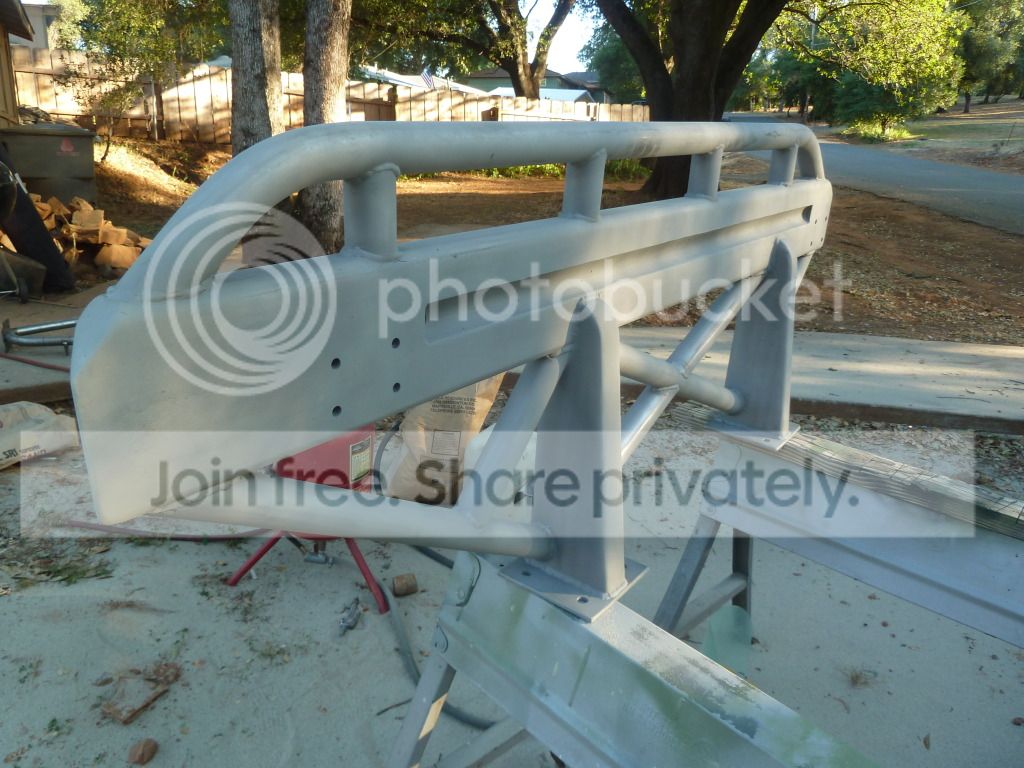

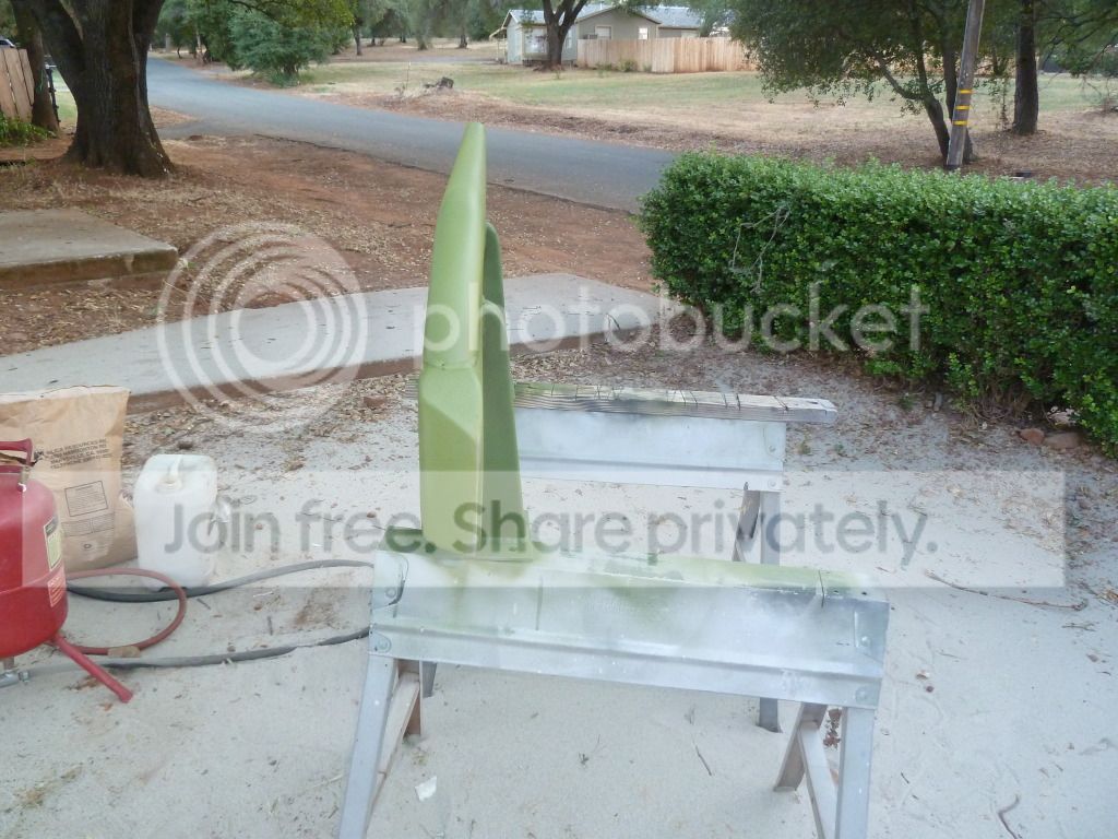

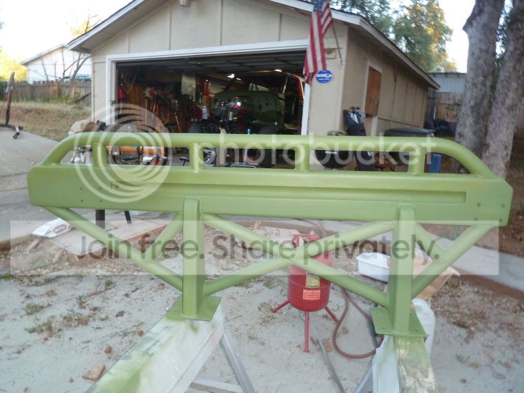

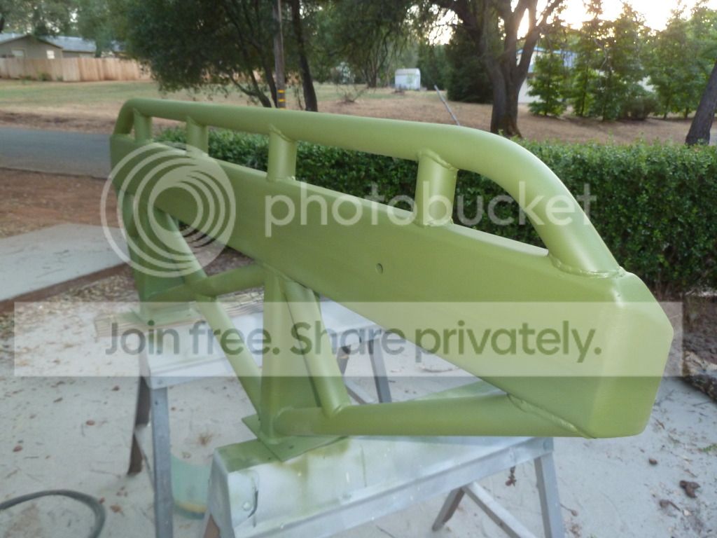

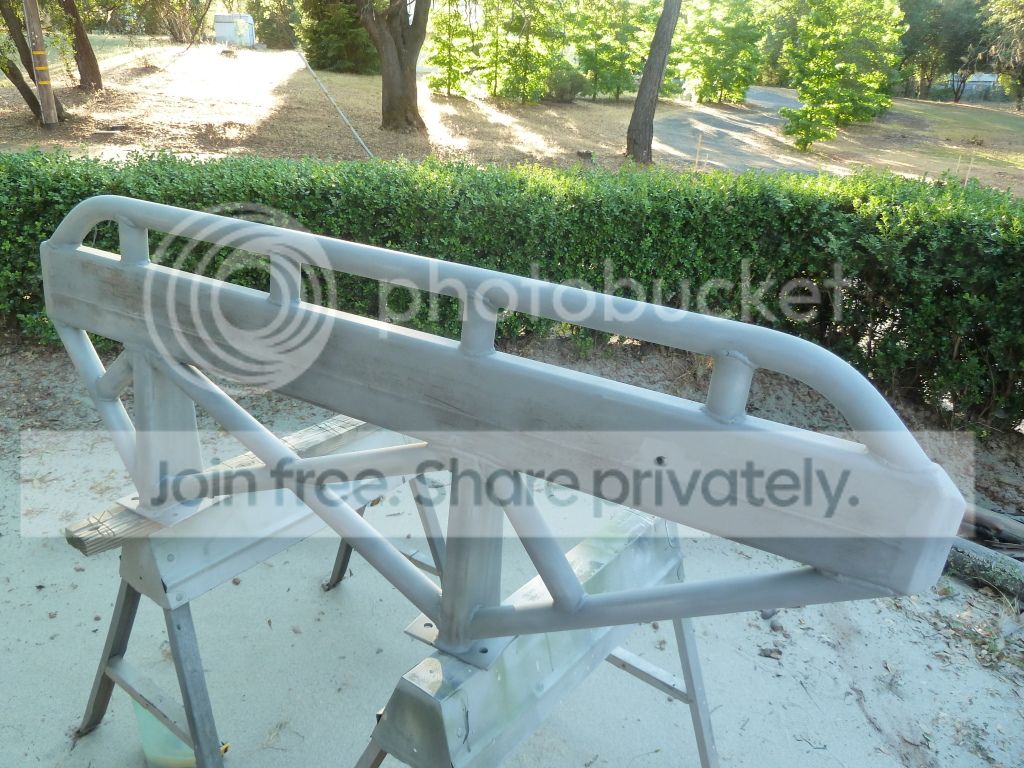

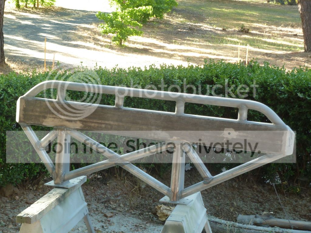

Did a little blasting last night..
Here is my obnoxiously overbuilt slider, cage tie in. Sure wish that I was better at making the welds look "Pretty". I know that they're strong with good penetration, just not the perfect flow to them yet. I guess, just keep on practicing...

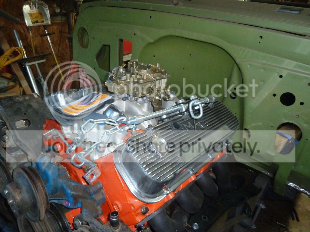

And set this on the block last night. Cool to think that this thing might actually start some day..
Here is what I've come up with so far on the lids. I think that the finned would be a cool match with the VC's. If I could paint them to look the same , I think that it would be alright, alright.... Maybe find one with a bowtie in the fins or something so it's not so plain jane though..
