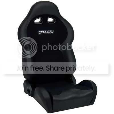

Shoot I look awesome and pretty much always need the wider seats.
Look around to see if you can find somewhere that carries those seats or ask on some boards and see if you can actually sit in them first.
Its something you gotta live with for a very long time. I have sat in some seats that I thought would be awesome that just did not fit my right.
For me it seems like the Corbeau baja ultras are the way to go. With the PRP being a close second, I thought I would like the twisted stitch seat but they don't fit me good for some reason. Beards are the same way just don't quite fit me right. I have been looking for seats for quite a while :D:D
Also I think any modern looking seat kind of looks out of place in a 1st gen but its way more about comfort and really safety than what looks right.
What so ya think of these in a 1st gen. Good, bad.... go kick my own ass???:haha:
In my best Joe Pesci voice..." I'm going with option B....kicking YOUR ass and collecting two-hundred dollahs....". :D
I think the upper part of the seat is just too wide visually, and that's the part that sticks out above the top of the door edge and bedsides when you view the truck from a distance. They make seats called a Baja bucket (or something like that) which is more reminiscent of the original low back seat the truck came with.
Either way, I agree that you should try to find a place to sit in a few of these to see how comfortable they really are... a poorly-fitting seat will ruin your driving experience every time you head out. It's worth the extra effort to find something you REALLY like.

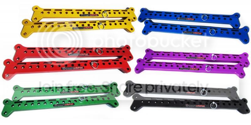

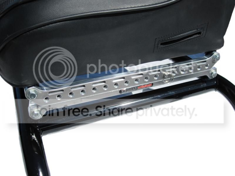

I did find these last night and they look way better than the overpriced ones that you can get from Poly P.
http://www.pirate4x4.com/forum/showthread.php?t=1063437
A couple of those under the front seat, mounted to the seat bars would be nice. That way the wife and kids can drive this.
one thing to keep in mind is how you are going to access the rear seat(s). if you are still planning some sort of flip forward, you'll need to get a pretty low back passenger seat or it will contact the windshield frame before it can get forward enough to be out of the way.

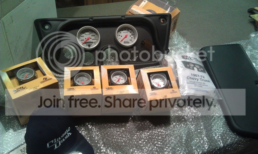

I just checked and your dash has been delivered. Let me know if you need anything else mike.
JJ
Yep, wife said that it was dropped off today. If I could only get off of work to go see it.
Thanks a lot JJ.
Pretty friggin cool, JJ. This is a far as I got tonight putting it together, but it's still worth a pic.
Thanks for the awesome deal and a little swag to boot. :waytogo:
Now if the rest of the stuff gets here, we might have a cool vid by Monday. :woot:
Why you gotta cramp my style????
Looks great huh? You're gonna love those gauges dude:waytogo:
