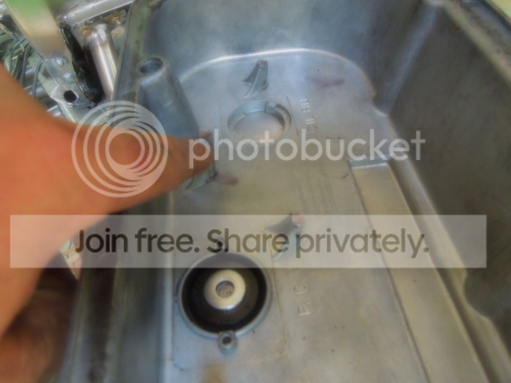

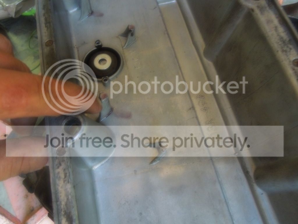

And I think that these are what we were hearing. No marks what so ever. I already had the riser in my hand so they were installed for the time being instead of bringing out the grinder and taking down the tits. They must be for oil or something??

Yeah those are "oil drippers". Basically capturing any oil that is running around on the cover and drips it strategically onto the rockers to give them just a bit more lubrication.
I've seen lots of eBay auctions on old M/T covers where those have been ground down... And very few where they are completely unmolested. That leads me to believe that it's a common clearance issue with high-lift cams/rockers. You're running a rollercam retrofit setup so it's anyone's guess how that might change clearances under there. :thinking:

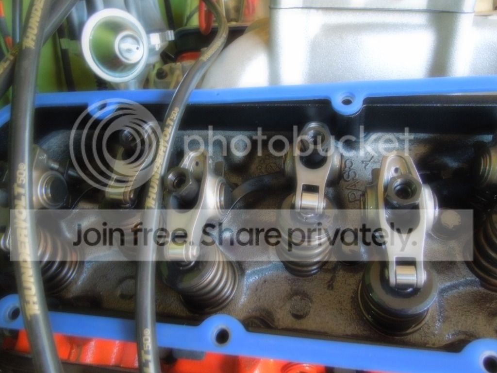

Holy long pushrods batman. It's hard to tell from the picture, but do the roller tips on your rockers travel on the center of the valve stem throughout their travel? Because it looks like your roller tips are toward the outside of the valve stem, that, combined with the fact that your poly locks have almost 3/8" thread above the set screw, makes me think your pushrods are too long. But it could just be the angle of the picture tricking me, and maybe you have longer than stock valves and taller springs on a stock head?? You also might want to check thread engagement. With that much thread sticking up, and subtracting the set screw which is usually 7/16" long or so(same length as the stud diameter), you might not have many threads holding your rockers down. Poly locks are pretty long, so you might be fine, but I would check the rocker geometry and the thread engagement. You should have a minimum of 9 turns of thread engaged for 7/16" of engagement on a 7/16-20 thread.
If you aren't sure yourself, take a picture of the rocker from the front of the engine at rocker level, with the valve open, closed, and halfway open.
If I'm wrong I'm sorry, but I'd rather be safe and sorry than just sorry.
-G
Well, that makes a lot of sense. I'll take the grinder to them next weekend. Currently stuck in Monterey with the wife. She needed to get out of town. I have come to the conclusion that I like Humbolt, hippy greenies a lot better than Southern Prius driving, yuppie greenies. That's all I got for progress for this week. Told the wife, that this confirms why I'm building the rig. To get the hell away from people.
