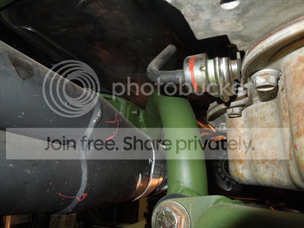

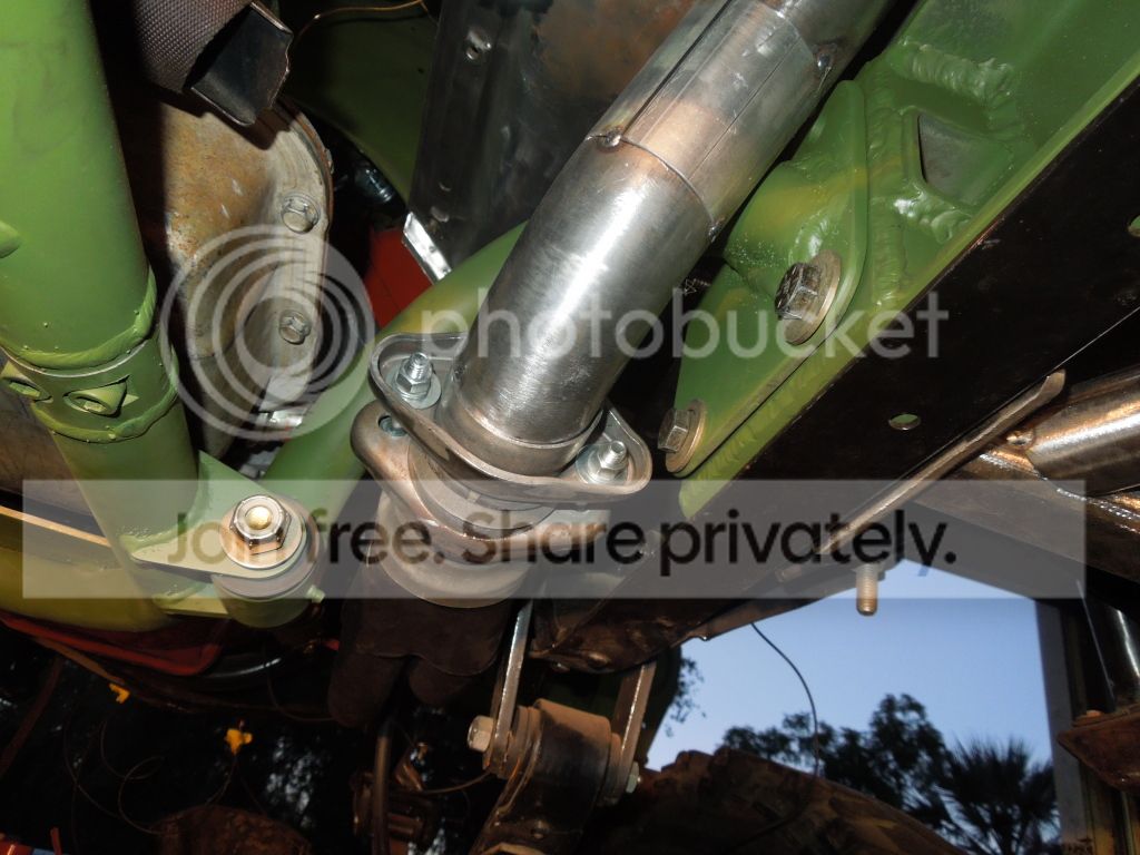

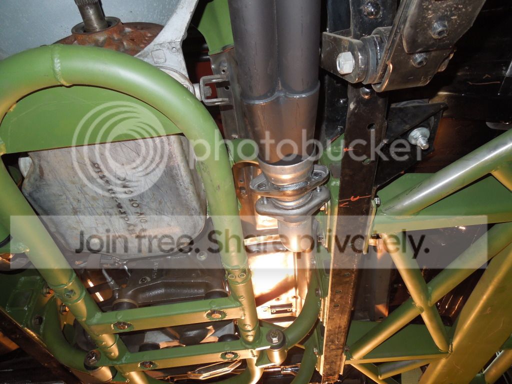

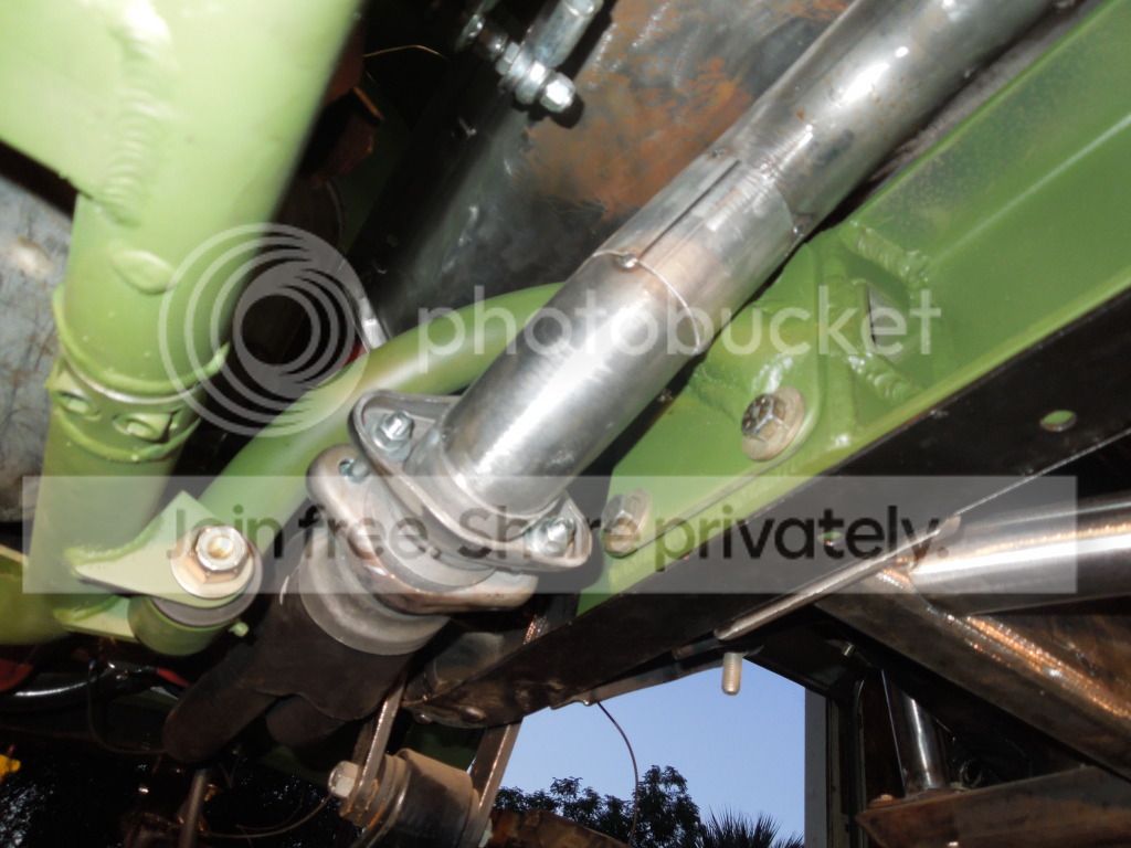

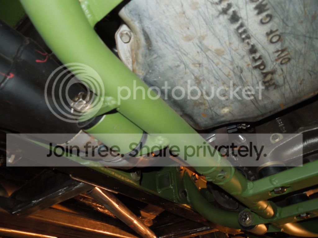

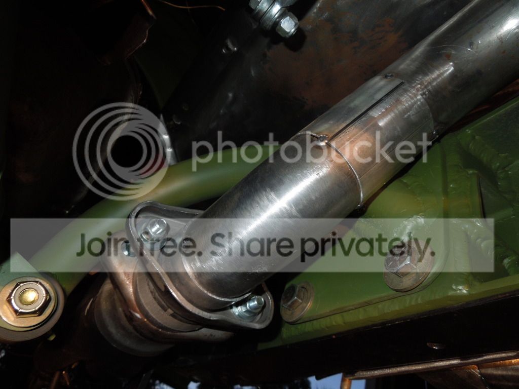

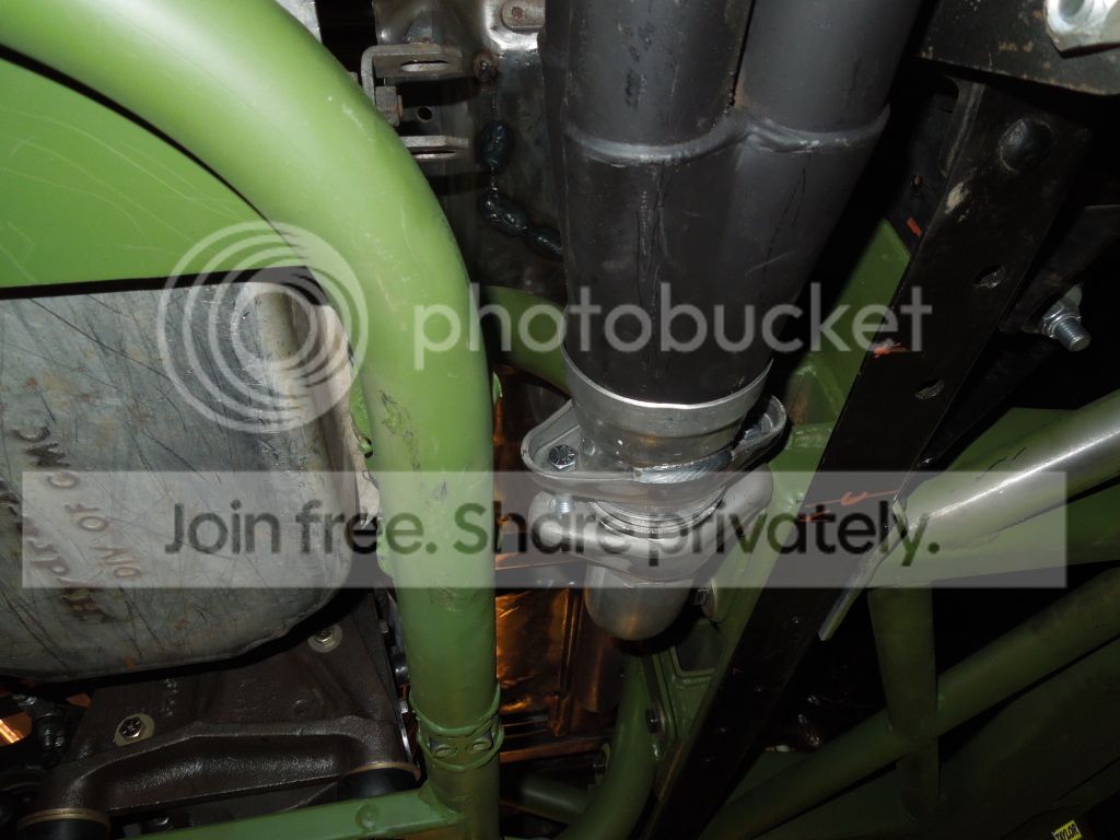

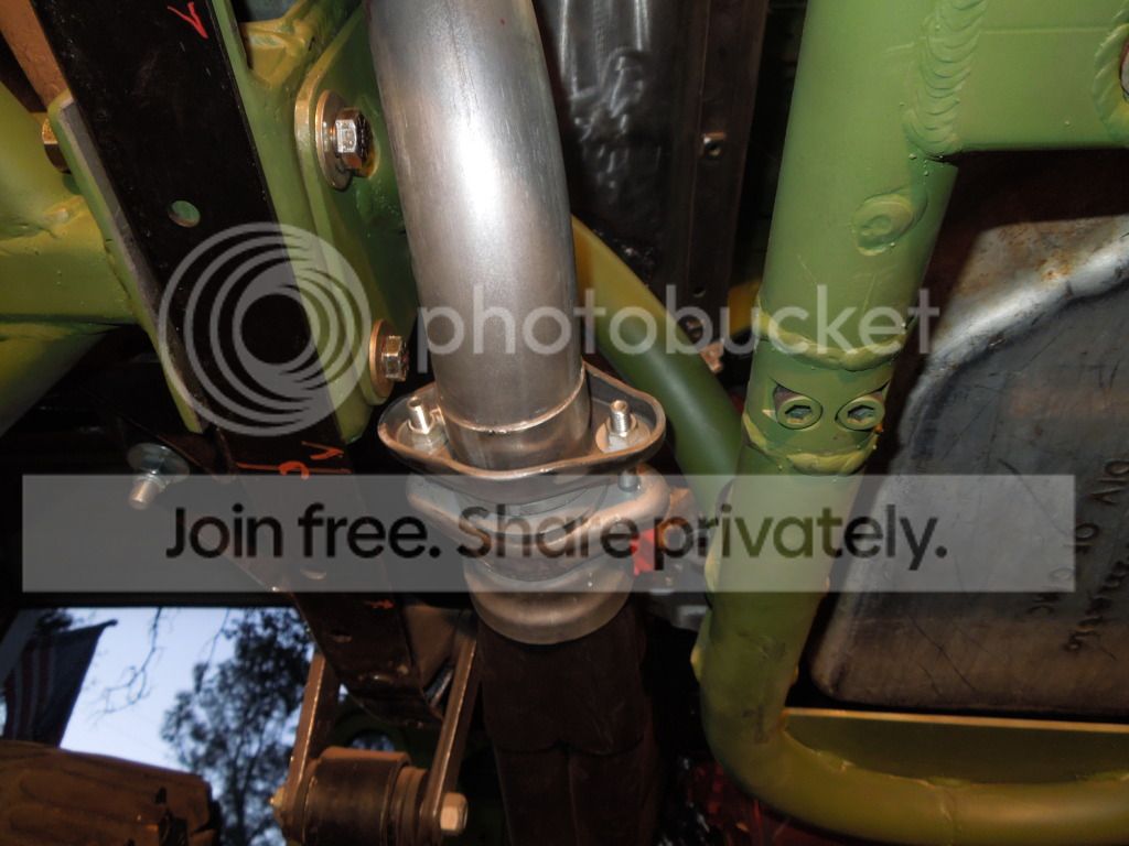

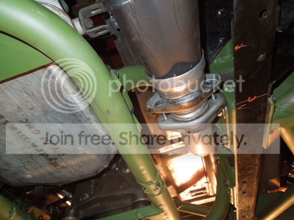

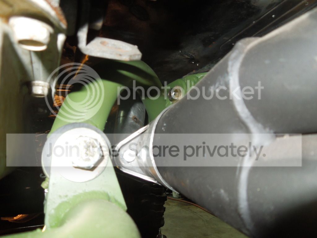

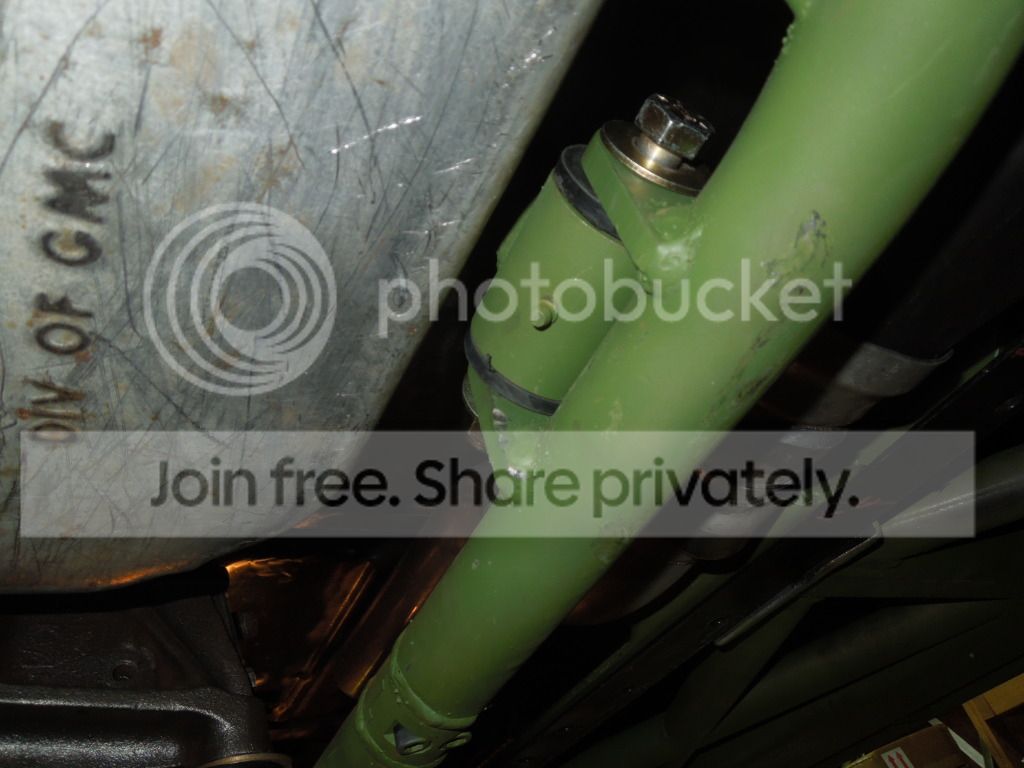

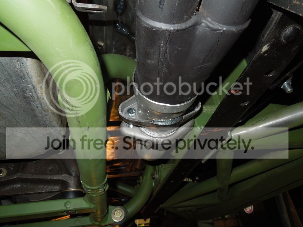

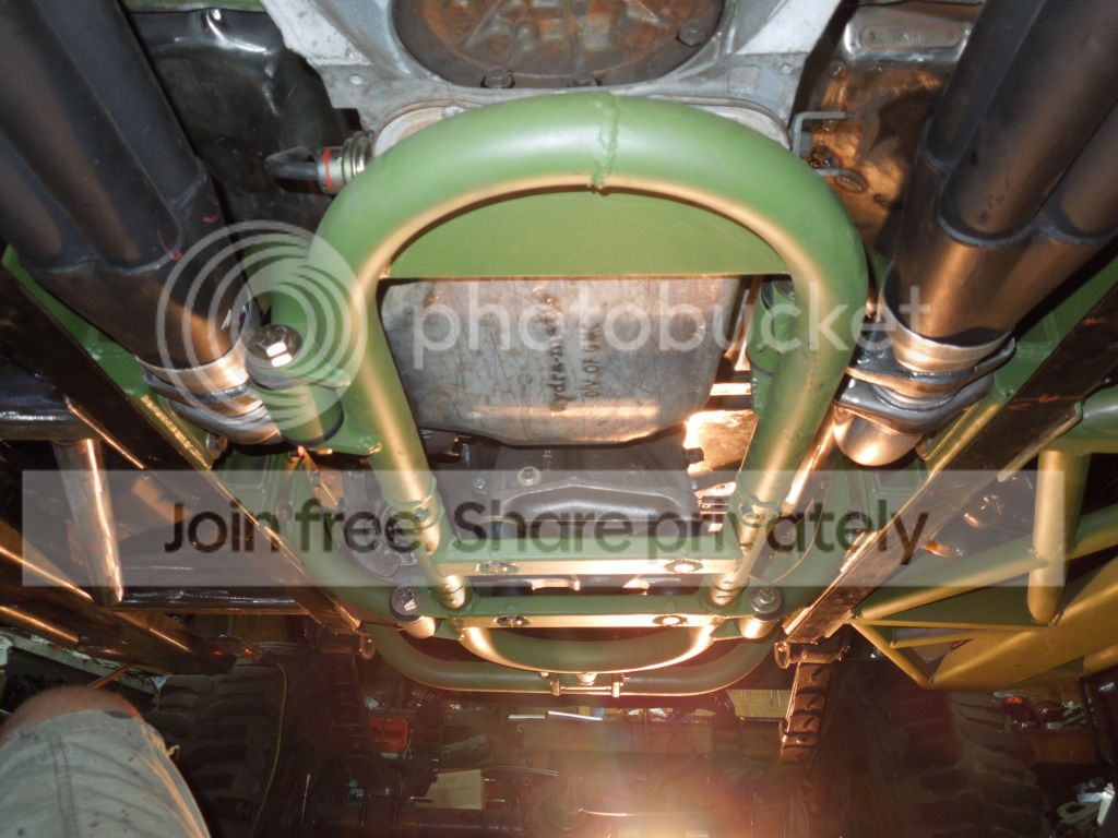

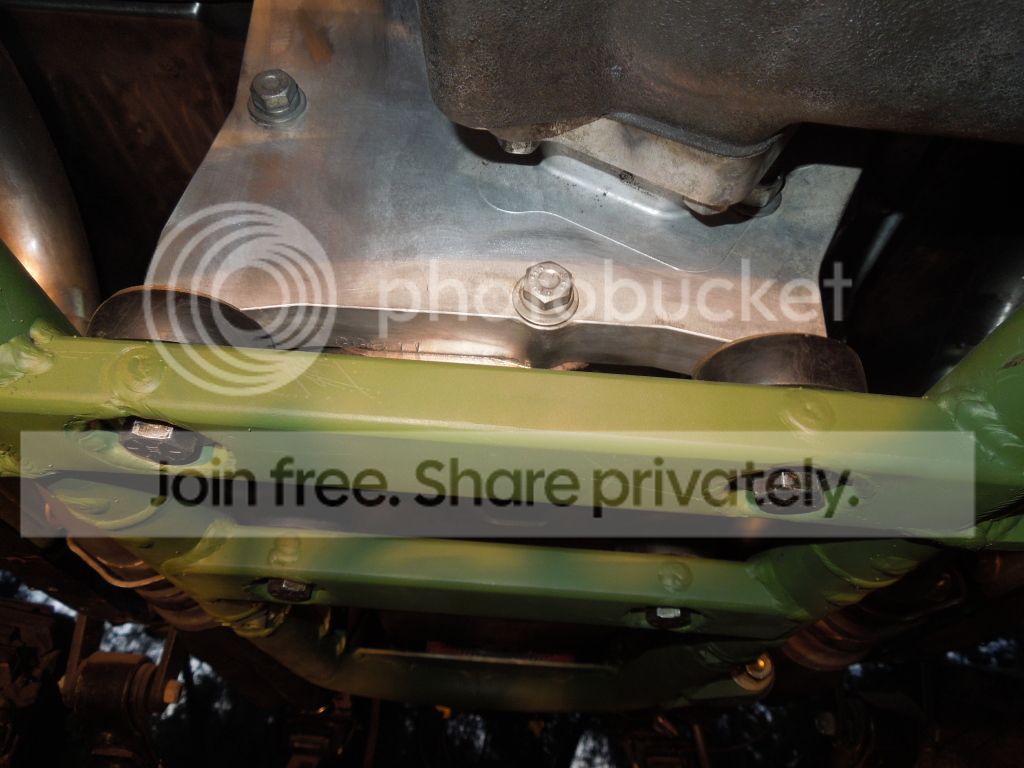

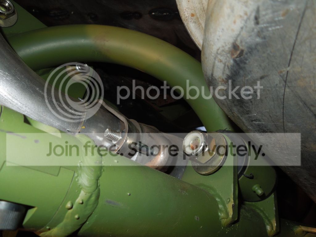

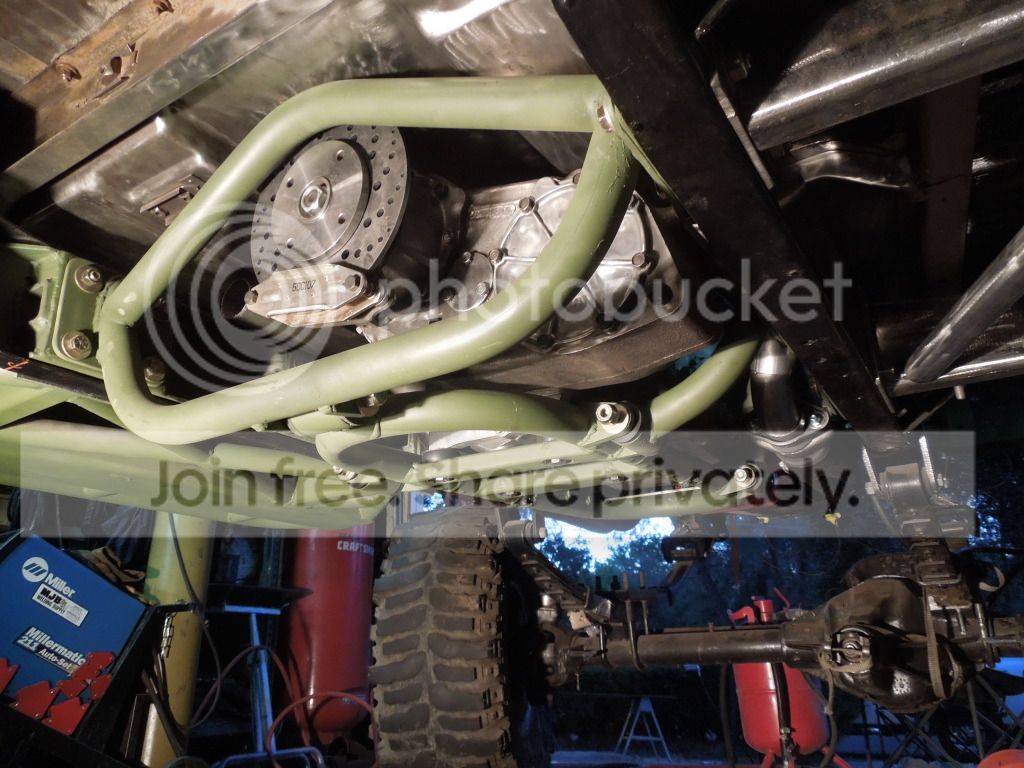

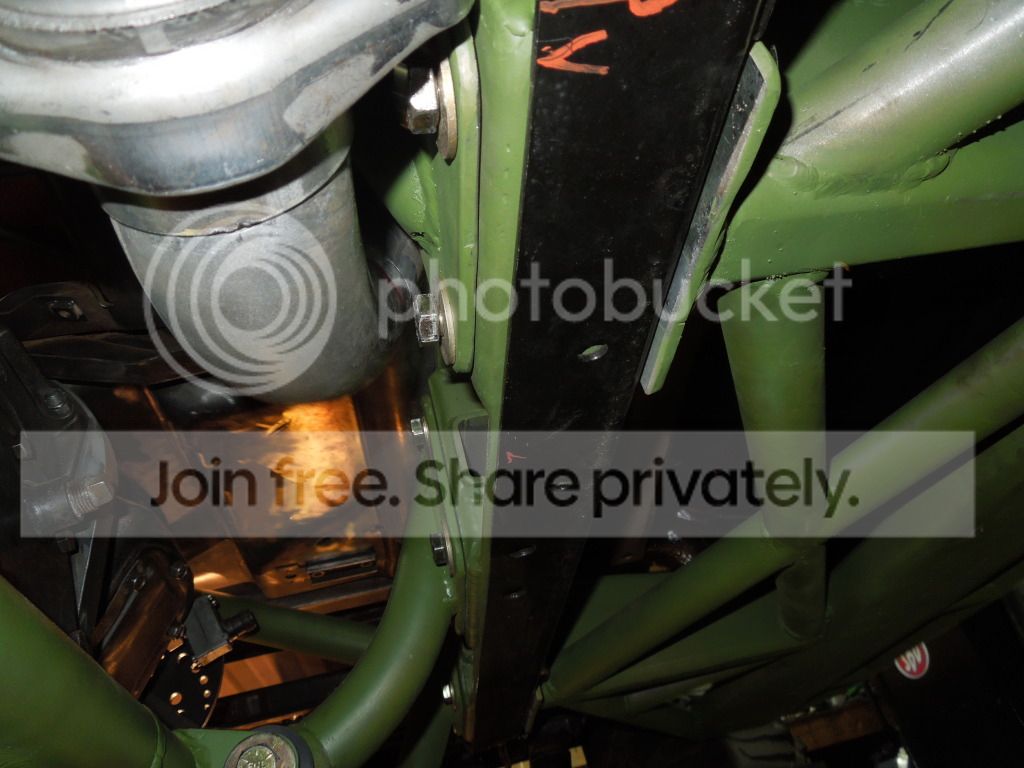

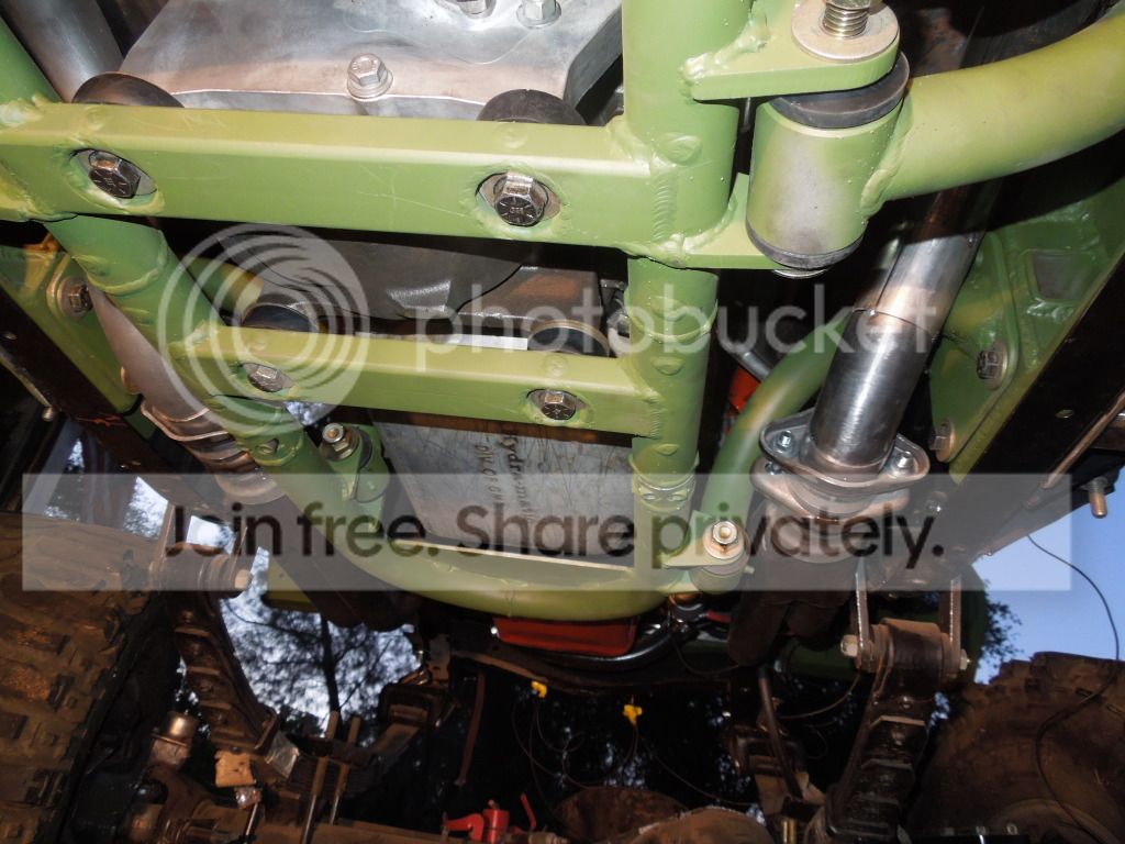

Well, I put on my big boy pants and suffered through the last little bit of install on the doubler mount. It's been so damn hot here, progress has been really slow. This week it's in the 100's with it hitting 106 on Sunday.
I still have a couple of things to do, but they can wait a bit until I take it all apart again. Probably still going to put a couple of strongbacks/backbones on those two tubes that go over the collectors. Cut the plate up at the top of the hoop a little bit to give a little more pan room and a couple of tubes in the back for the crossmember and e-brake.
I even started the tube work on the pass side slider. Things are starting to look up again in the garage. A couple more hours under the rig and then it's onto the shock hoops, engine cage, batt box and so on. Hopefully I get my shocks by the end of the week. I think unwrapping those will give a bit on inspiration to push forward in the engine compartment.
Here are a ton of pics. I forgot to get some before I mounted everything in, so trying to make up for it now. :D
When I take it all apart again, I'll fix up a couple of the welds that don't look so hot. I think up to this point I have about 44 pounds of wire in this thing.

Yeah, I really like you guys, but it just ain't gonna happen. :D Maybe if the cab wasn't on the rig, it would have been better. With it on though, every little massage of the tube required crawling back out from under, over to the workbench, take a nip, then back under. This happened a looooooooot of times. :eek1: With it on, I did get to use every last millimeter of space available with minimal cutting of the cab, so I guess it all worked out. One thing that came out cool is the carb. It sits "Somehow" between .00* and .10*. Not bad for all that went on.
I've been checking in every now and then. Not sure if I posted or not but your imagination came through with your fab skills on that lower mount madness. Looks killer and great work. Coming along nicely
Thanks for the compliment.. :bow:I sure hope that it works out Okay the way it is with all of the fab bushings. If needed, due to too much flex on the drivetrain, I can always run one tube on the drivers side with a bolted flange and lock the entire thing in place. That way it will basically be exactly like the original from GM with the mounts very close together. I'm hoping that I won't need it, but I really haven't seen another one like this so who knows what will happen when I start to flex it out some.
