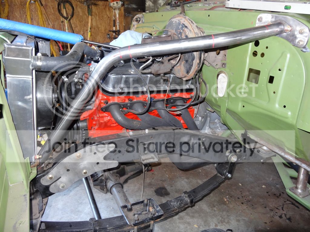

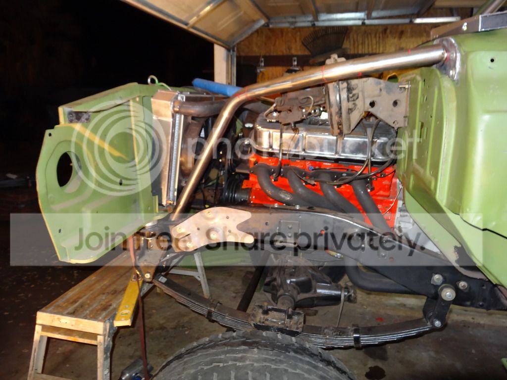

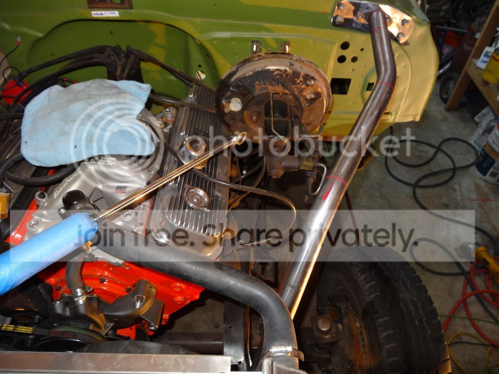

I finished up the through tubes while adding a cage disco in the middle. This now lets me take the entire cage out, back and future front.
I then bent up one of the cage tubes. Still don't know if I like the angle down on it yet. I did kinda figure out that for me to push forward, I need to get the winch between the frame rails. I'd like to do the behind the bumper like VT did his. Still don't know what winch yet. It looks like I have about 24 1/2" to play with.
Not much, but a couple pics

Also was wondering with the engine cage, do you have room for a PS pump to go on the engine with that cage bar where it is?

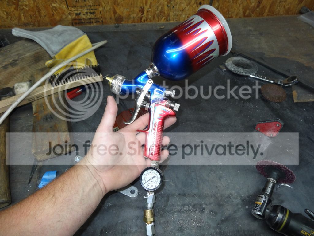

As far as the gun I have Devilbiss GTI with fancy paint. I'm thinkin' the fancy paint should totally help me with a bada$$ paint job on my rig. :haha:
this should help with the HOK paint too...:woot: :rolleyes:
The cage is just kinda sitting there now. The pic might be a little off, but I have tons of room on the side. I need to run it way up in front of the front crossmember though. On the pass side I can't land it on the frame do to the lower rad hose. That's why I'm thinking of building the winch and the lower mounting point all in one.

Mike that gun looks very similar to my Devilbiss....it worked great I thought, but I'm no expert like Paul...I followed the HOK directions on the tech sheets and listened intently to what Jeff at HOK had to say....here is the list, but mine was 3 colors with taping and Kandy to boot:

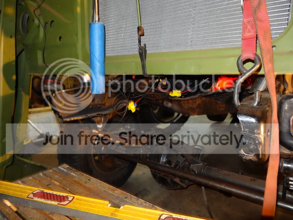

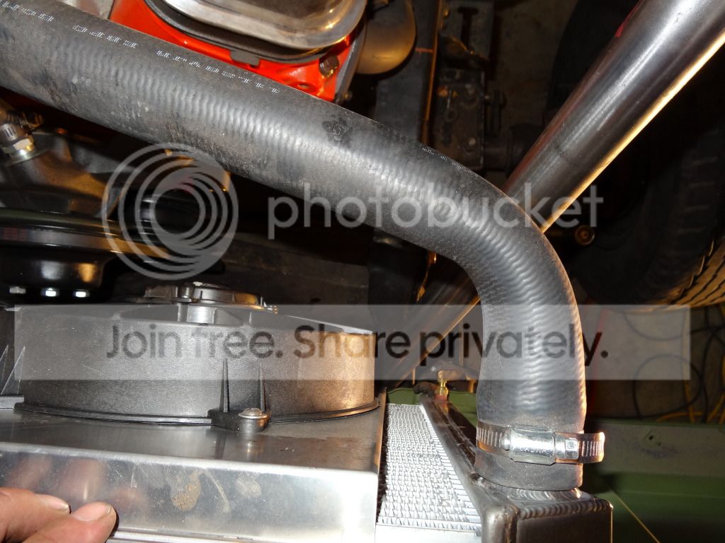

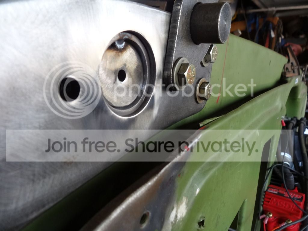

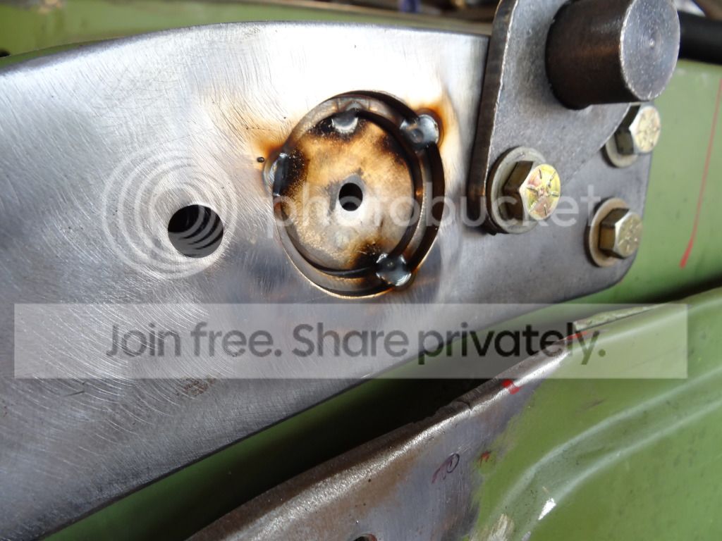

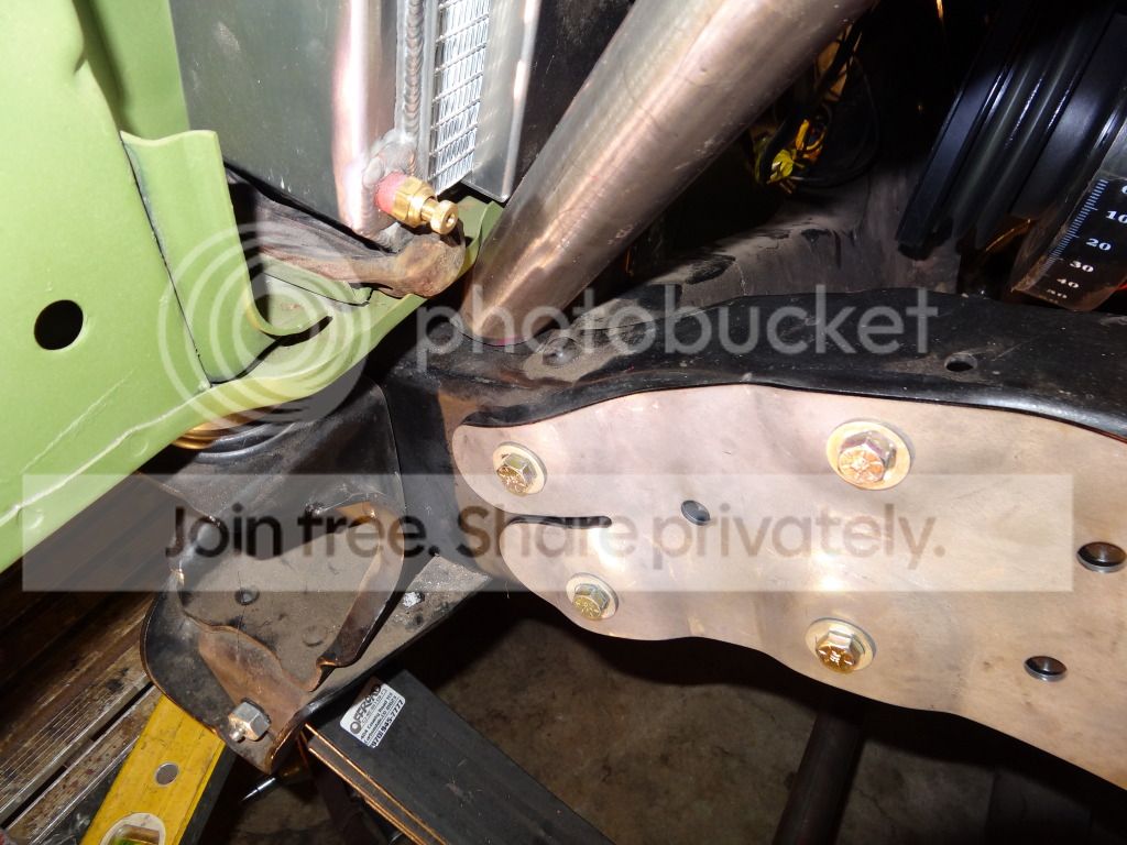

So, I can't sit inside and just watch it all on TV, I have the computer out in the garage, getting the report out here. Took a couple of pics, of the front again.
All in all, it's a good night of making my way around the rig, lookin' at it and coming up with some good thoughts.
Here are those pics..
Where I want the winch..
This should move off the frame to a "structure" around the front of the CM/ winch area, and still be removable.
Seems to be working out nicely...Looks great! :thumb:
