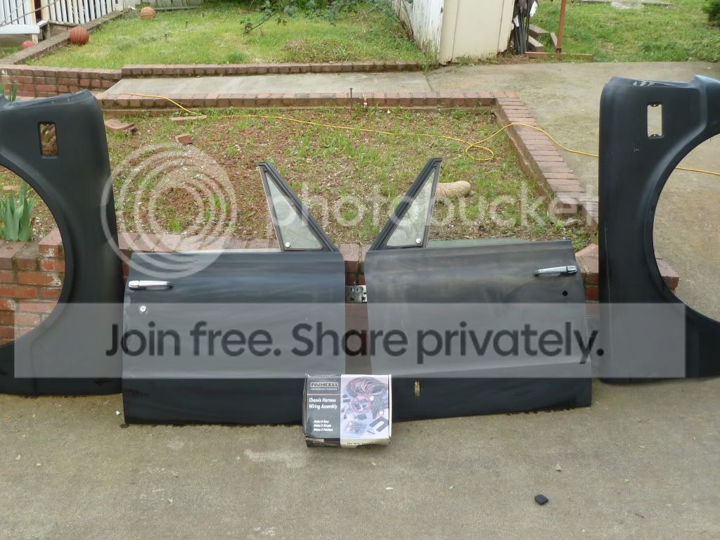

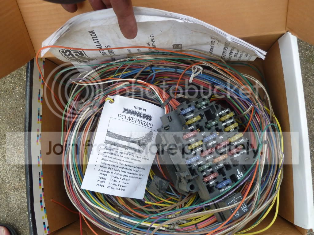

Was up late last night checking on prices for some new doors and fenders. Had the order all made with shipping and it would have been just under $1400.00. I held off and checked C-list one more time, this time checking the bay area. Found an add for a guy selling a lot of stuff off his blazer before he finished it. I guess that he had not touched the project since 08. I think that he jumped in head first with ordering a ton of new parts and panels before he realized how much rust repair he had in store for him.
Anyways, these doors were installed with the fenders and sat on his rusty rig for the last 3 years or so. I talked to him last night about picking them up this weekend. Well, I couldn't sleep at all last night with the thought of them being gone by the time I got there. I think that he was surprised with my call at 7:30 this morning telling him I'm an hour into my drive and I'd see him at 9:00.
The great thing about this is, I ended up getting two new doors, two new fenders and a new painless wiring harness for $550.00.:saweet:

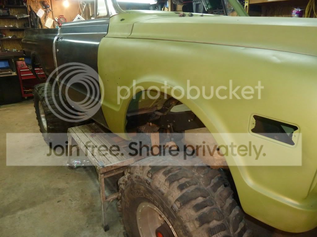

After blasting the new fenders and getting them green, I hung them with my fingers crossed. Amazingly they worked even better than the originals. So, I have been trying to get all of gaps where I want them and it has been kinda kicking my ass. I have everything really close, but I know I'm still a weekend away from having a beer in my hand, looking at the truck going, Yeah, that's it.

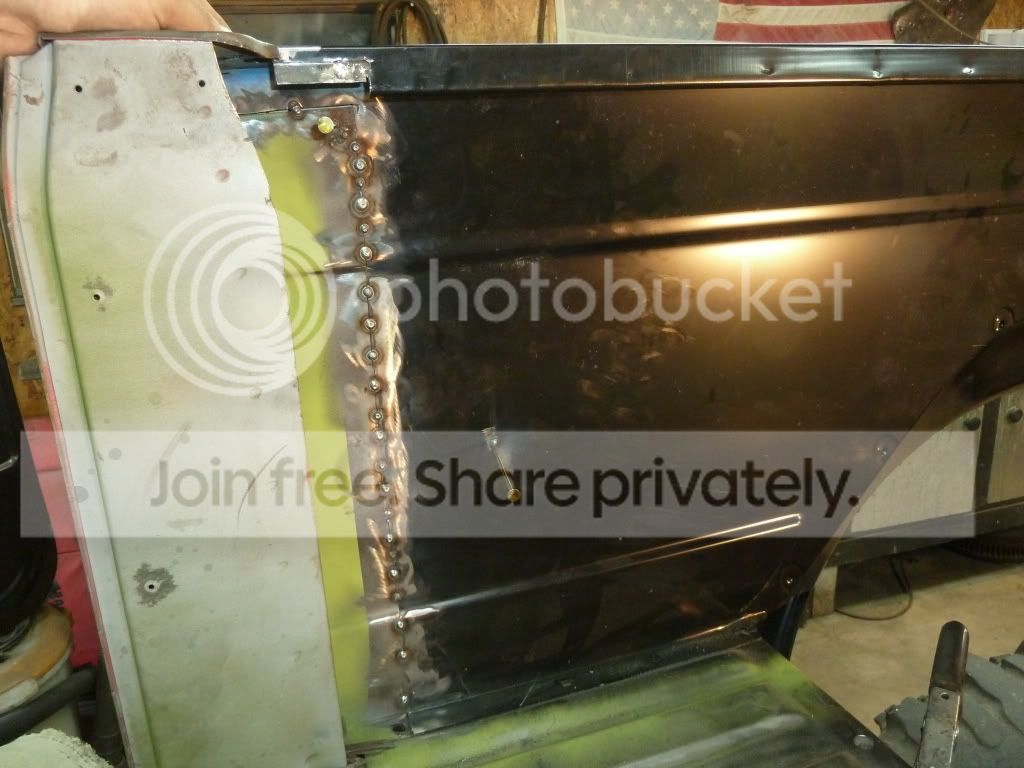

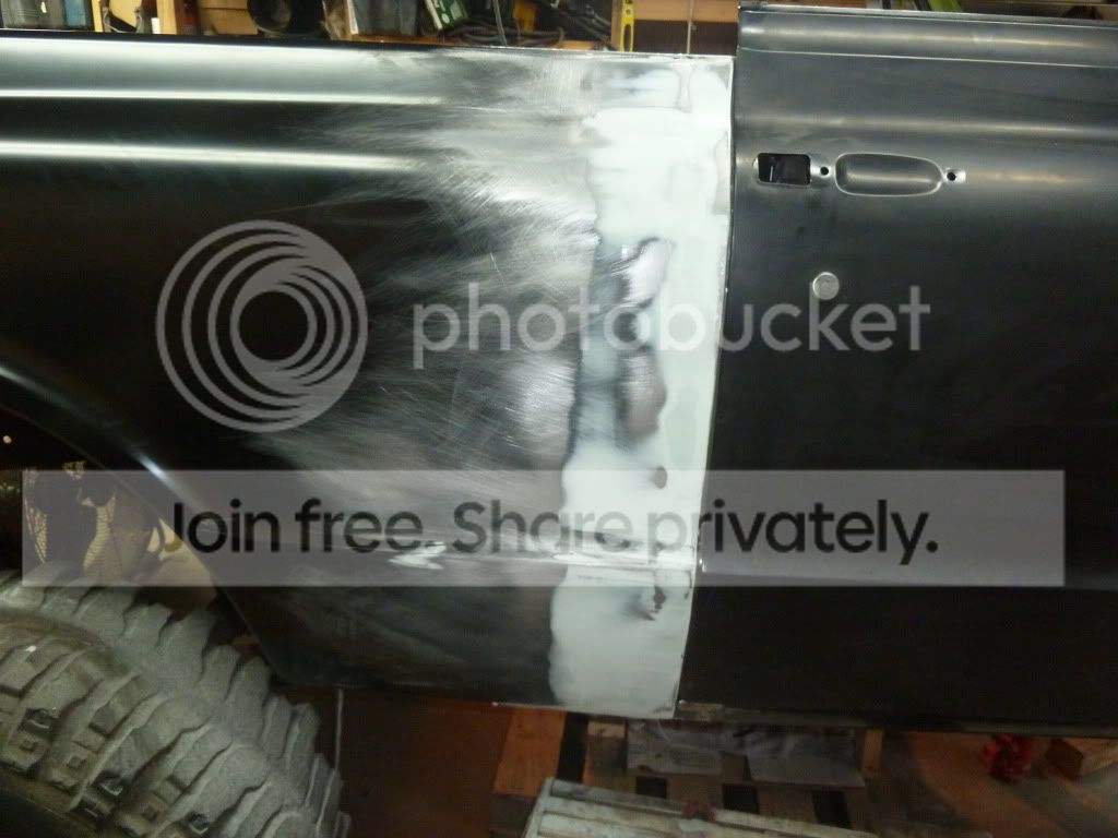

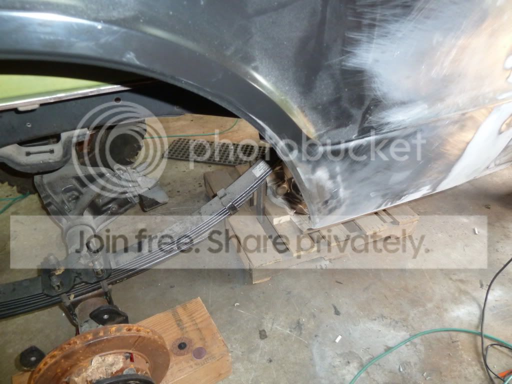

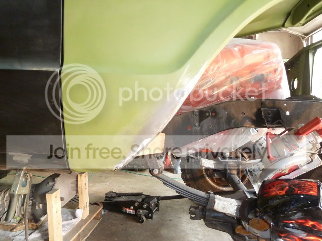

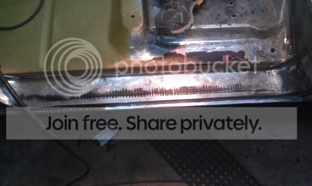

Getting really close with the new quarter panel. I ended up putting a little mud on to see if all was going to come out ok. Still have a bunch of blocking, but I think that it will end up working ok. Probably should have used a little duraglass, with reading the Rust Bullet thread. The thing is the panel and welds came out really flat. I had only one area that got a little hot towards the top, but over all I don't think that there is going to be to a lot of filler when I'm all done.
The inside I still have some more welds to go along with my favorite part, grinding.

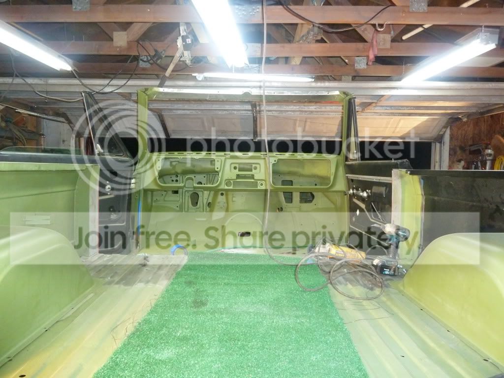

I did end up finally getting the rest of the dash in green. I don't know what took me so long just one of those things, I guess. I wish I would have done it the first time, when I had it done. Had to clean it all again to make sure that there was no surface rust on it.

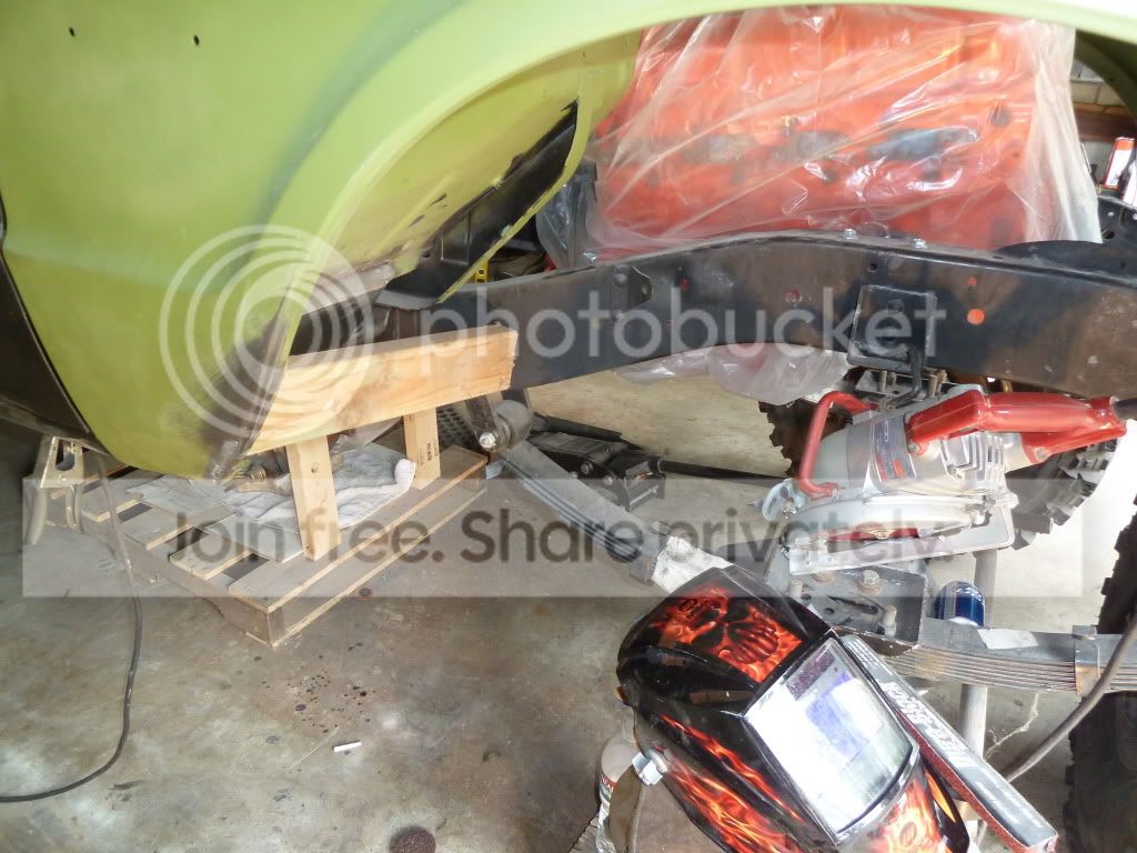

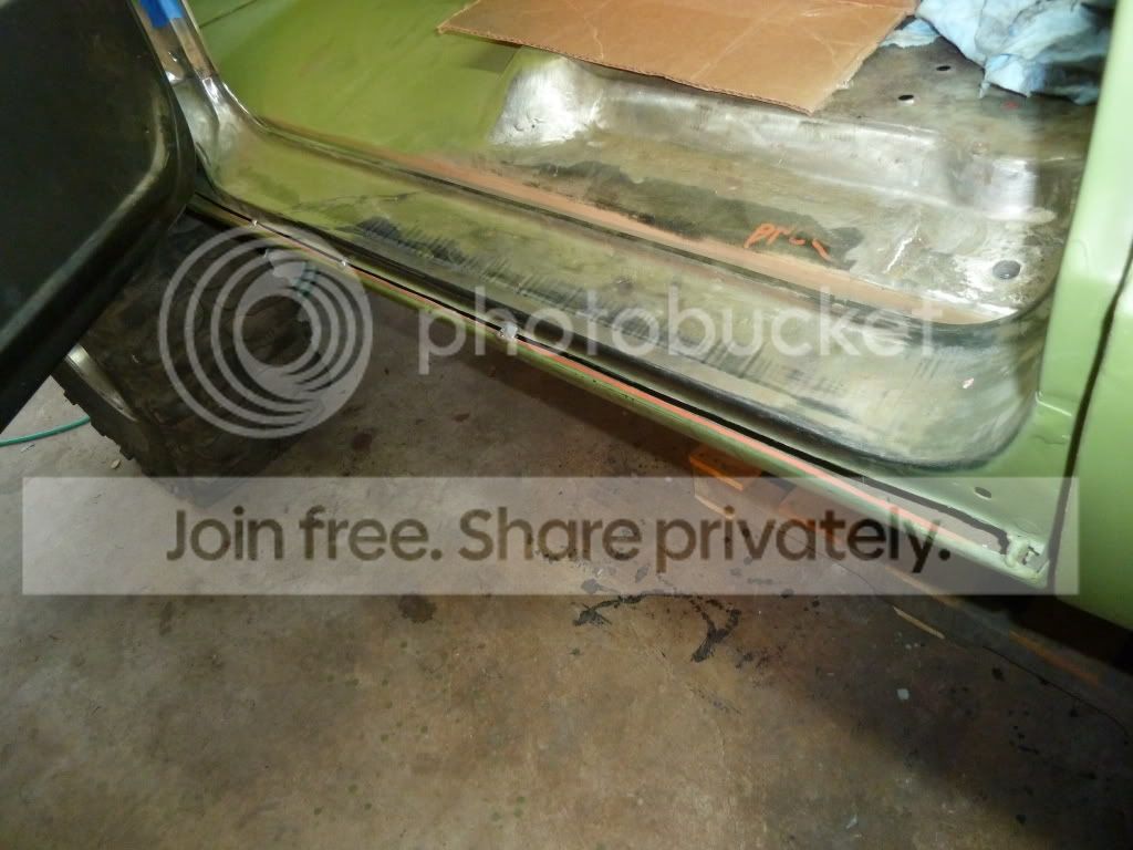

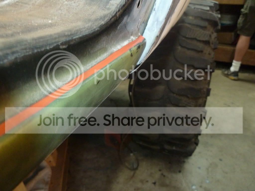

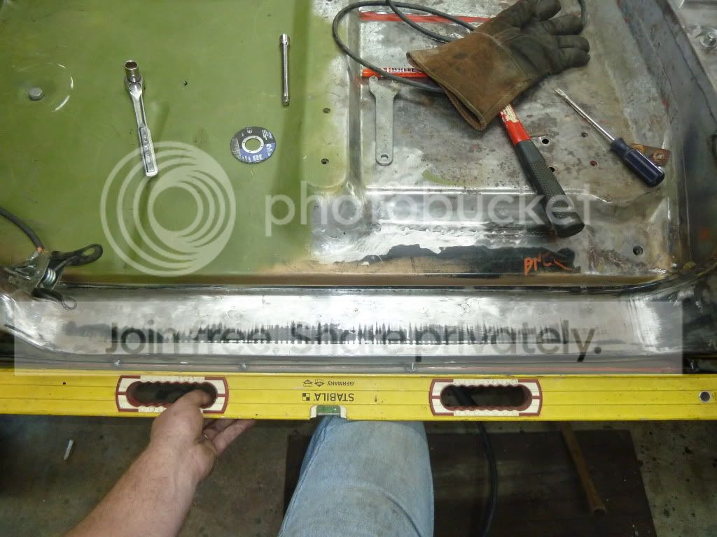

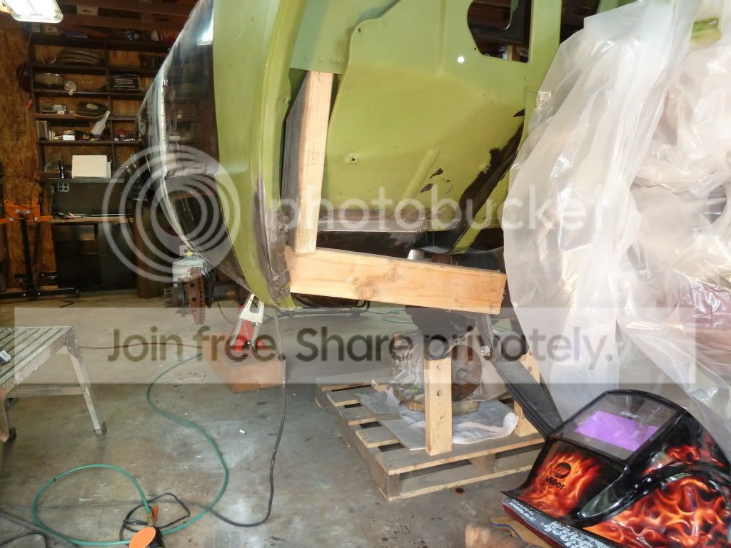

Moved over to my outer rockers one day. These things have been on my sh!t list since I installed them. They just never came out far enough to sit flush with the bottom of the door, fender or quarter. Now that I have them where I wanted, it was time to fix them. Still have not finished, but they are going to come out alright.

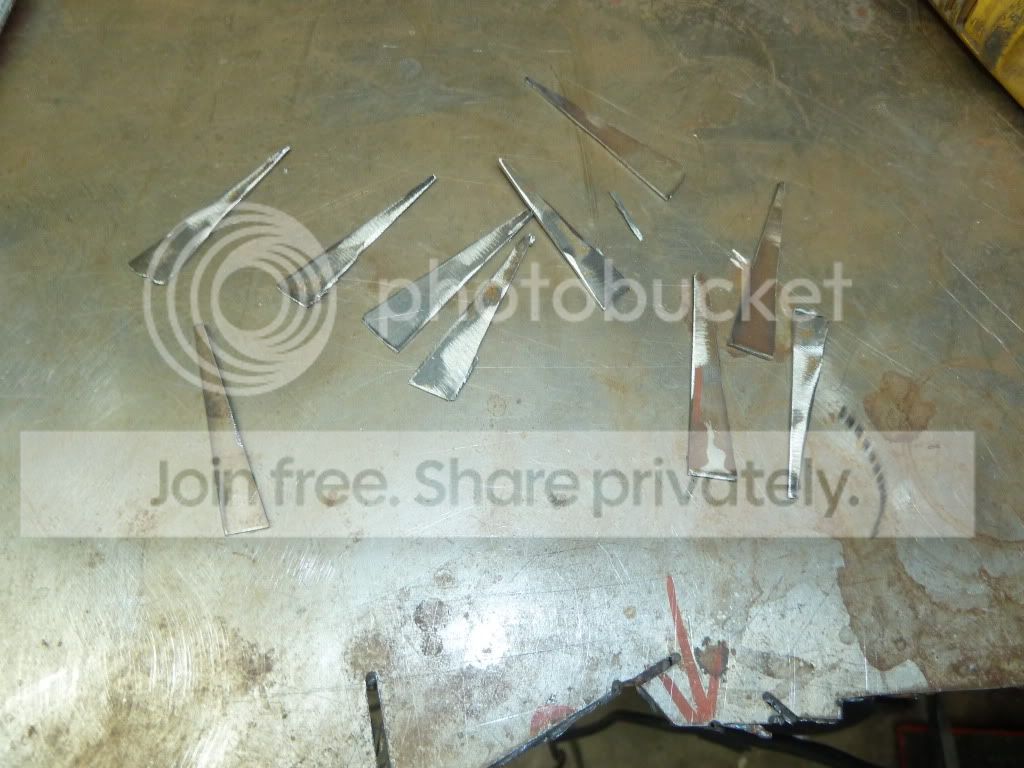

Cut some shims to push it out.
Getting it even with the other panels.

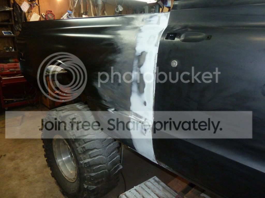

Couple of side shots.

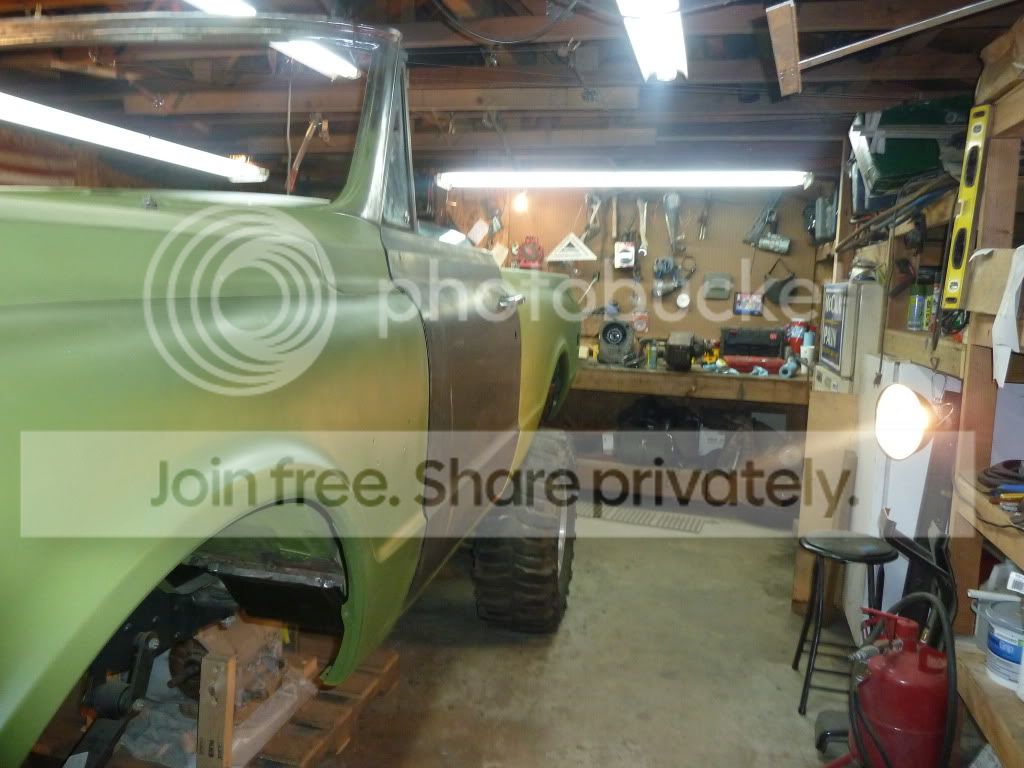

A little progress this weekend. My camera had to go into the shop, so some of these in the beginning are with my phone.

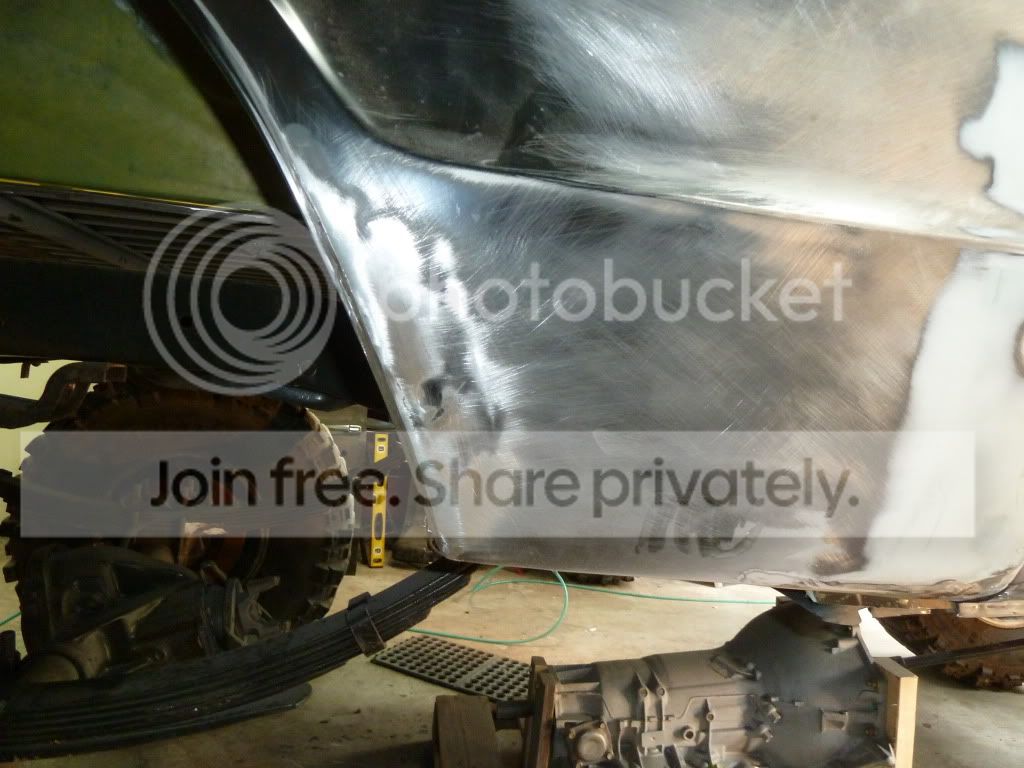

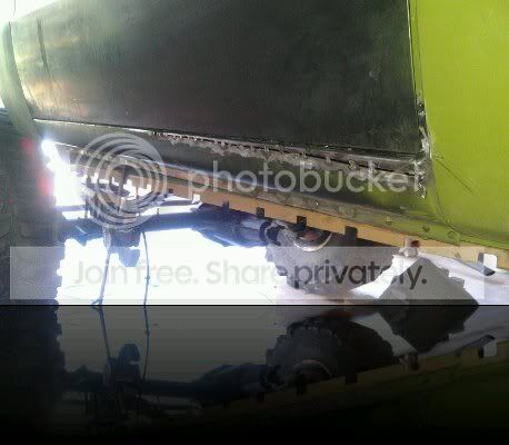

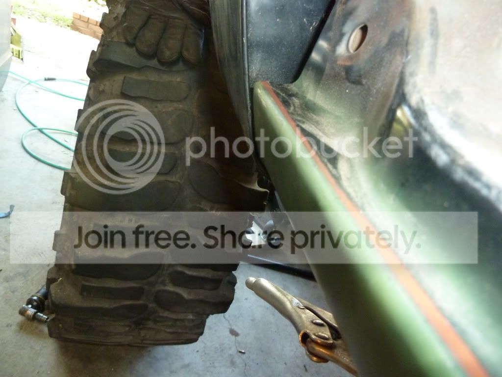

Finished up the drivers rocker. I really had to slice and dice this thing to make it work, but came out pretty nice. Don't think that I have a finished pic but here are a couple of the progress.

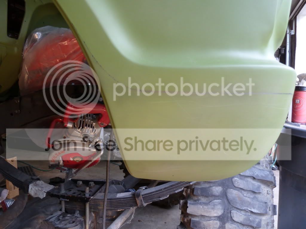

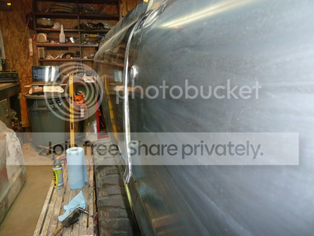

Ended up working on some more trimming this weekend. I have both the pass side front quarter and the back portion of the pass side fender about 85% done. Still need to do some more dolly work to both, but here are the pics so far.
Back quarter
And the front. I'm really trying to keep with the flow of the body lines.
Working my way down.
The side view, "Money Shot" :rolleyes:. Still need to finish up the bottom and decide if I can bang out the dent or if I'm going to replace it.

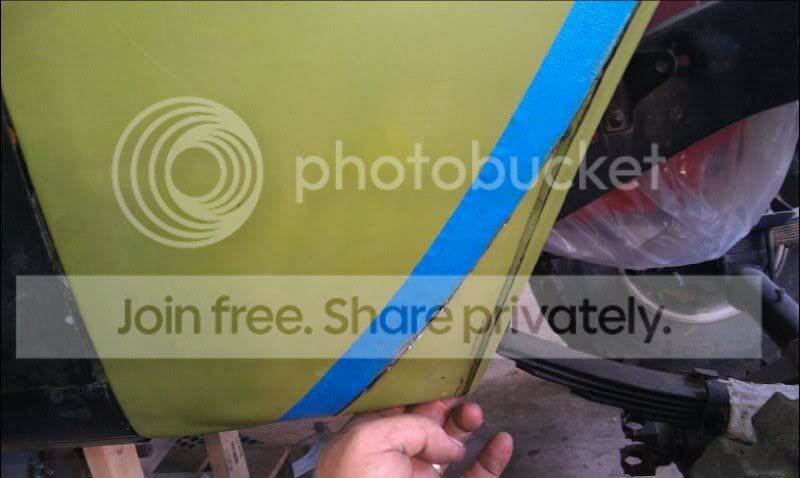

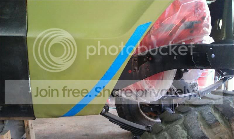

Here is what I'm thinking for the front fang. Have not cut yet, but the idea is to bring the "lip" all the way around on the bottom to the front of the rig. You guys think that will look like it's to much or will it give it a nice finished look?
not that I'm any sort of expert on the subject, but I think your work is fantastic! your attention to detail is amazing.
I am very impressed with the way you are keeping the lip on the fenders even with your cutouts.
