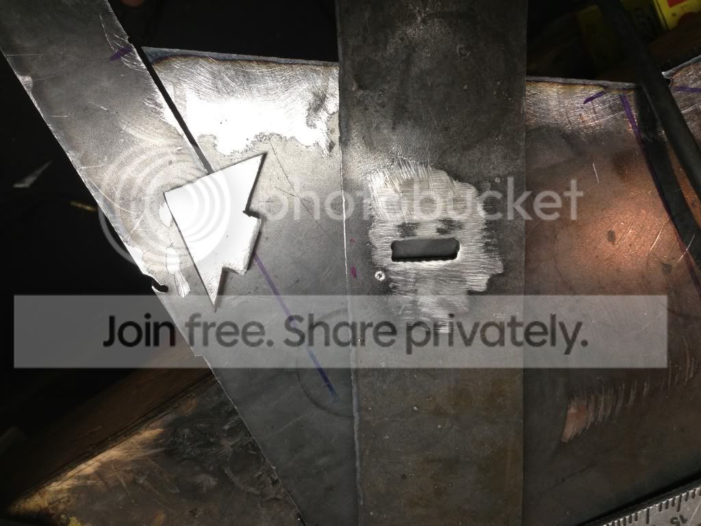

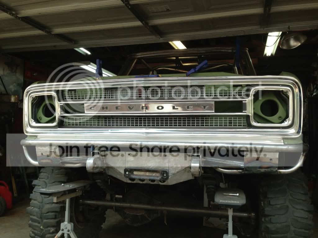

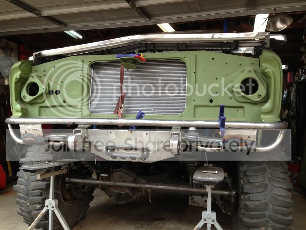

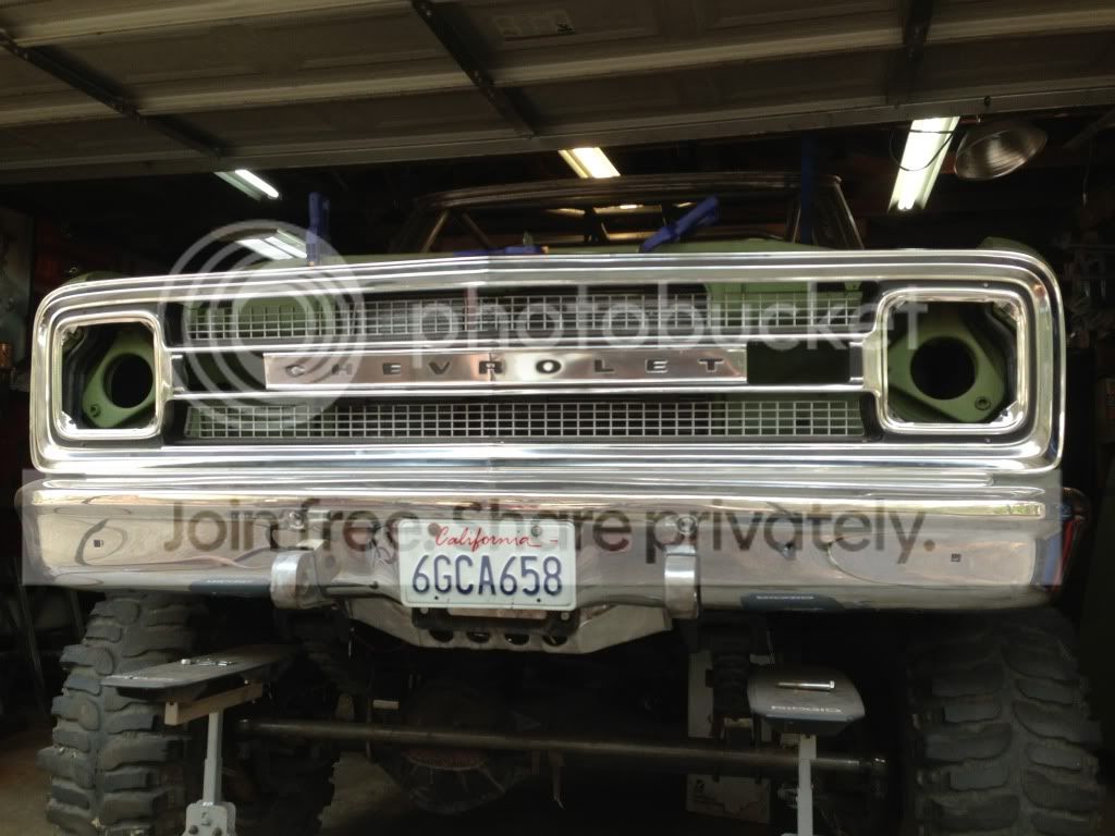

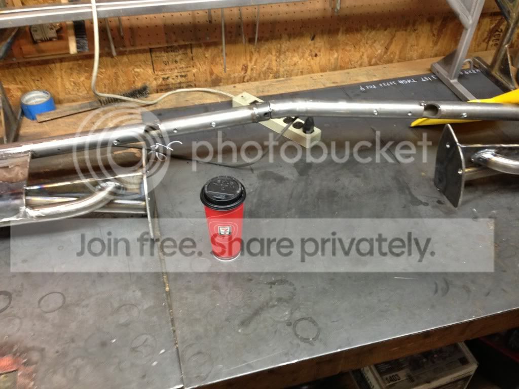

Ended up stealing a couple hours in the garage yesterday. Did a lot more welding on the front tube bumper. You can see that I brought up the front plates to the bottom of the top tube. I also closed off the ends and cleaned up some of the splatter.
The rest of the day was figuring out the winch fairlead opening and what it will involve. I actually only moved forward on this by cutting out another 1/4" plate that will sit in front of the winch feet. Now that piece is 1/2" thick, and I shouldn't need to worry about any bending with just the 1/4". I will need to make a 2" bump out, tunnel...(don't know what else to call it?) so the fairlead will just sit in front of the bottom lip on the bumper.
Unusual for me, but I didn't take a lot of pics yesterday. Just the couple that I shot over to Greg during the day. Remember everything is still loose in the pics, (Fairlead, bumper, etc) but you can get an idea of where I'm heading finally.
Morning coffee and a tube disconnect in the top tube.
Welded up.
With the grill on..
and the front skin.
This really should give me a nice platform to work off of now for the fairlead.

That's sooo sexy! Nice work dude!!!
Damn that's nice work Mike. Driver side front bogger is on the wrong side of the truck. LOL.

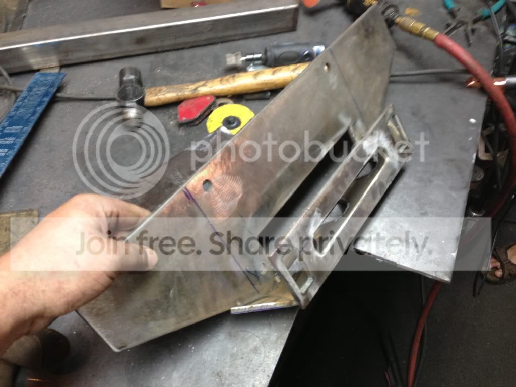

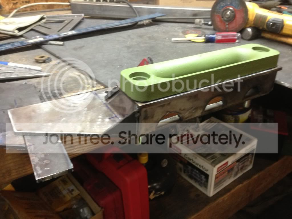

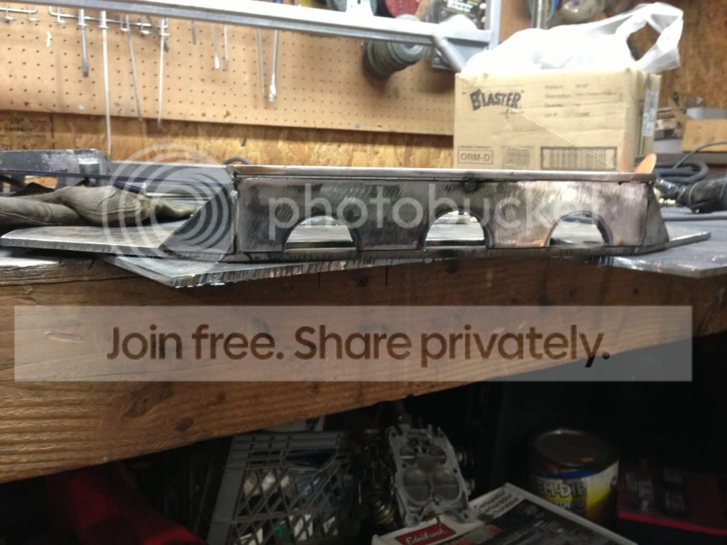

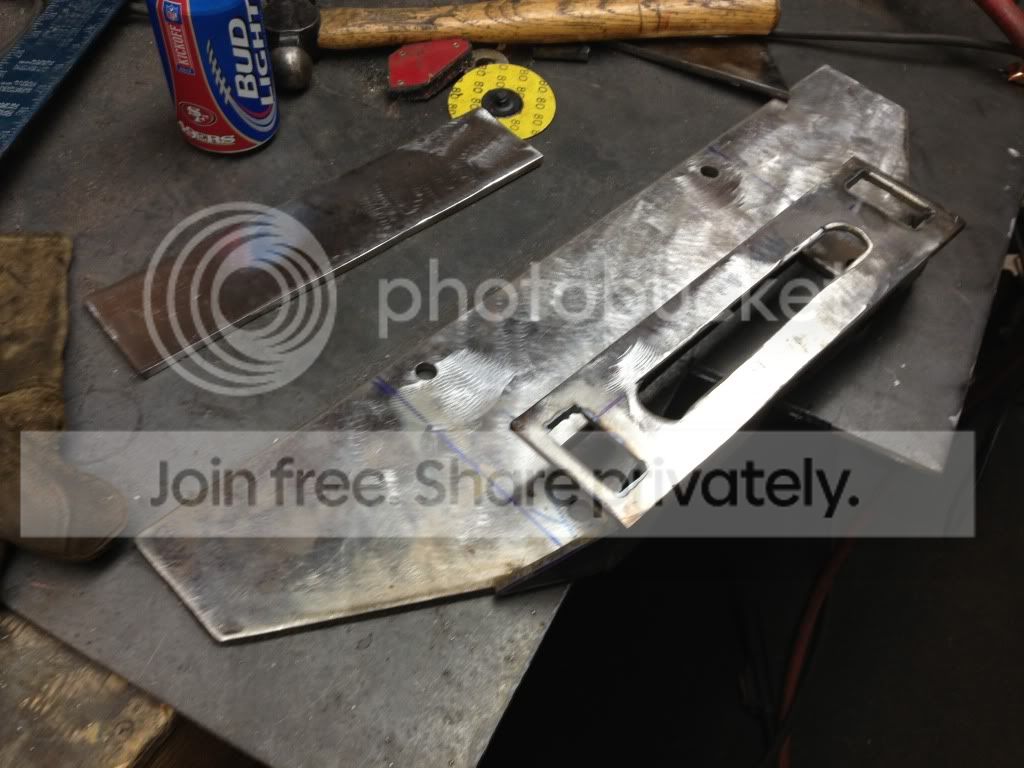

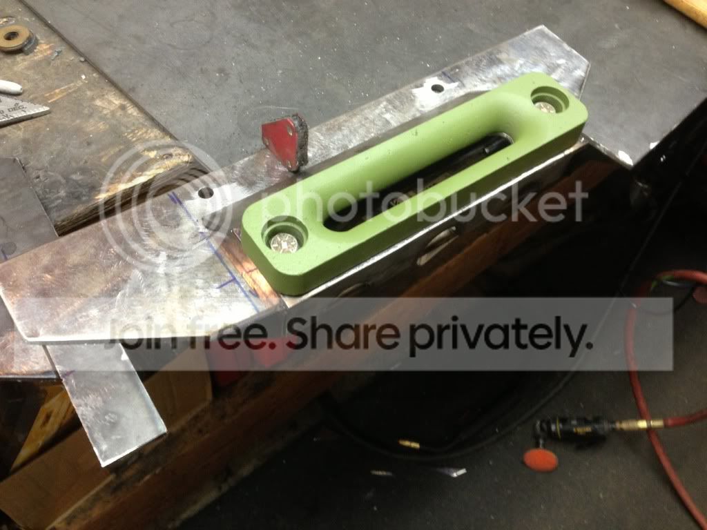

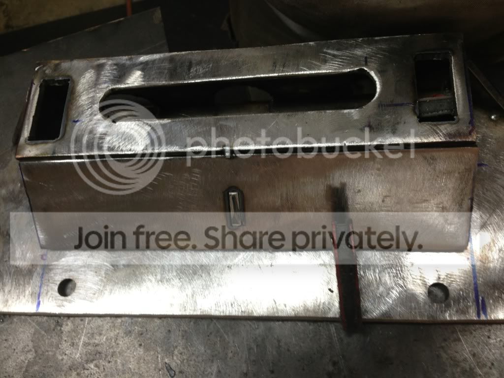

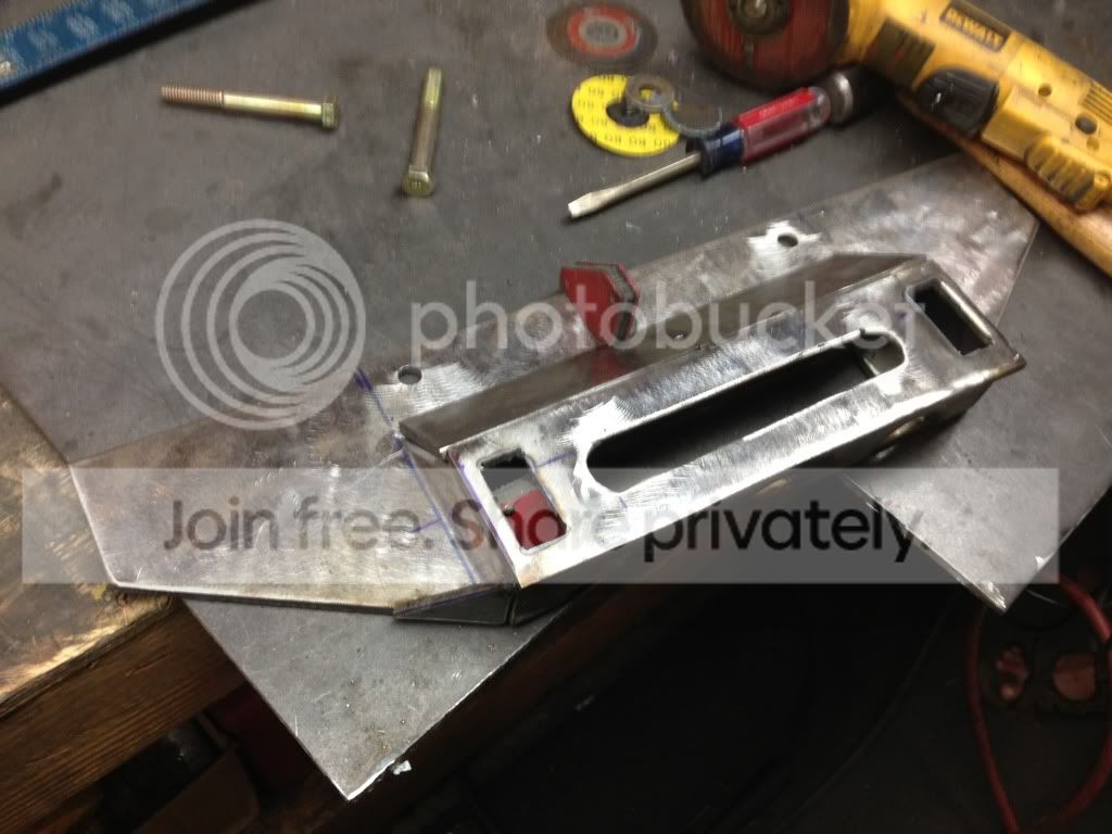

Some progress pics from yesterday. Hopefully get it welded and installed today.
I'd love to see yours sitting in that third bay. Weekly updates from ya would be awesome... :waytogo:
The plan right now is to take some of Labor Day weekend to get to the shop and start putting the front sheet metal back on. Then just need to bleed the brakes, load it on a trailer, and haul it home. We'll see if that really happens, or not.
The cuts for the winch plate have got to be sooooo much easier with the plasma. Looks awesome.
What'd you use as the template for the semi-circles on the bottom Mike? Neer can?
