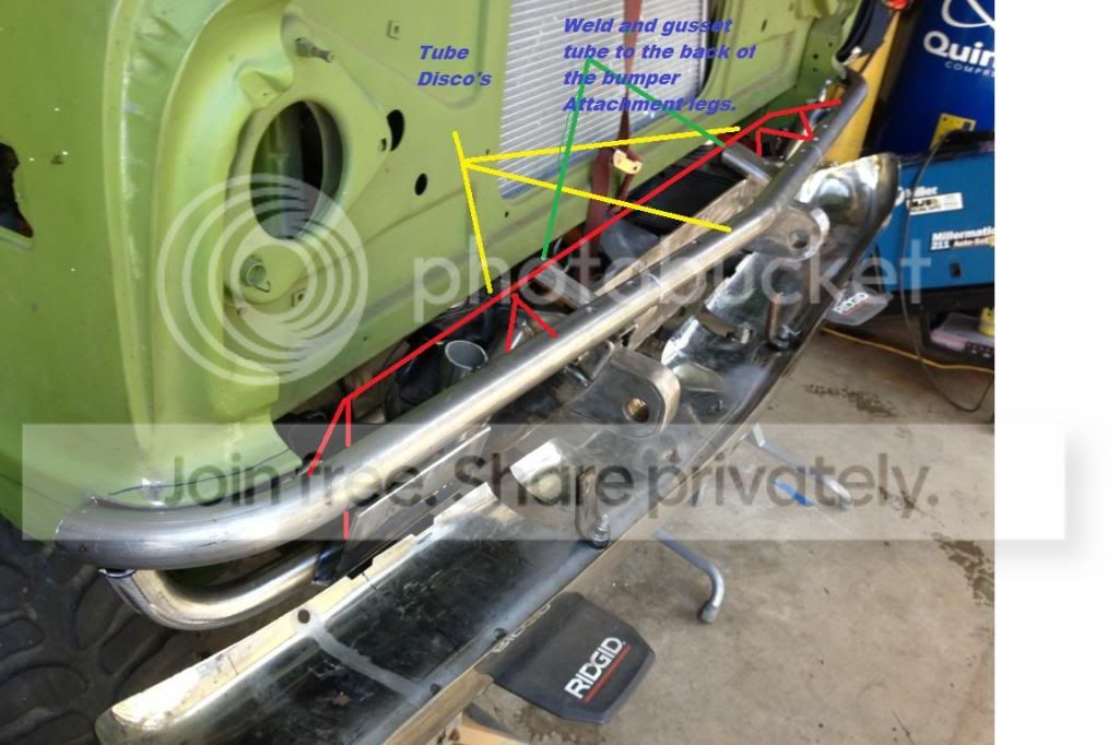

Here is what I had in my mind as far as the other tube. It might work, It might not, but it should help hold out those corners, bottom and front tube.

Mike,
Is there room under the radiator support to sneak a couple bars in toward the frame at a strong 45* angle??
If you support that upper and lower bumper tube at the nodes (especially if you get the braces at 45*) any forces trying to bend or distort the bumper corners are strongly supported.... much better than trying to use long tubes from a substantial distance away where you are really can't prevent the "lever-arm" deflection anyway.

Looks great man! I see where you cut a little more fang out and solved the area I thought would be a concern.

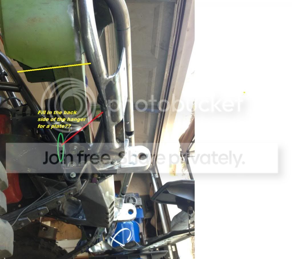

The problem is the steering box. Just no way to get it at a 45* on that side. I did think of plating the back side of the front shackle hanger and launching a tube forward off that ,but you really don't gain that much of an angle.
Thought about coming off the engine cage, but that would require a through hole and another disco.
Here is what I'm talking about. Don't really know if one is needed, but If I can, I sure would like to.
