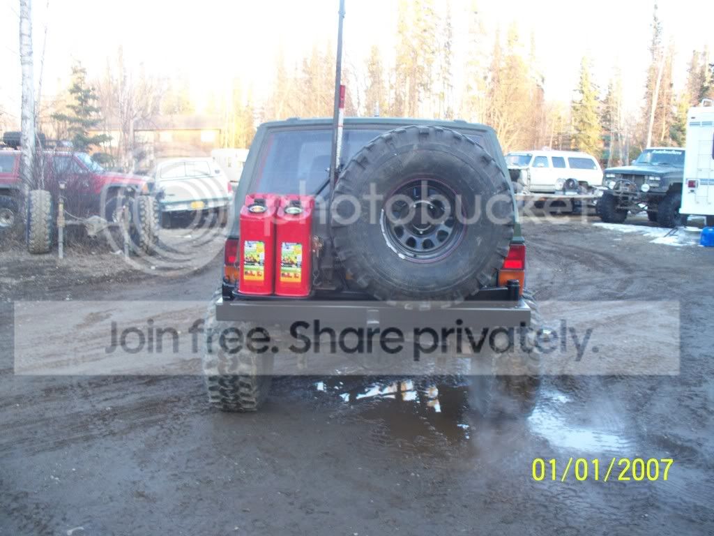

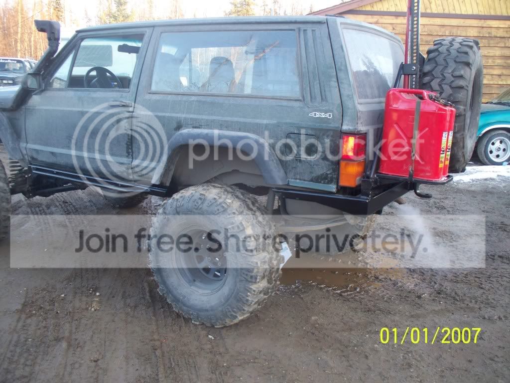

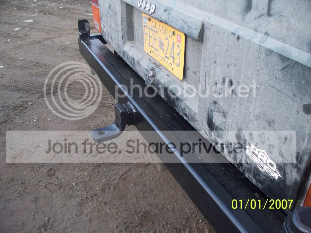

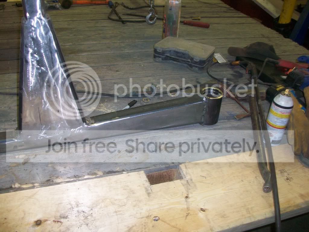

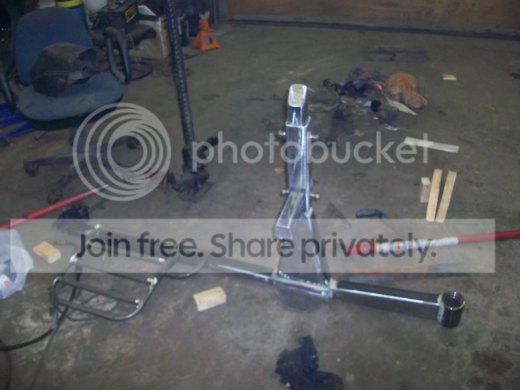

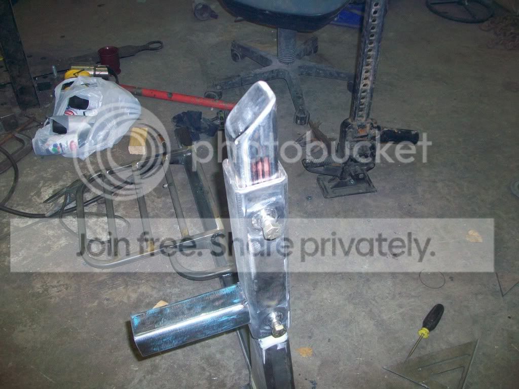

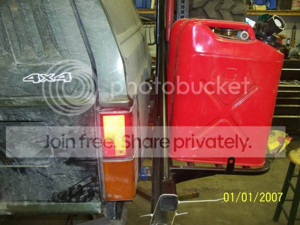

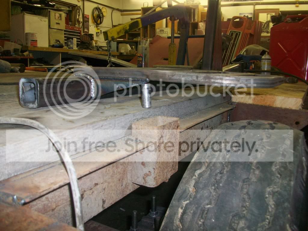

What happened to your latch? You cut it off? How is the weight of the swing arm supported at the latch end?
lol that pic was taken before i built the latch.

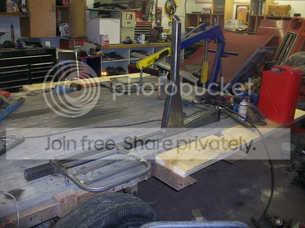

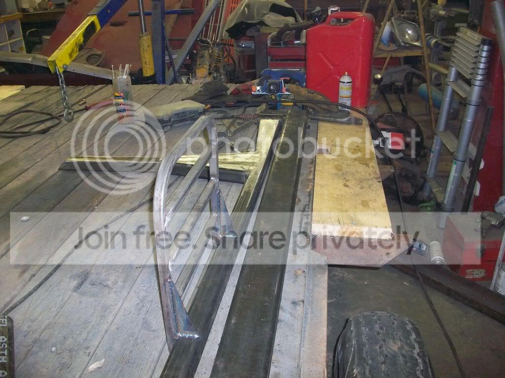

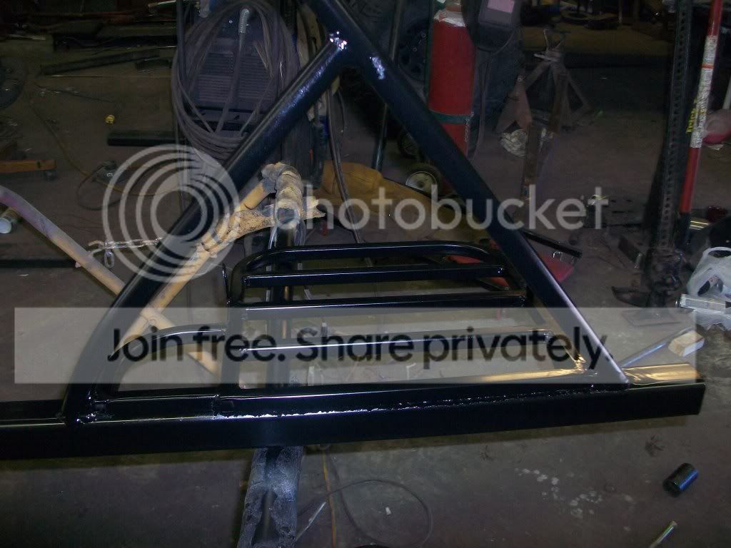

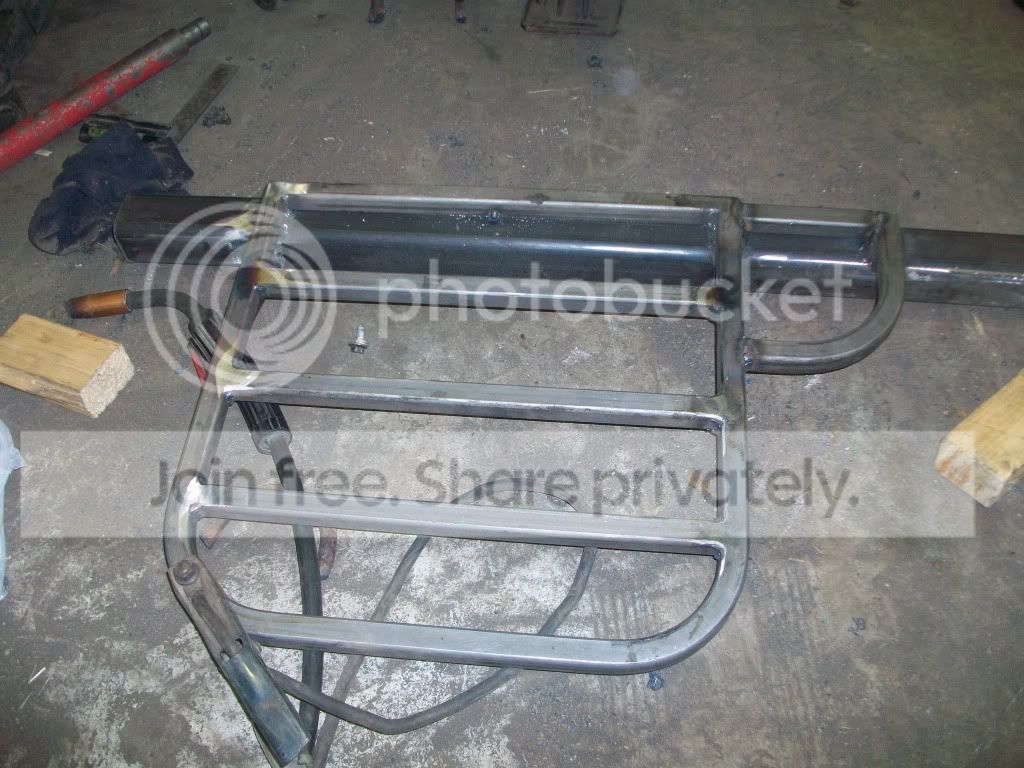

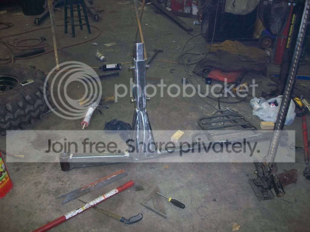

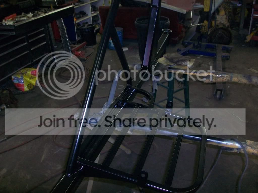

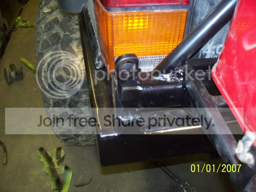

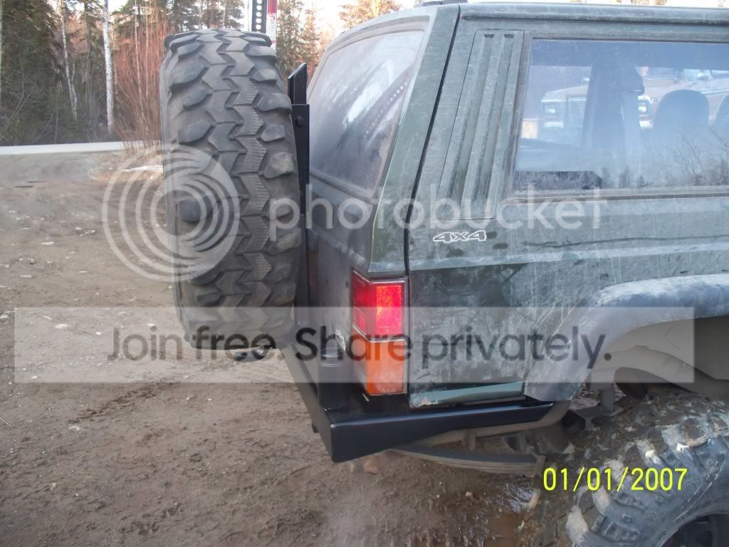

the bumper is made of 2x2 and 2x4 1/4 wall box tube.
the tire mount is height adjustable to fit up to a 40" tire.that is a 36" tire in it now.the gas rack is 3/4"x 1/8" wall square tube.
