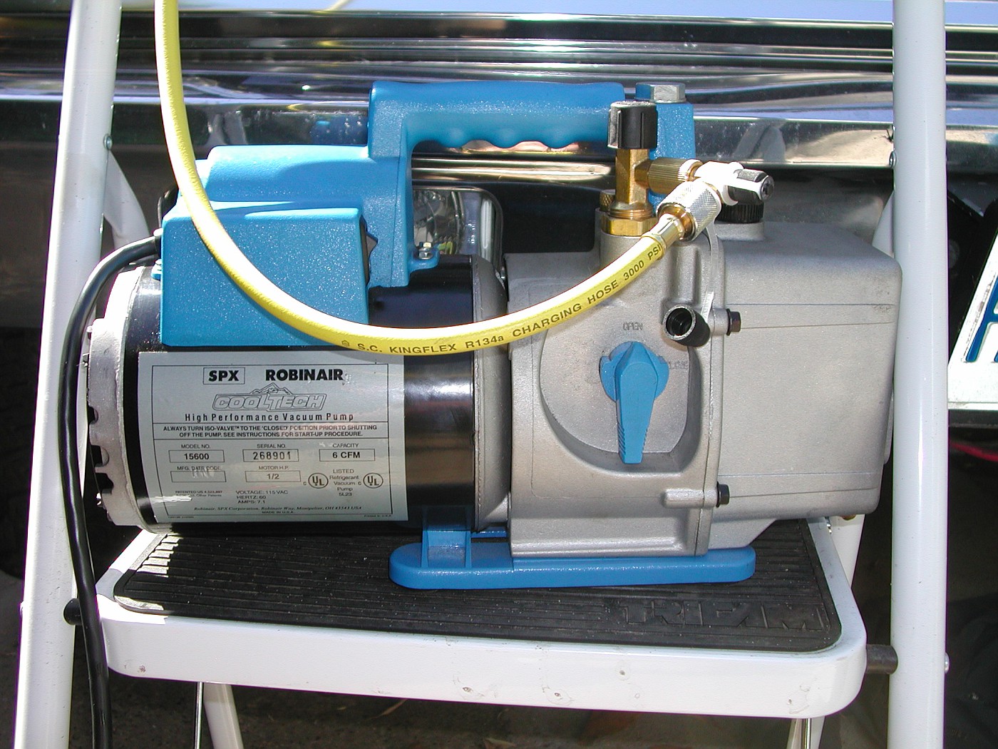

    As harry said.Once the system is all sealed up again you need to pull a vacume for at least an hr.With a large system like the burb has,the longer the better.
    You need a vacume pump something like this to do the proper job.

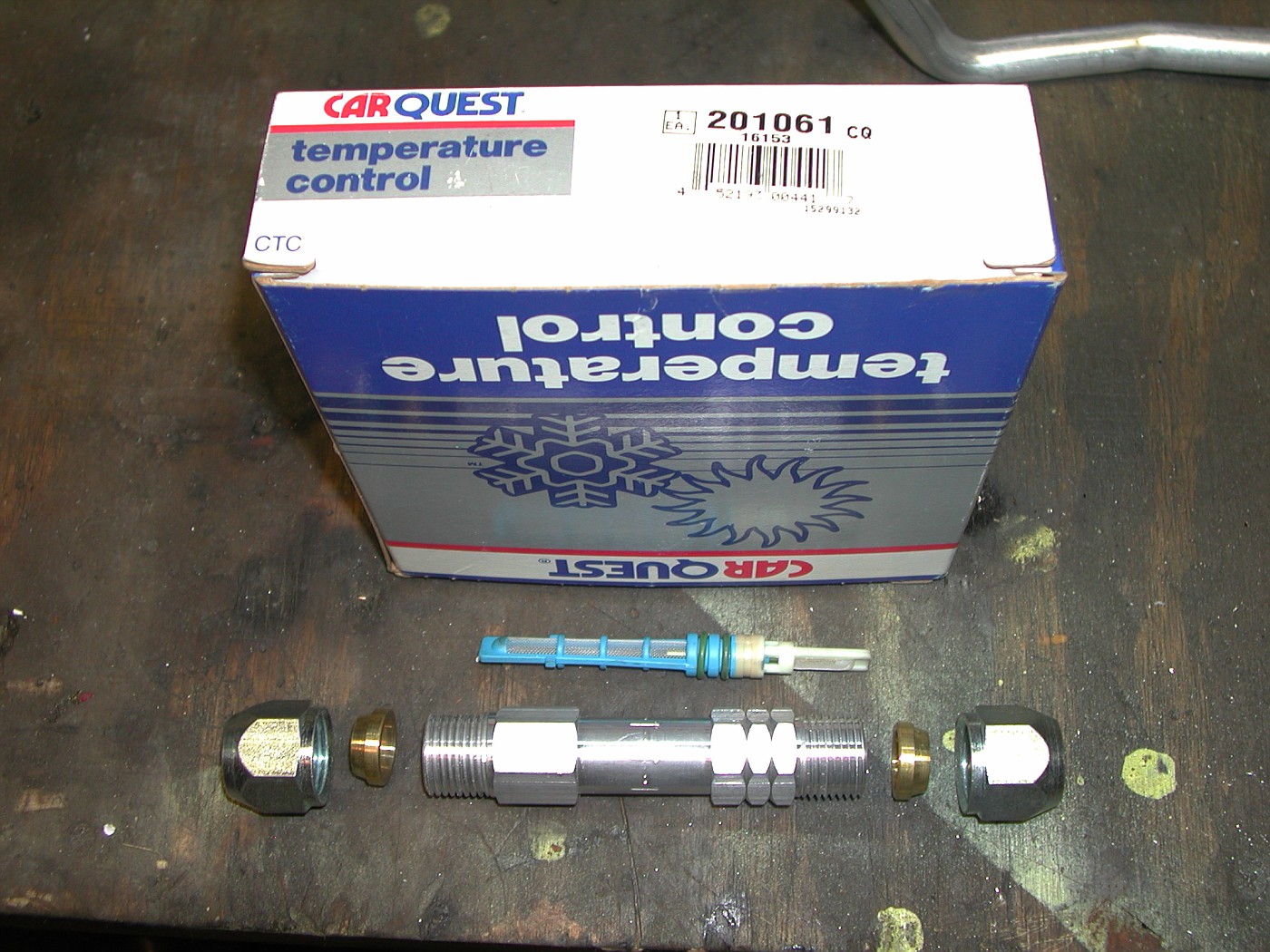

    This is a fixed orafice tube(FOT),the blue plastic thing.This is a Ford FOT,GM FOT's are white.
    [​IMG]
    Where it is located on your year vehicle I'm not sure.Sorry.
