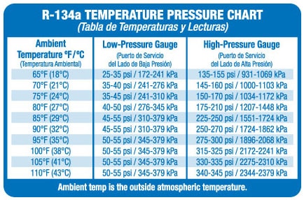

Because these trucks are so old, many of them have had evaporators, condensers, hoses, dryers, etc. changed for aftermarket parts at some point, and to that point, its best not to charge the system based on weight, but rather charge it according to low and high side pressures that correspond to the outside temperature. When charging it, this little chart comes in handy.
