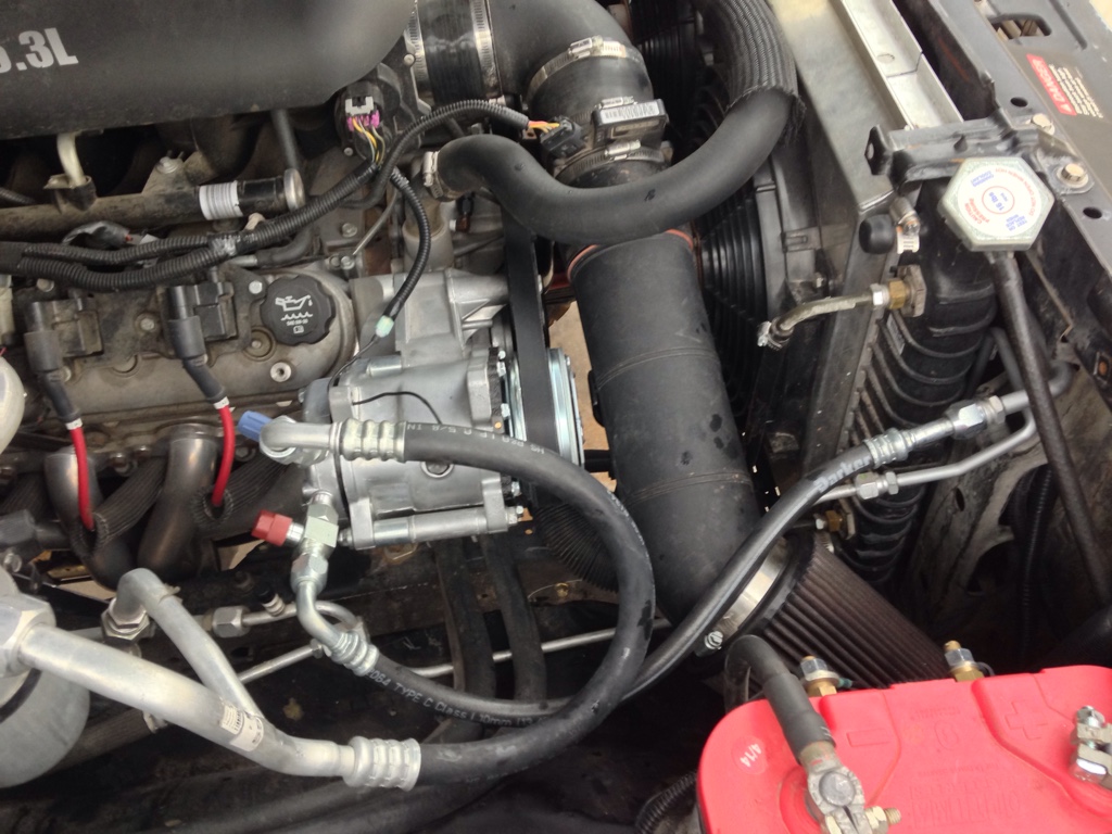

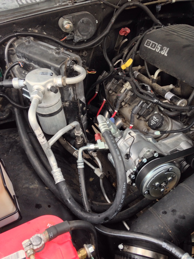

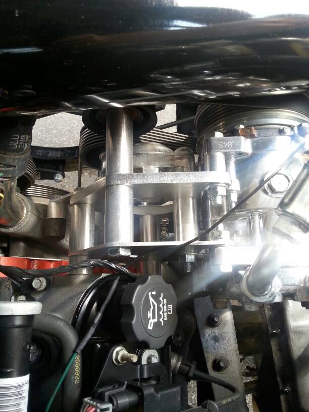

I went with a Sanden 508 compressor on my suburban. Holley makes brackets to mount it to the pass side cyl head on LS engines.

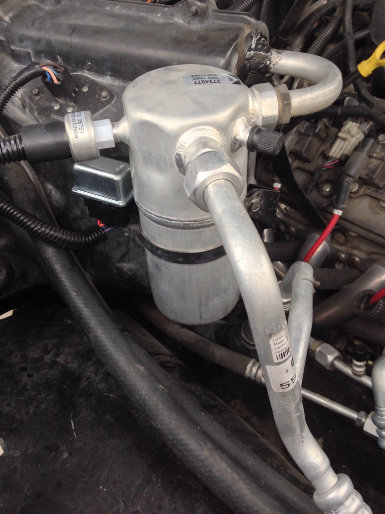

I bought an OEM replacement manifold/hose setup and had it modified to adapt to the new compressor. The expansion valve, orifice tube, condenser, accumulator, pressure switch and blower relay are all new as well.

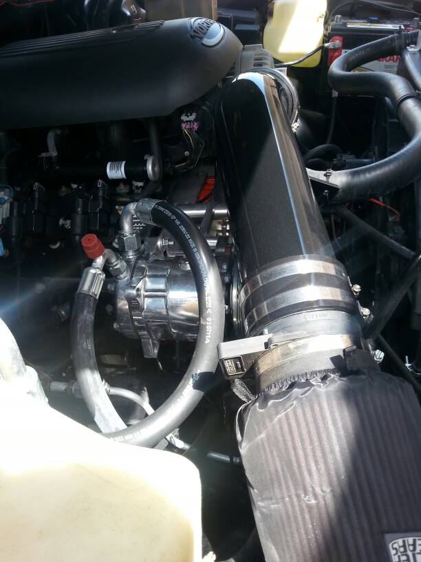

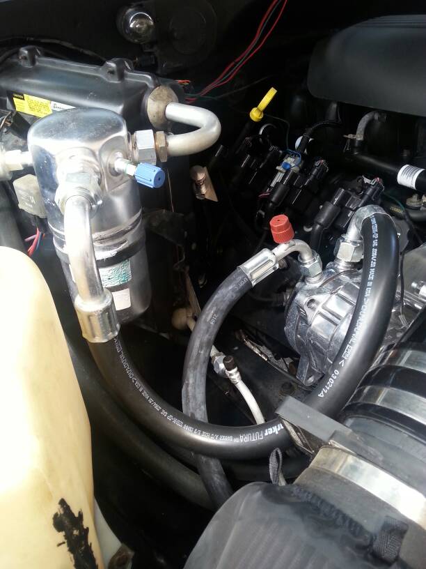

Sanden 508 and parallel flow condenser with all new components. kwik performance bracket. Blows ~55* in 105 heat with FL humidity.... It'll get down to sub 40* at night! Windstar fans wired to both run with A.C. The sanden is night and day over a factory system.
my fans are wired up to kick on with the a/c as well. keeps the head pressure down. i get 50-55* vent temps at 100+ outside, 40ish at night.:thumb:

Summit racing "Sum-340600" is the compressor I'm using. I had my hoses made at All-hose in north Las Vegas. I'm using a Holley mounting bracket for my 5.3l. They might make one for an older engine too.
