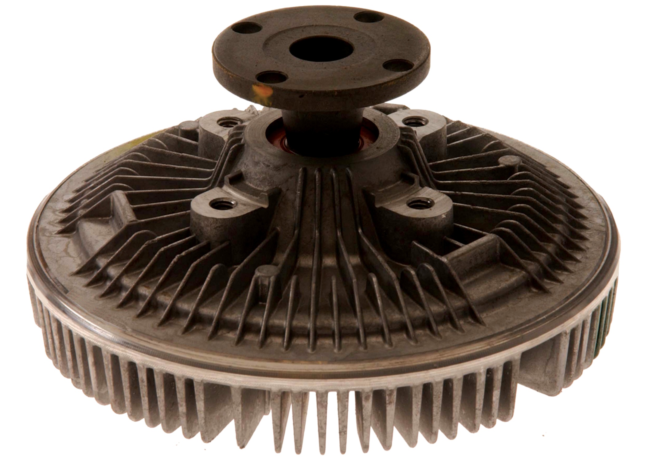

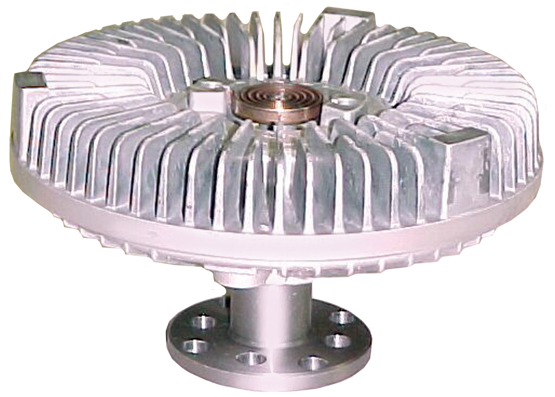

One is rightside up, the other is upside down in the photos, so that isn't much help, but it appears that 15-4950 has no gaps between any of the fins on the "front" of the clutch, where 15-4599 does have some large gaps. On the 15-4950 there may be large blocks of aluminum where there are gaps on the 15-4599. Here is the image for 4950: http://images.wrenchead.com/smartpages/partinfo_resize/DCL/15-4950_Primary.jpg here is 4599 http://images.wrenchead.com/smartpages/partinfo_resize/DCL/15-4599_Primary.jpg
Not sure those are anything really indicative, just the only differences I could readily see.
