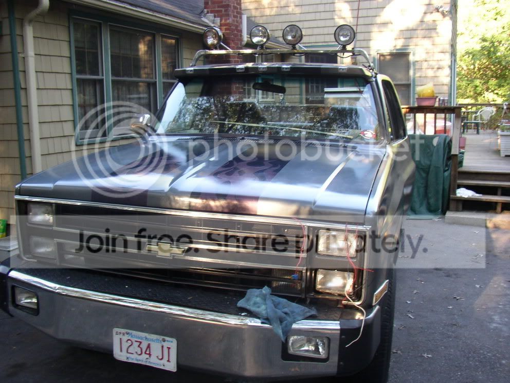

So I bought this as a daily driver about 9 years ago. 1985 chevy k5 with 90k for $800.
Shortly after the motor was givin all the signs of a hard life. I had a motor in the basement that i had built during a bored winter so i dropped it in. 1977 350 bored 30 over, edelbrock performer carb intake and cam, erson 1.6 roller rockers, and mallory hei distributor and coil.
Then got rejected for inspection for body rot. So new tub fenders doors and a custom paint job ( in my back yard LOL). New carpet, seats, dash, and privacy glass.
Well I had just about had it with 700r4's. In the last 4 years Ive gone through 4 of them. I wasnt useing the ECU due to fire so had installed painless wireing ECU eliminator kit.
So truck sat for almost a year. Until last weekend. Got a free SM465 complete. Trans, hydro clutch, 208 transfer case, drive shafts, only missing the pedals. Now that got me started I installed it the next day.
Next another buddy sees me working on the trans asks if i want some free chevy stuff. Of course i said sure. He shows up with 1987 blazer front and rear axles includeing springs, a complete 305 TBI engine includeing harness and ECU, and 2 sets of tires and rims (31's and 33's).
Well put the stuff in my shed and started cleaning the 52 inch rear springs to paint. About to order the DIYx4 b52 kit.
Brother in law stops buy for me to take a look at his new van. Nice but what happened to the old one? Parting it out. Still got the rear diff? Its all yours. YES. 14bolt FF 1-ton. Now just need a d60 for the front.
