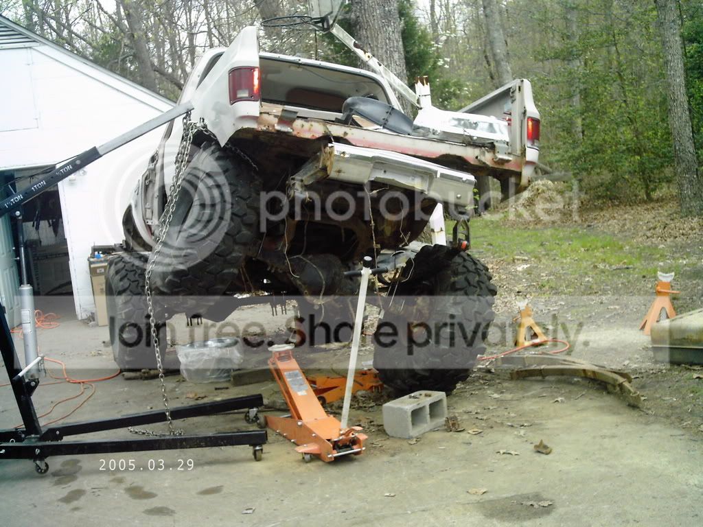

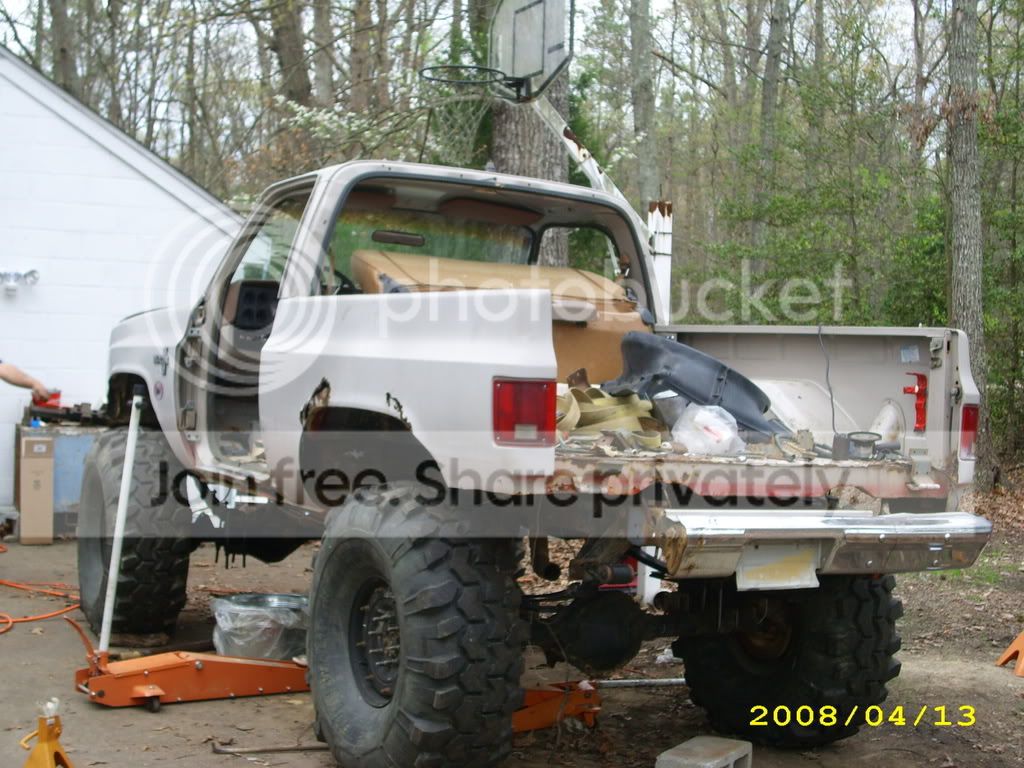

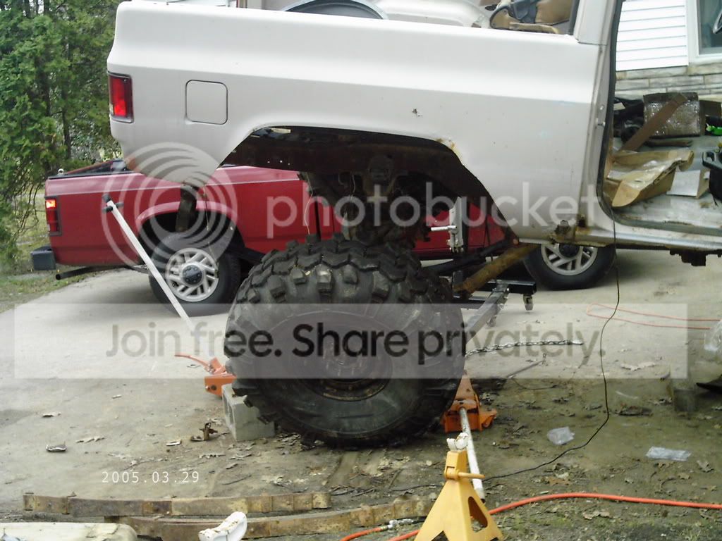

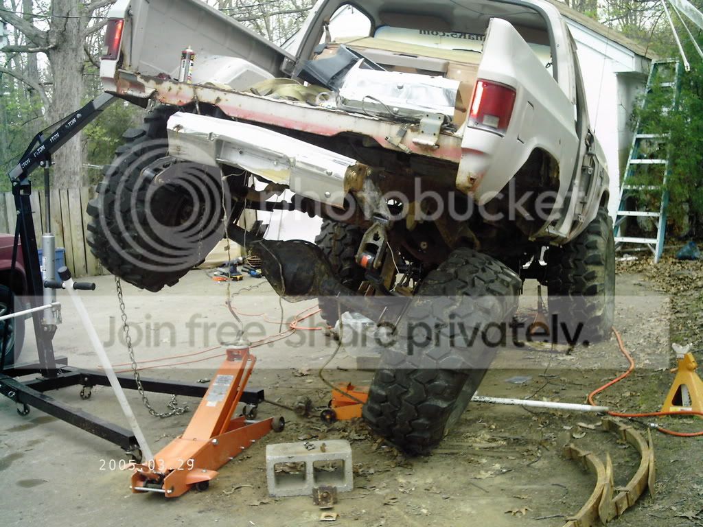

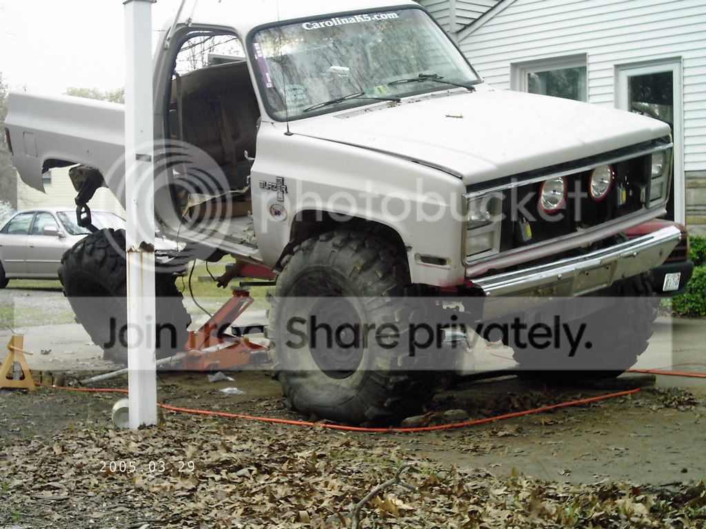

i kinda posted theese up here and there put i figured id start a thread and show how well 64s flex....oh thoose are 44's....i think i could have gone farther but the hoist wouldnt have liked it....anyway
the truck is no where close to being finished so there are no shocks or anything...oh im 5'10 for refrence

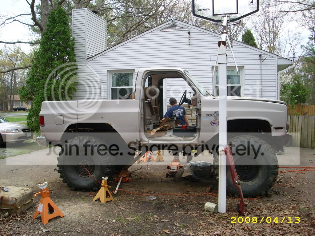

What are you running in the front for a spring setup? Do you have pics of it sitting level on the ground from the side? I'd like to see how the 44's fit under it. Thinking of going 44's myself. NICE TRUCK!

here is the truck sitting level before i finished moving the flip to the right location,now its about an inch higher depending on how much air i have in the tires :D

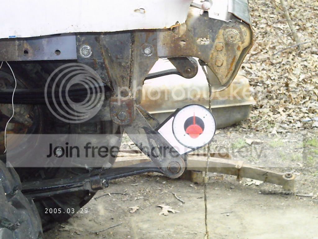

corrected my shackle angle its now at 42 degrees
