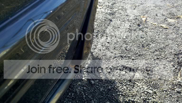

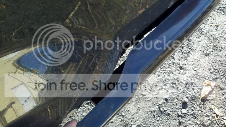

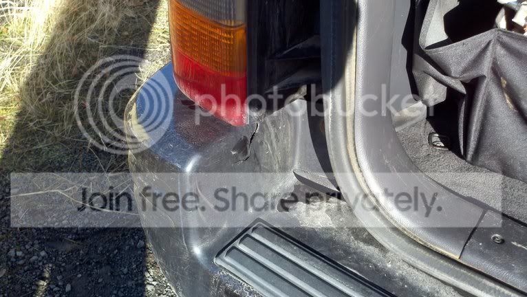

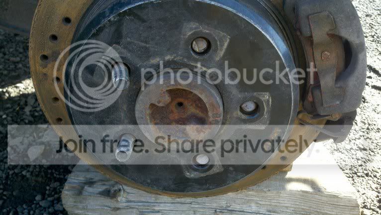

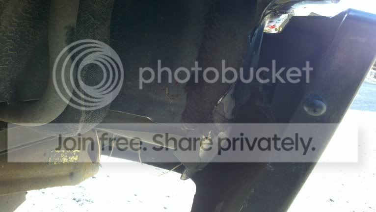

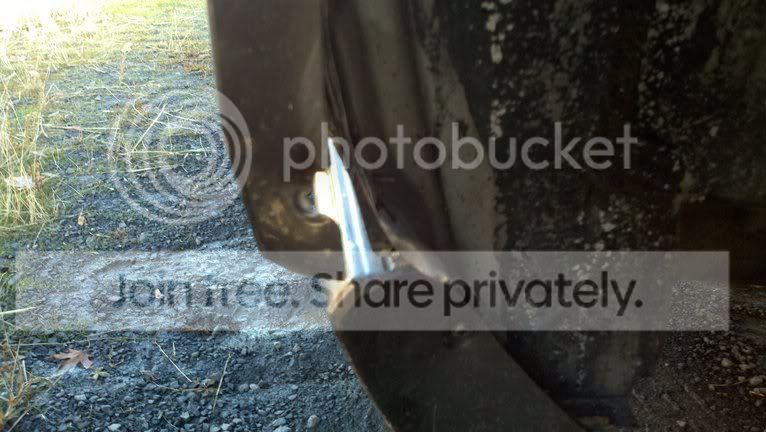

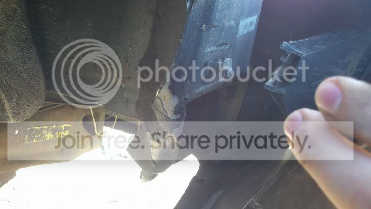

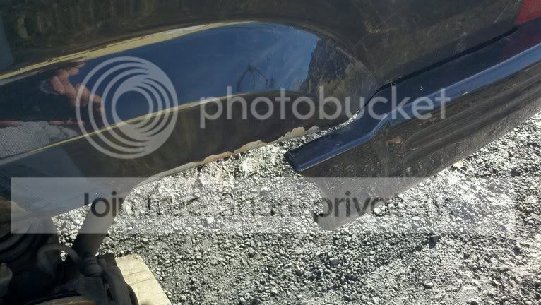

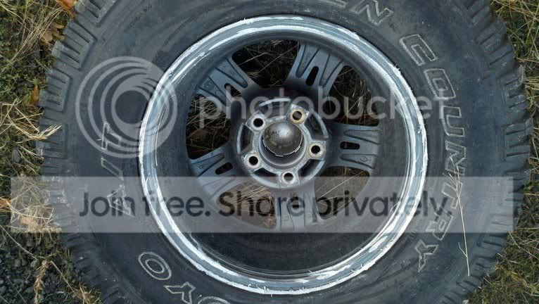

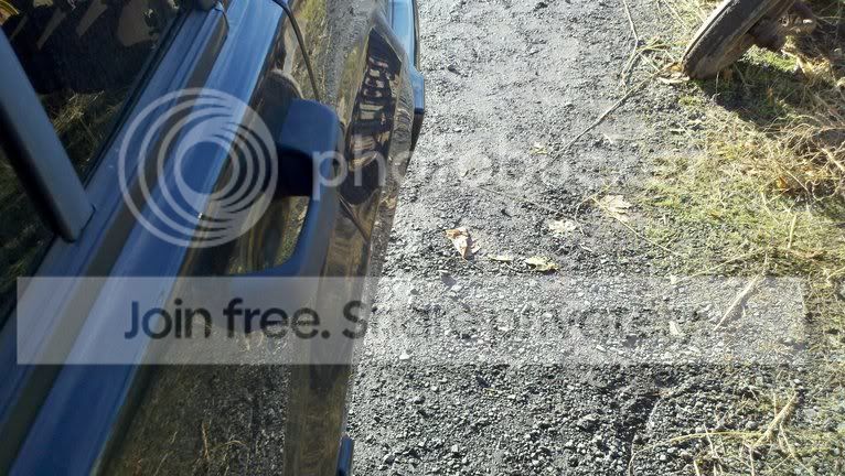

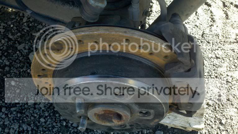

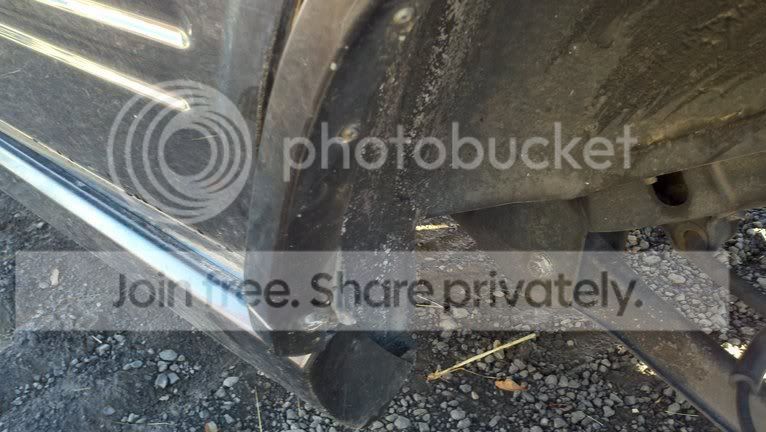

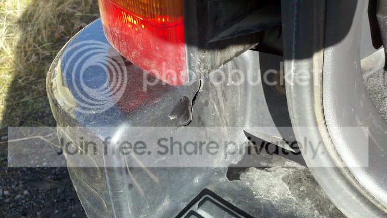

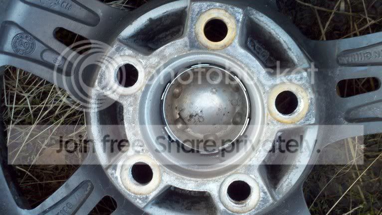

A couple of weeks ago I did a brake job on my Jeep. All the wheels were properly torqued when I finished, checked again after 100 miles and double checked once more before I took off for a trip across the state this past week. Everything was fine up until I was heading back last night. Made it about 40 miles from home and my rear driver's side tire let loose at 60mph on the highway. From the aftermath it looks like two lugs spun completely off at some point and a weak/cracked stud failed taking the remaining two with it. My best guess is at some point a PO or tire shop put the lugs on with an impact or something and over torqued the crap out of them.

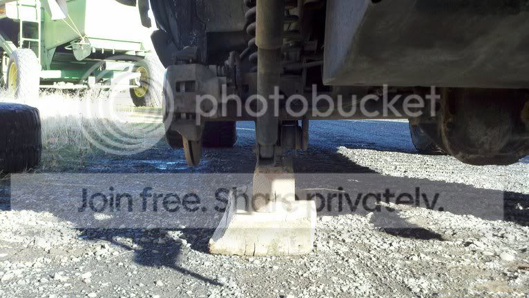

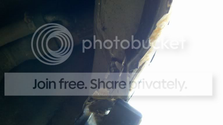

No one got hurt but it sure made a mess of the wheel well. I'll tell you that was a wild ride for a couple hundred feet skating on nothing but the rotor and shock hanger!
We found the tire this morning out in a wheat field over 100 yards away.
The carnage:

another thought to throw out there is that you might have done it by unnecesarilly re torquing them multiple times, properly torquing them once should be enough imo
I didn't re-torque, just checked them at the same setting (90 ft-lb) to make sure they hadn't loosened. Pretty standard procedure, especially for aluminum wheels.:dunno:
oh...glad no one got hurt man... another thought is maybe if the rim has been taken on and off alot in its lifetime the hole or taper could have gotten enlarged creating a not so snug fit...I just look at what could have caused this, my old boss knew a lady that got killed from a loose wheel on the freeway

Yeah I'm glad the wheel just went off in the field and didn't hit anyone. I wondered the same thing about the taper. I already don't like aluminum rims cause they wallow out easier and don't hold the lugs as well as steel IMO so this just reaffirmed it for me. These POS wheels came with the rig and I figured I'd just make it through the winter and replace them but evidently that wasn't in the cards. I'll be sticking with steel in the future.:thumb:

from years of doing ths i have found mopar products suffer from what i call dry stud / nut . the threads are way to dry or rusty and you get bound up and get a incorect reading of tight/seated. also the aluminum rims get heavy corrosion in the hub center hole and dont seat 100% some times.
every mopar i get if the studs / nuts were dry got lubed with oil then put together. what a diffrence this made and it was noticable .

Just a thought, and correct me if I'm wrong, but that wheel, and most modern aluminum rims that I've seen have the steel inserts around the wheel stud holes. I was told that was because in the past aluminum wheels without them had loosening and ovaling issues.
Do the steel inserts not fix it well?

Oh and about the lubing threads thing. I hand cleaned the threads and all mating surfaces with a wire brush so I'm pretty sure everything was seated properly.
It's hard to say...on these rims it looks like the lug holes are all part of the same wheel casting but they could be inserts.
