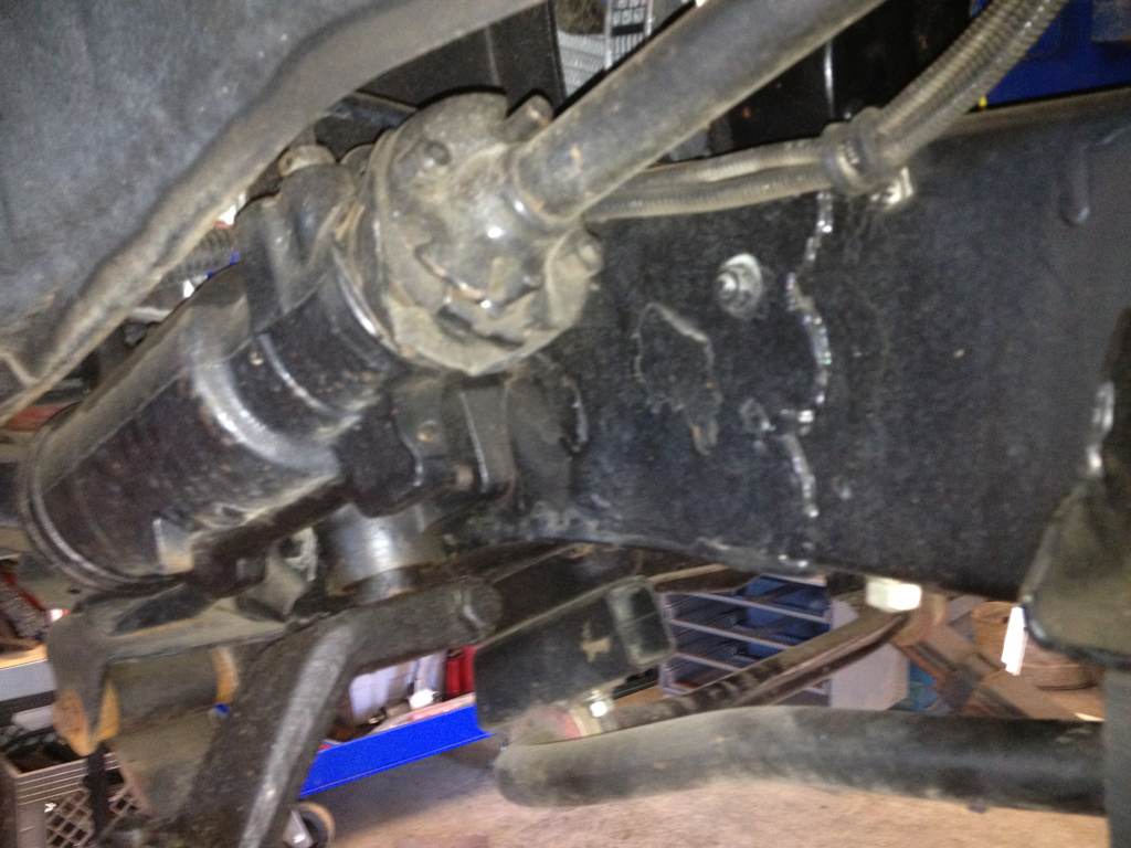

The frame has some big hillbilly repair. I'll be cleaning that up.

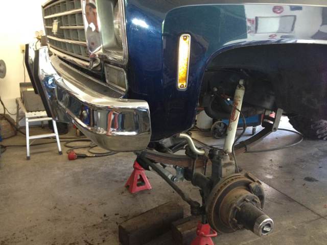

image.jpgGot some fender trimming on the front done. Got the knuckles off and in the solvent tank. Gonna try to get them gussets on it today and in the cooker over night. Maybe get the other front fender cut and the springs removed. Gotta start on the trans mount also.
Do you find it easier to fender trim with the truck upside down? Haha my phone screen will keep flipping to keep the picture upside down :what:
Anyways. Was this truck a pavement pounder before? I can only imagine how much better this thing will handle on the trails with the spring swap instead of the 12" dumptruck springs!

So next situation. Who makes this frame repair setup? Tryin to decide if I'm gonna to cut this out or just clean it up.
