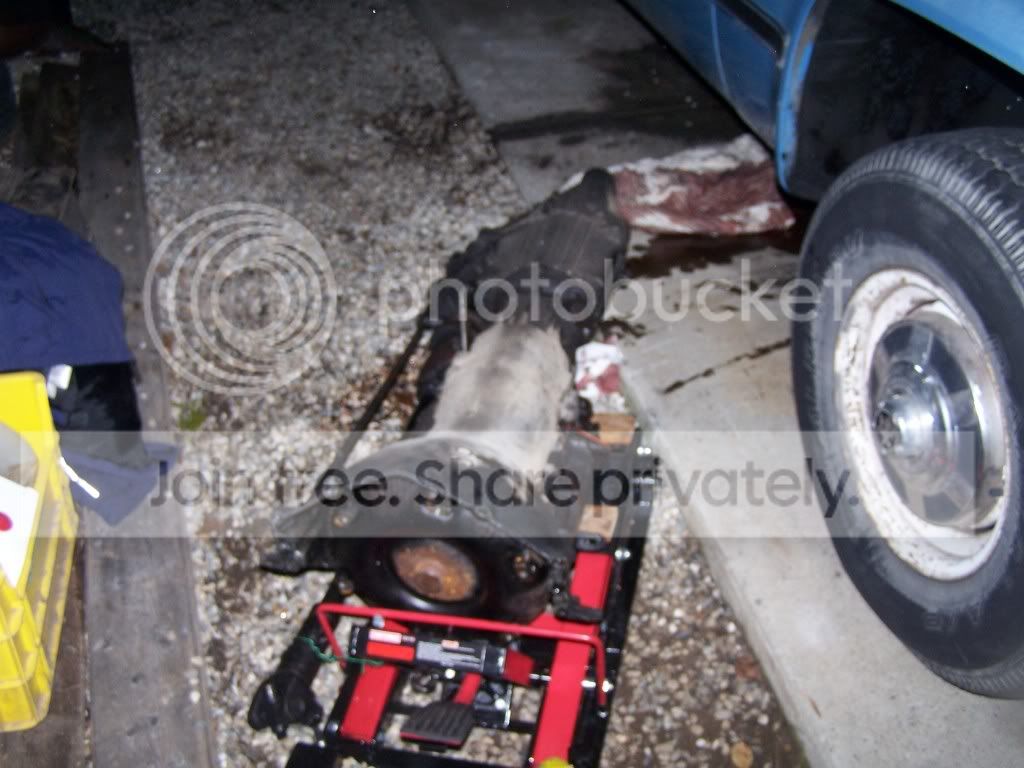

I found a buyer for the burb without the tranny so im pulling it and everything seems straight up except. Those top bolts. Wondering if theres any tricks to it or something that will make it feasible at least?
Jump up under the hood and get them with a medium size 9/16s wrench... Or
Save them for after the driveshafts and crossmembers are out...point the trans down and those top bolts will be staring you in the face.
Just watch ya dont break the dist cap.
stuff like this. watch ebay for these. thay show up all the time. best money i ever spent on them to make life MUCH better at removal/install.
1/2" drive to 3/8" drive great for impact gun use. http://buy1.snapon.com/catalog/item...id=355&supersede=&store=snapon-store&tool=all
and
then clip this on the end of that ext. http://buy1.snapon.com/catalog/item...id=324&supersede=&store=snapon-store&tool=all
edit: dont forget the gas pedal switch/bracket. 3 small bolts its out. and the orange wire from pedal to fuse block and then out firewall to tranny side plug. its for the kick down. and get the vac line from intake to modulator on side of tranny.

I really appreciate the quick response man, Just another reminder of why ck5 is so great :bow: , That is the path im taking. So far i got
1.Front and rear drive shafts disconnected on the ends so the transmission/transfercase can slide out without any resistance.
2.Pulled flex platecover which may i note was very well braced from the factory. Much stronger set up than what i got on my blazers, Hell my 76 doesnt even have a flex plate cover and i cant get it on because my exhaust guy routed it wrong :doah:
Im on a little lunch break, plan is to
.unbolt torque converter
.Undo transmission linkage,cooler/vaccuum lines and wiring
.jack up transmission and pull the crossmember
.undo the 2 top bolts
.pull it out
Ill keep ya'll updated :popcorn:

Those top bolts are cake if you just get about 2 - 3 ft of extension for a 3/8" drive ratchet(I usually use one 2 ft and 12"), with a swivel on the end right before the socket(or a swivel socket). No binding your motor mounts either.

Thats what i ended up doing :haha:. I had never yet used that many extensions for anything. Was quite a spectacle.

Im definitley installing access panels on all of my trucks when i pull the tranny. I managed to get it done but it was a real pain in the ass.
