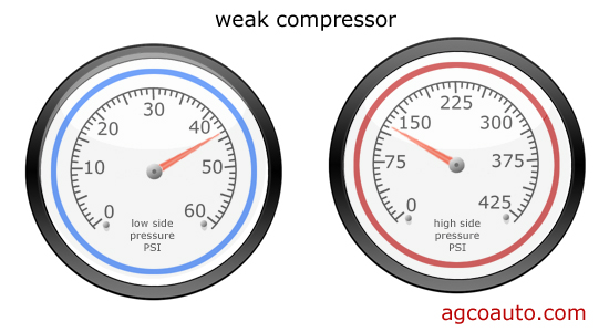

The AC on my wife's 2011 Toyota Sienna is not blowing cold. It has had intermittent issues like this in the past and was low on freon. I've had to add freon twice in about 1.5yrs. I added a can about 2 weeks ago and low pressure side was 45 after the can. I didn't check high side. It was about 95 outside. About a week ago we were in traffic and it was not cooling. It finally started to cool down. Today it stopped cooling again. It was 108 outside and low side pressure was about 50 and high side was 160. Compressor running but blowing hot air and lines not condensating. Anyone know what would cause the low side pressure to be normal and high side to be low. Bad compressor? Thanks

Evap lines are not cold and the compressor is running constantly and not cycling. If I disconnect the pressure switch the compressor turns off and pressure starts the equalize. (Well low pressure goes up to about 110 but high pressure doesn't really move) plug switch back in and compressor cuts back on and brings low pressure down to 50. No change in high pressure.
I just think that the low side number should be lower for what the high side is reading.

2 things come to mind.
1) you don't have nearly enough pressure difference between high and low side. Over 100 degrees out, that high side should be over 250psi. The compressor keeps running because the low side never gets low enough for it to shut off.
2) the temps have to match the pressure or the charge isn't all R134. If the low side is about 50psi, it's about 52 degrees. That should be noticeably cooler than ambient. 160 psi may just feel like other under-hood temps.
If you were under-charged, the low side pressure would drop quickly once the compressor kicks on. If you were over-charged, the high side pressure would be too high. If you didn't have enough airflow, both pressures would be high. If there was a blockage in the system you would have very large pressure differences.
The lack of pressure difference means either the TXV or compressor is bad. If the TXV was blocked, you should see large pressure changes and quite quickly. If it was stuck open, the lack of pressure difference would be explained, but the evap should be frosty. So maybe the rings on the compressor are going.

I'm think it's the compressor as well.
Low high side with normal to high low side at that temp is poor compressor output.
