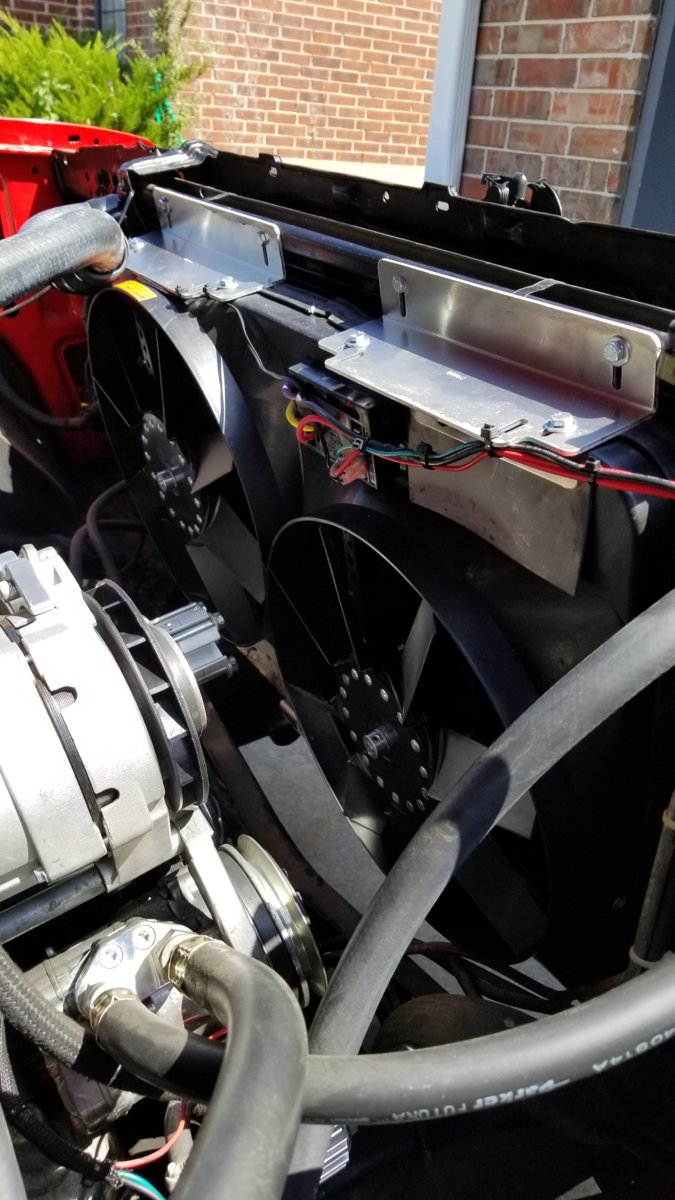

So after doing a bunch of research, I decided to do a electrical fan conversion. Below is a picture of the new fan system that replaced the mechanical fan.
The fan I installed was the Flex-A-Lite 295 - Dual 13 1/12 inch fan system. Rated up to 4,600 CFM.

What triggers the fan? Is it only coolant temp, does it run whenever the clutch is engaged or is it on a high-side pressure switch?
That's what I was getting at. If it's running without a fan sometimes, it probably has a high-side cutoff switch or it would have vented refrigerant already. (Edit: R12-R134a retrofit kits often include that switch. Sort of quasi-legal-requirement, but only because R134a sucks. Pressure is higher and system won't cool as well, but with good fans and good shroud sealing can come close.)
You don't really need the fans at speed, but at low speed or parked they should always be on when the compressor is running. You just need a diode or two on (each) fan relay
Fan system is based on coolant temp. It basically kicks on around 175-180 degrees. Not sure if it's kicking on when I engage the AC. I guess I was assuming that it was doing it, but I'll check to verify.
