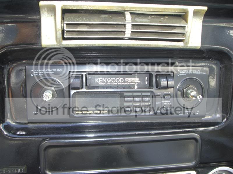

this is a replacement radio with two posts. the dash was never cut, but i am thinking of cutting it to fit in a removable face radio with CD and MP3.
This is the junk i want to change out:
wow a casette player, i bet high school kids these days dont even know what that is.
just unscrew the nuts on each post and the radio should push into the dash.after that you can snake it down to underneath the dash to unhook the wiring harness.just dont break an air duct!you can unhook one or two to make the job easier,especially the one leading up to your center dash vent.

does the kenwood work? and it has a nut on each shaft, then drop it down through the bottom.
The kenwood is broken. I can't find a direct fit placement with USB MP3 support and a remote control, so i will wind up cleanly cutting the dash. I can get a JVC on sale around me for $69 to slip in there.
