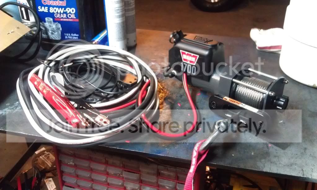

I picked up this little Warn for cheap through 4 Wheel Parts. They didn't stock it but ordered it and had it the next day. I bought some really heavy gauge jumper cables and chopped one end off and soldered the leads to the leads on the winch. It works well for my needs and for the price it's hard to beat. That being said if I were winching stuff up on the trailer on a regular basis I'd go big and never look back (regular size 10k pound or bigger winch).

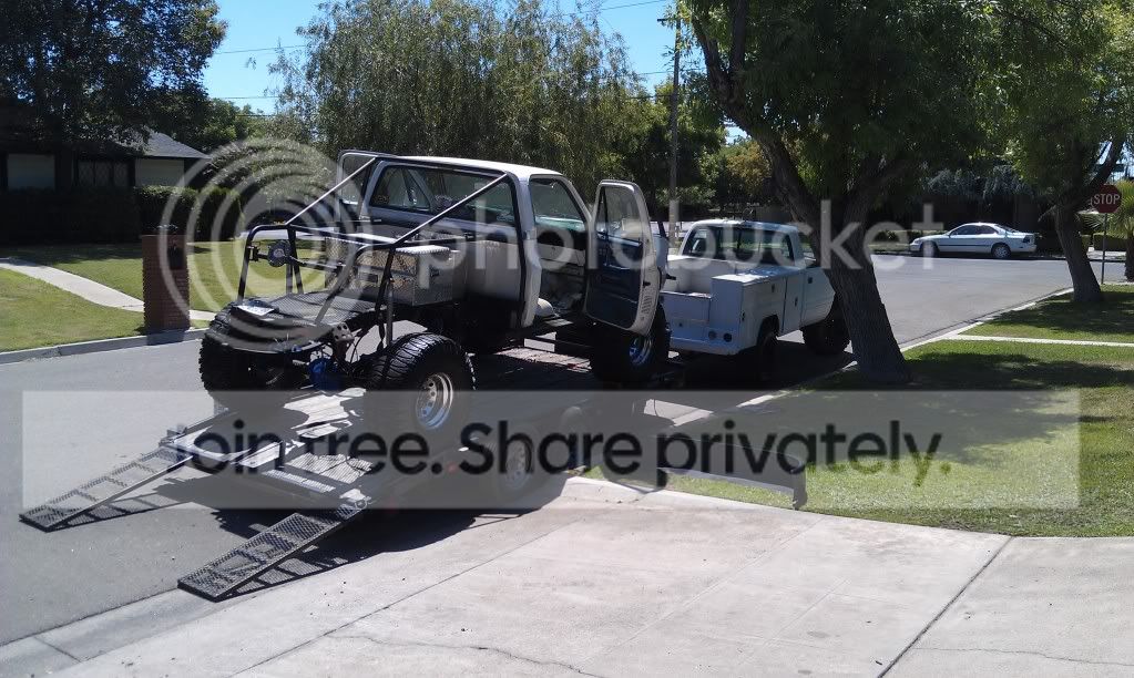

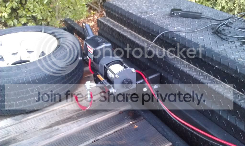

I mounted a receiver hitch on the front of my trailer and bolted the winch to a piece of tube so it all slips together when I need to use it.
It dead pulled my 1 ton k10 with a doubler (approx 4,500 pounds) onto the trailer including up and over the tires (fenders were off) without overheating or any issues. It was cool to the touch after the pull.
