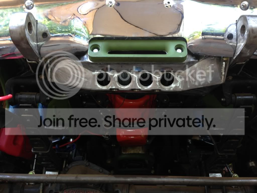

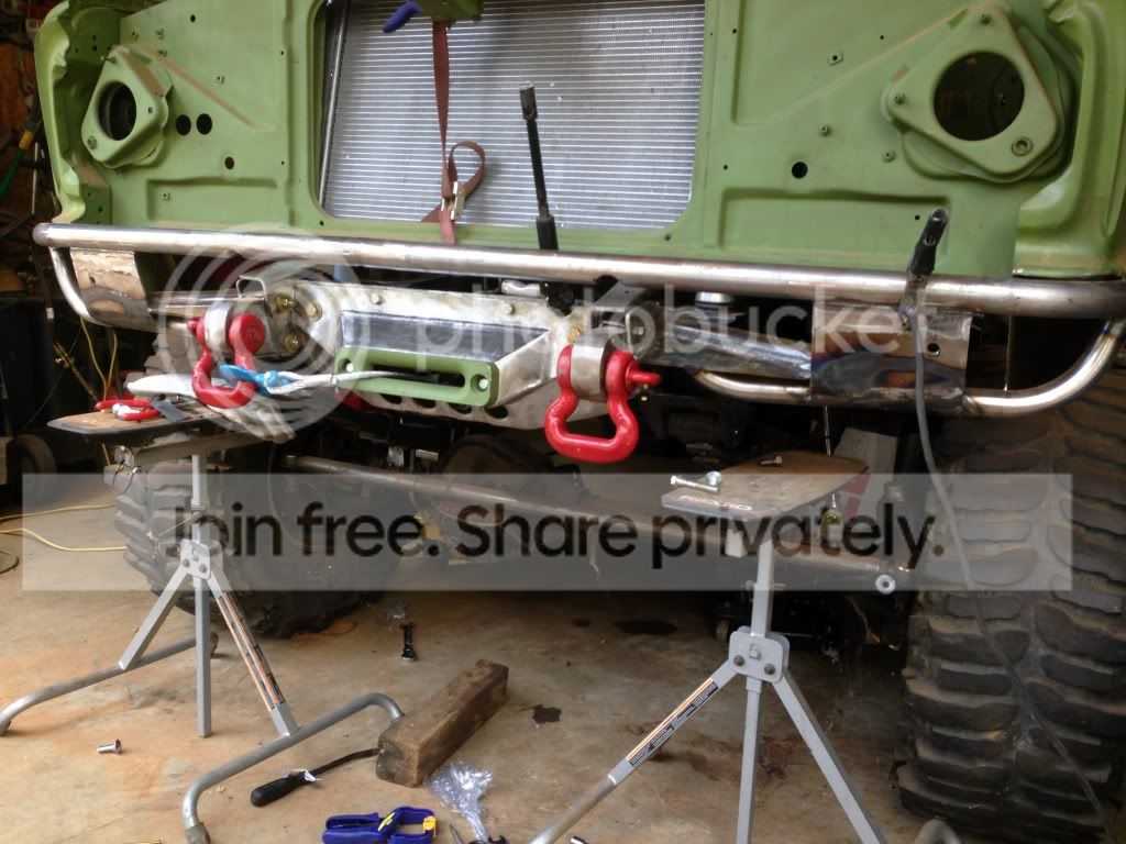

The winch has to be mounted to the frame. I have an old-school Ramsey winch with their frame mount kit which does hide behind a stock bumper:
and then there's a hole cut through the center (ish) for the fairlead
I am not aware of such a kit for current style winches, however -- this kit is for a specific, nonstandard mounting.
-- A

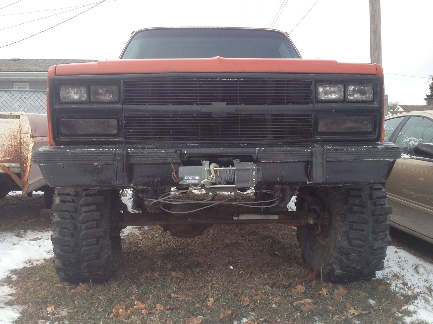

On my suburban, I welded a piece of 5/8 plate on top of the frame, right under the core support. I have an m8000 mounted upside down (feet up), that just barely fits. The fairlead is bolted to the bumper, in place of the licsense plate. I planned on reinforcing the bumper for the fairlead, but never did, and really have not seen a reason too.
