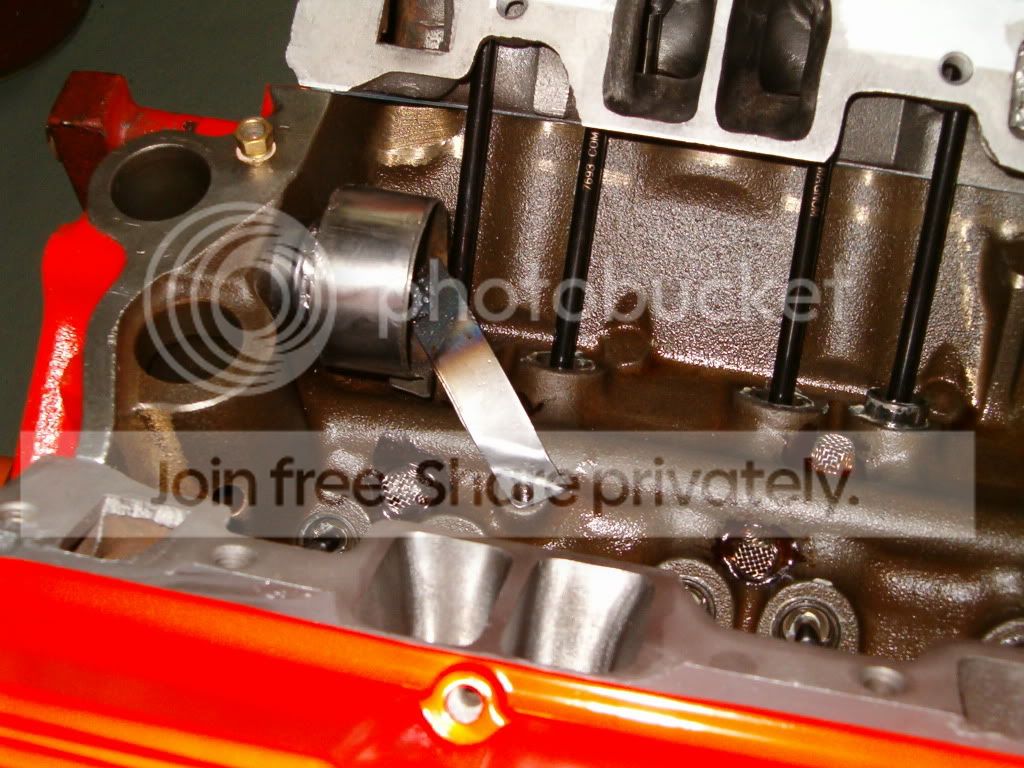

Thanks guys, I was going to build a baffle box from scratch, but decided to just shorten the existing one to fit under my intake.
I get now that I can weld stainless without special equip. just the weld will be subject to rusting like regular steel.
Appreciate the tips.
Here's what I ended up doing.

76zimmer.... you should be fine with that weld not rusting... like cgt80 said,,, as long as steel has oil on it is pretty much protected from rust.
