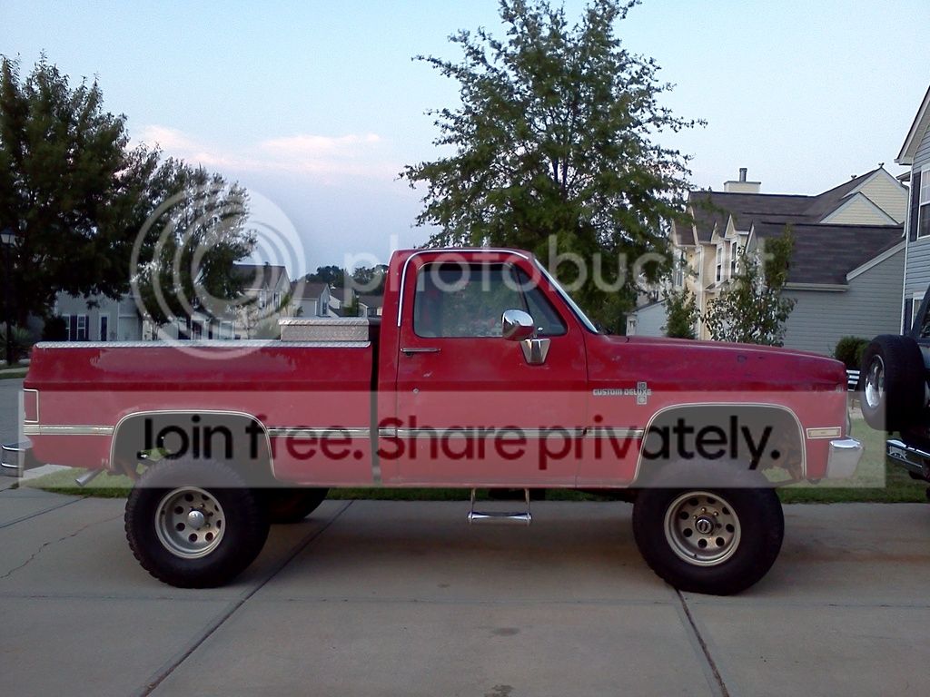

My truck 1986 K10

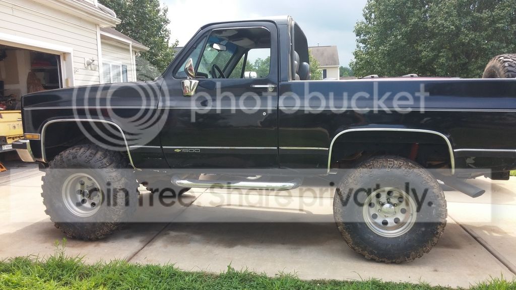

My wife's (that's what she thinks) because its an auto. 1989 Blazer

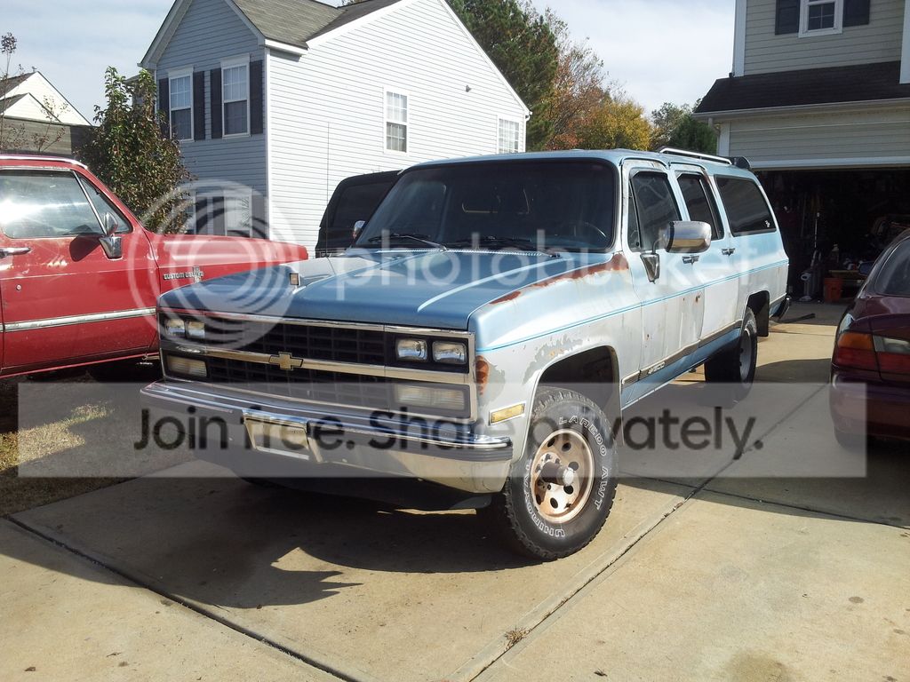

And 1989 Sub I'm fixing up now.
