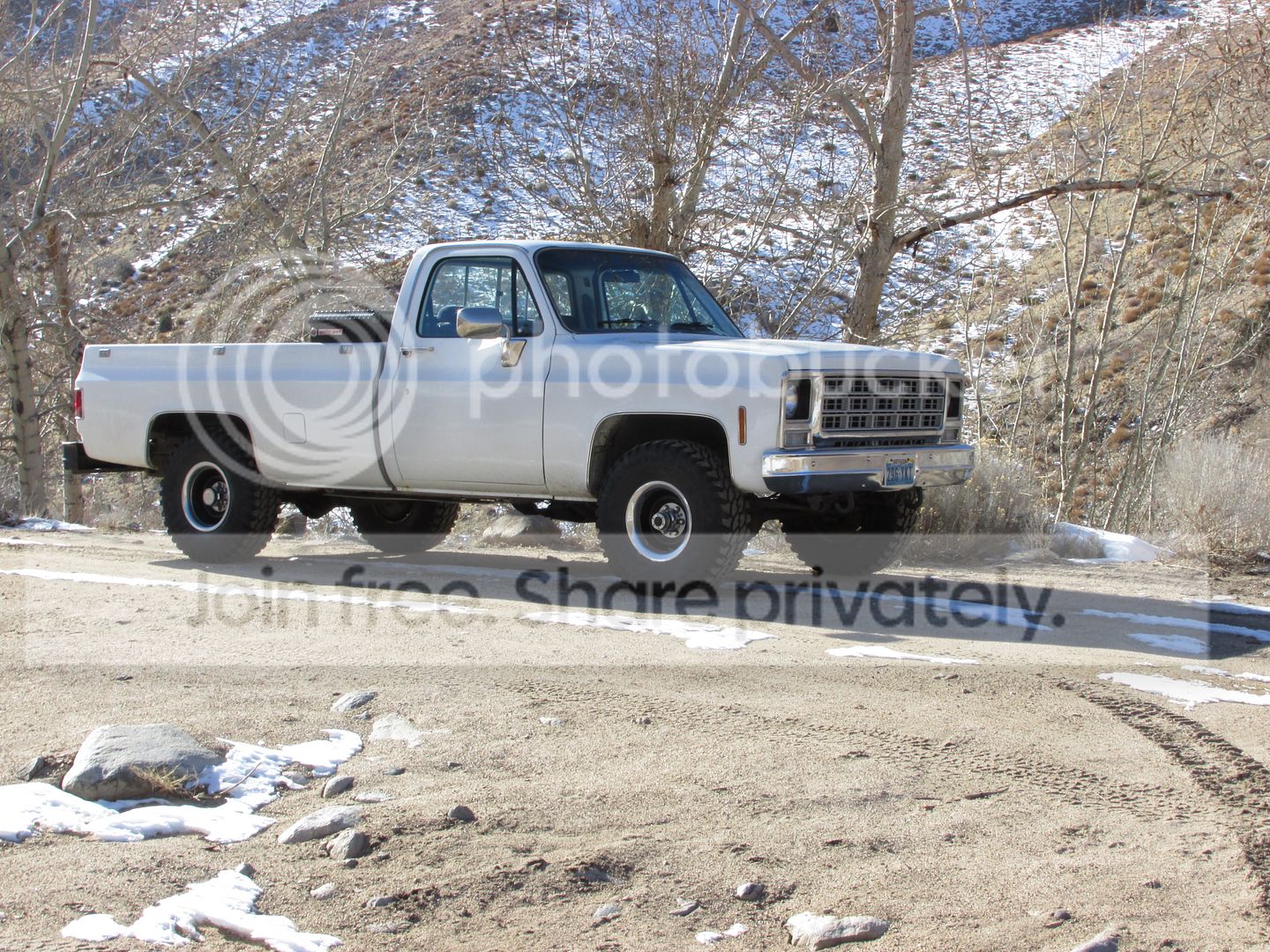

From there I did a few little things and enjoyed it. The tires were pretty dry rotted and during a cold snap I lost two in one day. I scored a set of brand new Pro Comp Extreme M/T's (33's) off CL for $500 :waytogo:
I actually only drove it less than 50 miles before I decided to throw a 4 Rough Country lift on. There wasn't a lot of tech involved so I didn't take any pictures of the install. The original idea for truck was to have a classic resto-mod style truck to use a town rig and what not. The direction changes as you will see eventually. The lift had blocks and cheap shocks, and rode like a brick but it kept the tires out of the fenders.
