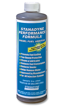

I use the Performance Formula with *EVERY* pump of DF2.
http://www.stanadyne.com/view.php?id=74
It is inexpensive, and it WORKS! Without it, the truck runs like chit. (Thanks to ULSC)

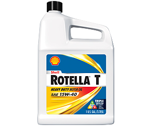

Change your oil ever 3 months, it doesnt use regular oil, get the Rotella-T, formulated for diesels

Ill have to make a trip out to P-West to get the stanadyne but i did buy the Rotella triple protection 15/40W. I am loving the diesel and my neighbor's are hating it. Thanks for all the Information! I feel guilty that I'm doing all this to the blazer and im still waiting for parts on the k-20 while it sits there slanted and broke.
