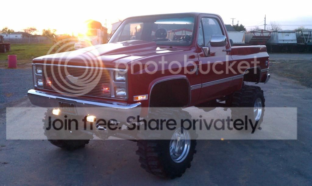

Man, speaking of those years, I came across these 2, this one is $7k, much beefier suspension and the one below it for $6000
At this point, don't look at suspension. Don't even consider it a selling point. A cheap lift is easy to put on and make it look 2x what it's really worth. Don't add lifts to a price tag. Also, look for 8 lug axles. I'd buy a shorter 8 lug axle blazer over a lifted 6 lug, way smarter.

Im glad you mentioned that, here is the description the other red blazer owner gave me for what he has in axles, this worth anything?:
"It's one ton axles out of an 84 Chevrolet k3500 military truck. Has a kingpin style front end. i have quite a bit in the axles gears and lockers. With crossover steering and an upgraded agr steering box."

As long as it's done right, that set up is worth $1500-2000 more, as long as the rest of the truck is in the condition you want.

Oh heck yeah, if it's all correct, there is some good value, and some good components there. If you want to go 4wheeling of course. If you don't, there is really no need for a front D60. It's just like hauling around dead weight for no reason really.
And you are talking about the one with the cowl hood right? I like that one, sweet wheels/tires. They look like they are Weld wheels.
Yep, thats it, only thing Id change on that blazer is make it white and red, not black and red.
whats under the hood, I see a big ass tach?
The axles and crossover definitely add some value. The rear should have a Detroit if it's a military axle, I would ask what kind of locker it has up front.

Here is the engine bay of the red one with the beefed up axles and what not.

I would pass on the truck then. You don't need to haul around the extra ~500lbs in axles and you don't need the crossover steering. Save the money for when things start to fail on you, instead of extra capabilities you don't need.
That is, as long as you stick to your usage description.
A stock blazer would suffice. Small lift and slightly larger tires would be cool. Keep it realistic, less wear on things, better MPG, cheaper size tires, etc.
If you think you will get more aggressive in a short time, buying something already upgraded can help, as long as it's done right.

$7000
Do you think you can find a similarly looking blazer, in the same shape, but without the lift/axles/ steering for around $4-5k? Then you'll have the extra $2-3k to keep the important things running.
