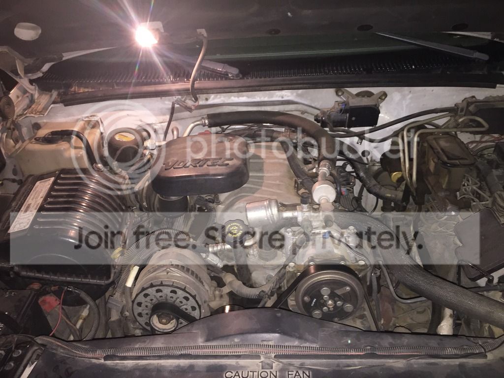

The prize.

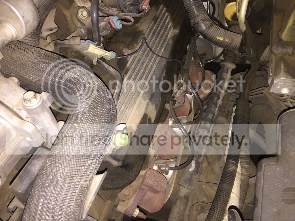

Valve cover leak
I bought vehicle, drove it to a bar, had a few drinks and then it wouldn't start. The parts store closed 10 min prior to me walking out. I had to leave her 70 miles from home. I return to her a week later..After buying a new starter and replacing it, I discovered how corroded battery cables can make a starter engage, but not spin (Scratched our heads for a good hour figuring this one out.) She takes a second to build up fuel pressure, so likely need to replace the fuel pressure regulator. She smells of gasoline, but i couldn't identify any leaks.

The swap is relatively straightforward and there's a lot of knowledge out there.
The engine will mount up just fine, and dropping in a Vortec EFI pump to feed the engine isn't a major ordeal. The main thing is upgrading your fuel system to handle high pressure injection.
One area where you'll have to make a decision is the transmission. The 700R4 will require some fabrication to make the TV cable work with the Vortec intake setup (unless you ditch EFI and go carb or convert to TBI), and unless it's built it's probably not going to have a long life behind a big block. I'm assuming that the donor burb comes with a 4L80E. It would be my choice to just use the transmission that came with the big block. It's a larger transmission, so making it fit may mean some crossmember/driveshaft work and an adaptor to hook up the NP208, but in the long run I think it would pay off.
As far as general swap advice, make sure you devote some time to a good bay cleaning. Replace the motor mounts. It's easier with the engine out and they're probably old and not ready for big block torque. I'd at least inspect rear main and oil pan seals, as if needed they are easier to service with the engine out. If it's in the budget, replace the crank/cam sensors that can fail over time and cause issues.
