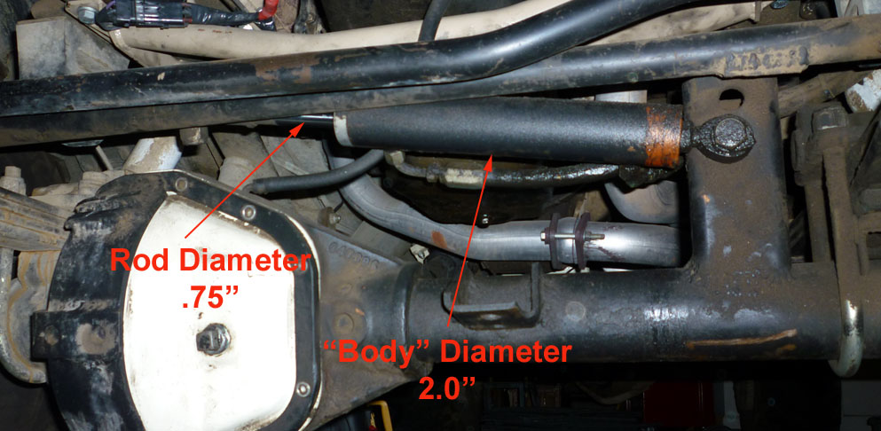

Hmmmm. I think the 2" might be a little big. Is there a way to tell definitively what size ram is on the truck? There are no marking, but the shaft is .75" diameter, and the outer casing is 2" exactly. I am guessing that I actually have a 1.75" in there now?

Are you sure the shaft size is .75"? IIRC the OD of a 1.5" ram is 2" which would make the housing .250" wall and the shaft size is .625". I have driven a truck with 1.75" ram and NO THANKS, but each his own.

There is absolutely no way to tell what size ram you have now based on its outside diameter or shaft size. If you knew the wall thickness of the ram and the OD, you'd know.

Here's a picture:
Excuse the fact that it is dirty. I'll clean that up shortly as well, as I know hydraulics and dirt don't get along.

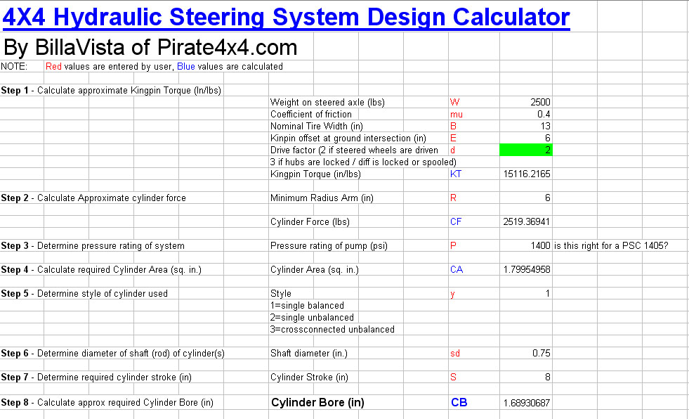

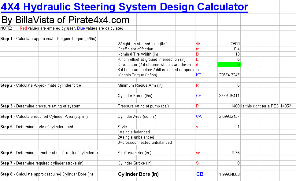

Also, take a look at the two calculations I did using BillaVista's Excel sheet. Depending on what I put in the green cell (I think the others are close to accurate... assuming 1400psi from my pump...) it changes from a 1.79 to a 1.99....
I am thinking I probably have a 1.75" ram, and that is a better choice than a 2.0 for a truck that is driven on the street.
Again, the rod size and OD of the body of the ram tell us nothing.
You could have a ram with a 4" body and a 1/4" shaft but the actual size of the piston (the measurement that's normally quoted as the "size" of the ram) might only be 1/2". Obviously, that example is drastically exaggerated but nobody can tell you what size the piston is because we have no idea how thick the tubing is. Without a part number or taking it apart, there is really no way to know.
You could disconnect one of the lines and put it in a jar, then (with your hand) push the ram in x inches and then do some volume calculations to determine how much fluid is moved. You'd have to be very careful to avoid air in the system, which would probably be a PITA but it will work in theory.
IMO, you have a 1.5" ram. .250" wall is very common for a ram of this size which would correlate to a 2" OD.
So, I would either buy a new 1.5" ram or simply replace the seals in the one you currently have.

BTW, I think you're making too many assumptions in your spreadsheet calcs to consider them reliable (especially since you're working backwards)
I agree, and was only using it as ballpark anyhow. As you say, without measuring each thing exactly, it means nothing. Air pressure in the tires, terrain, heck, even temperature would affect things. The coefficient of friciton is a LOT different in mud/dirt/pavement.
I was just tyring to ballpark things.
Sure, just making sure you don't jump to false conclusions ;)
