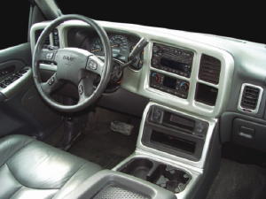

The way this console comes up to the dash is what I'm planning for mine:
Except it'll hit dead center, right where the ashtray is. That way the area on the right side of the instrument cluster will be free for gauges (I'm a gauge whore).
I have the delux Tuffy center consol that I will have to try and incorperate into my cage along withan Art Carr shifter. It will be similar to that actually, but out of tubing.
