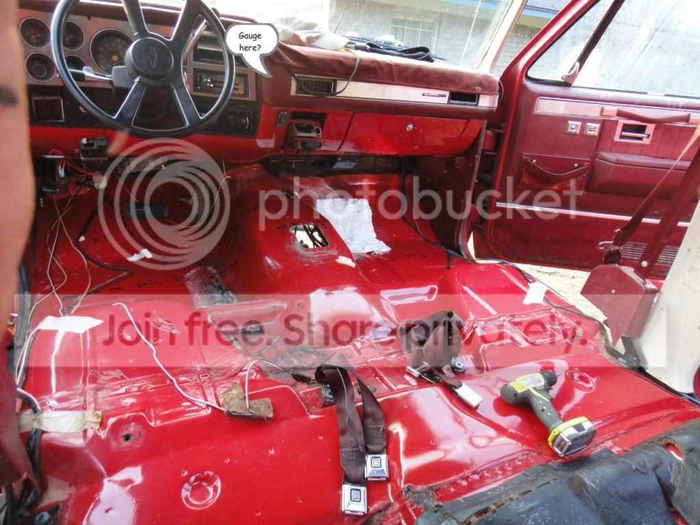

Those of you that have them mounted somewhere other than the stock gauge bezel/area, where and how did you mount them? As always, pictures, pictures, pictures!
I have a pretty bad ass Autometer digital trans temp gauge that I need to mount somewhere, and I refuse to mount it in one of those ugly, tacky things hanging off the bottom of the dash or sticking up off the top of the dash pad. Does anyone make a windshield pillar gauge pod for our trucks, similar to the ones you can get for the newer trucks? It's pretty small, 2 1/16", so mounting it in the dash somewhere is an option too.
One idea I had was just to the left of the center dash vent, above and to the left of the tank selector switch, in the face of the dash pad.

whynot use the empty gauge hole you got in lower left of the 4 gauge factory spot. ?
easy to cut out and mount in there.

Seems like a no brainer, especially considering the size. Relocate your brake light with something different, like a bulb. Could keep it factory looking easy.
I have mounted them to a piece of plastic in place of the ashtray:
It's possible to put one in the dash, but that's a ton more work. (See attached, not my truck, some random pic from somebody here.) You can also do under the dash in onesies, pairs or threes as pictured here.
Thanks for the pictures. That bottom one is great. The ashtray idea was a good one, but I use my ashtray, so that was a no go.
